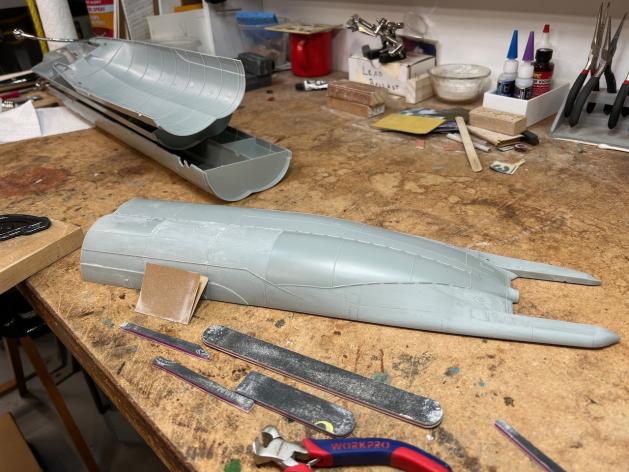

    To start, the hull is in sections. Will be easier to sand the hull, scratch up the surface, while it is not assembled. I cut up an emery board and use that to scratch up the smooth surface around the panel perimeters then use 220 grit paper to finish off the center of each panel. The emery board helps get right up to the weld lines. And those weld line are not smooth, they are rough to appear as real weld lines. Every once in a while snip the emery end off to get a fresh section. Once sanding is done the hull will be washed with soap and water inside and out, and probably washed a few times.
    Click image for larger version  Name:	IMG_8374.jpg Views:	0 Size:	52.1 KB ID:	187322
    Lots of area to cover.

    As it is the hull feels flimsy. This support structure will need to be removed to make way for the sub driver.
      Click image for larger version Name:	IMG_8378.jpg Views:	0 Size:	54.4 KB ID:	187325
        could this have been used as a functional ballast tank for the model?

          Rob, this model was meant to be a static display model. Since the hull is thin, flimsy and flexes easily it was probably added there to give the hull rigidity.
