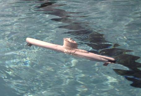

    Now here is how I see it running on the 1:1 version.
Name:	Bronco Type 23_001.jpg
ID:	84590Click image for larger version
Name:	Bronco Type 23_002.jpg

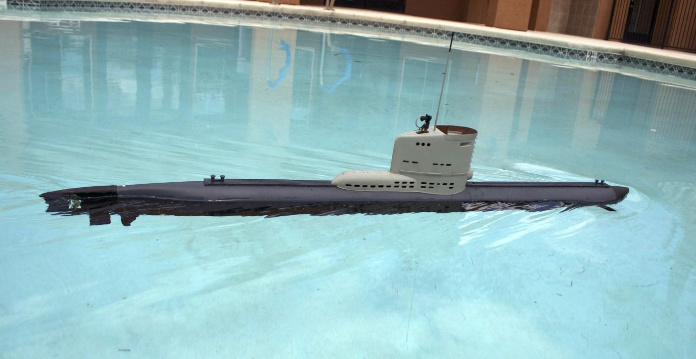

    Do you see the difference? The aft is submerged on the real submarines. Here are more photos.
Name:	Bronco Type 23_003.jpg
ID:	84592Click image for larger version
Name:	Bronco Type 23_004.jpg
Name:	Bronco Type 23_005.jpg
    Even the risen U-2365 was operational with a aft end submerged.

      This type of trim is common with many spindle stern type boats, where the prop is prone to ventilation when close to the surface. They still do it on modern boats, for instance if you look at some pictures of the Astutue class, you'll see it tends to be trimmed with its bum down in the water.
      I've always thought of the XXIII as a 'big' Seehund. The hull shapes are essentially the same, just that the Seehund has a longer and squatter conning tower. these tended to be trimmed in the same way when you look at pictures of them in their element.
      The stern down trim is achieved by flooding the rear tank a little or perhaps stowage of ballast. In a model with a single tank, you can get the same effect by either biasing the tank a little towards the front, or adding ballast shifting. The former method has the snag that with changing water density so will your longitudinal trim alter.
      The latter is most easily achieved by mounting the battery on a cradle and moving it back and forth with a servo. There are details on this in Norberts book. Lipo batteries don't offer the same mass as other types, so you might have to add lead to create a decent amount of weight, generally 10-20% of the boats overall displacement is adequate to get good control of the boats longitudinal trim.
      Not many sub modellers bother with this detail, but it's not a huge effort to install if you have a spare channel and all I can say is try it, you'll like it.

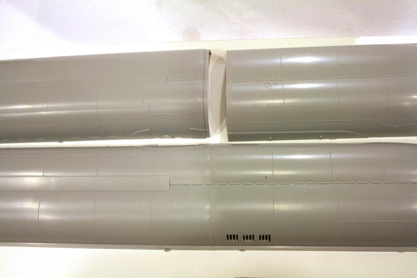

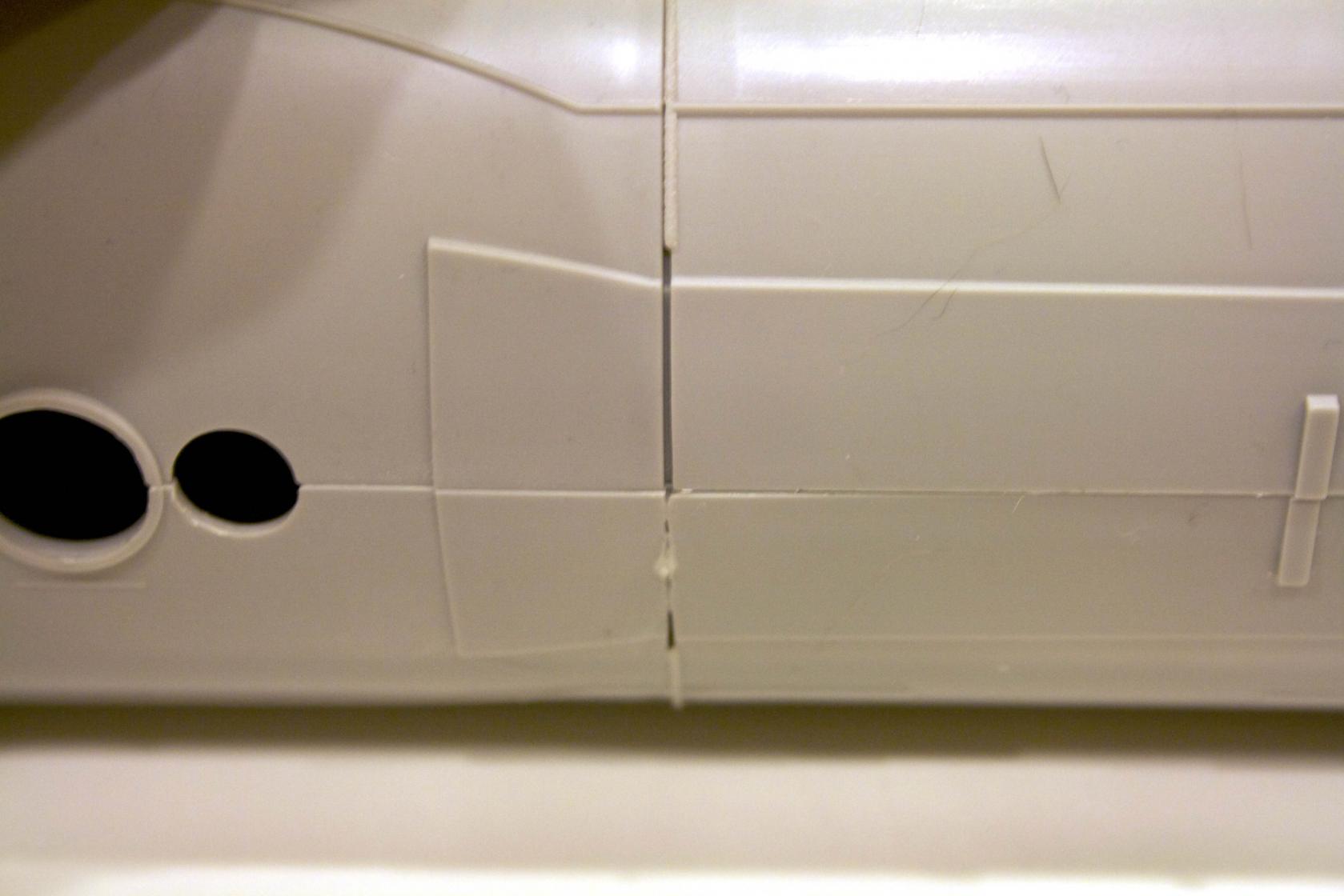

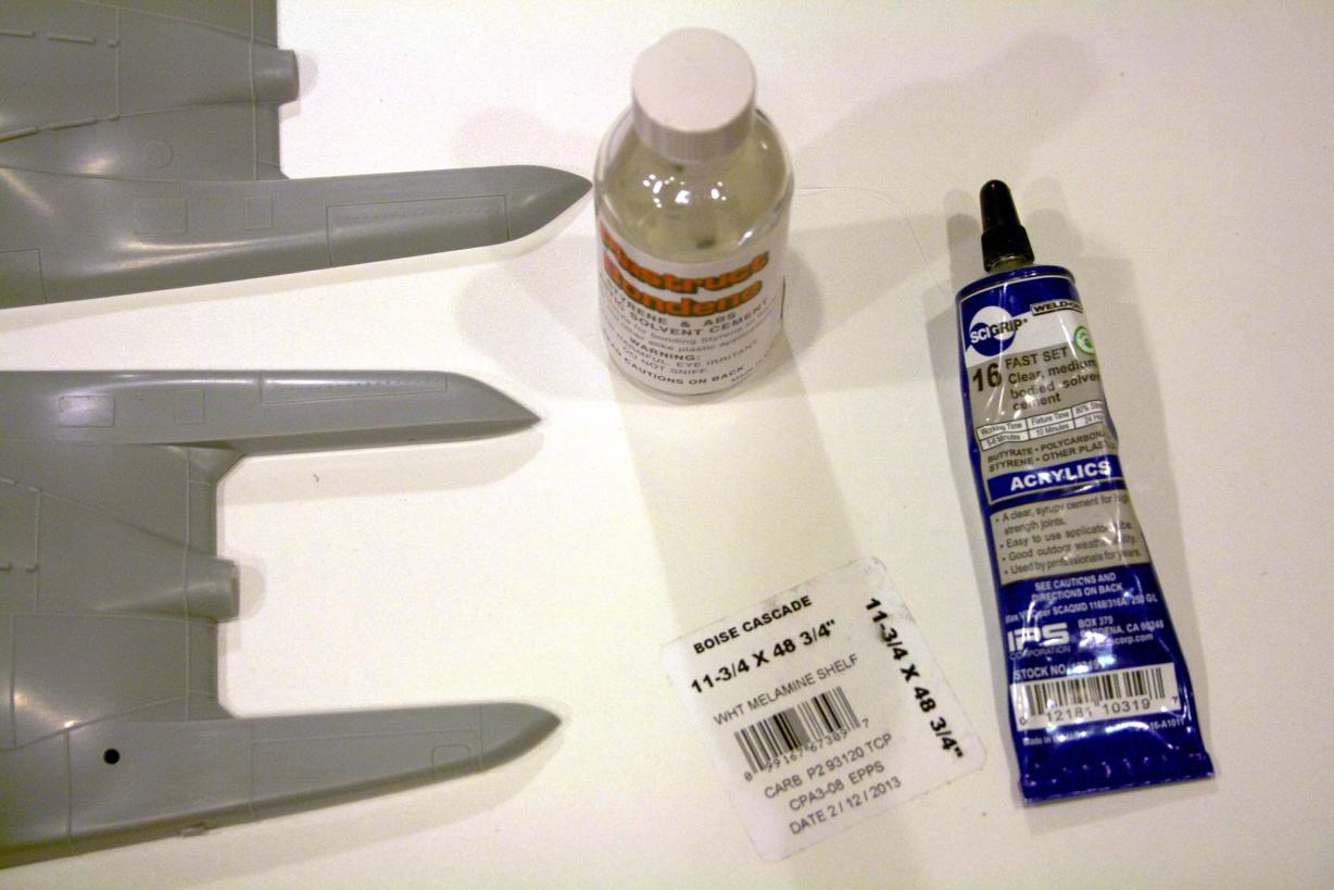

                Went out and bought a melamine board and began to glue the halves together.
Name:	Bronco Type 23_009.jpg
                The fit was good, but on one set of halves it fit with a wobble in it. Meaning either the bow would go slightly high or slightly low.
Name:	Bronco Type 23_010.jpg
                So I placed the pieces on top of the already glued half and the aft end would not come together. There are some injection tabs left in that needed to be snapped off.
Name:	Bronco Type 23_011.jpg
ID:	84601Click image for larger version
Name:	Bronco Type 23_012.jpg
                With the tabs off, I tacked the pieces together and then set the half down on the board for better application of cohesive glue. After it set up, did a test fit and the halves fit pretty good.
Name:	Bronco Type 23_013.jpg

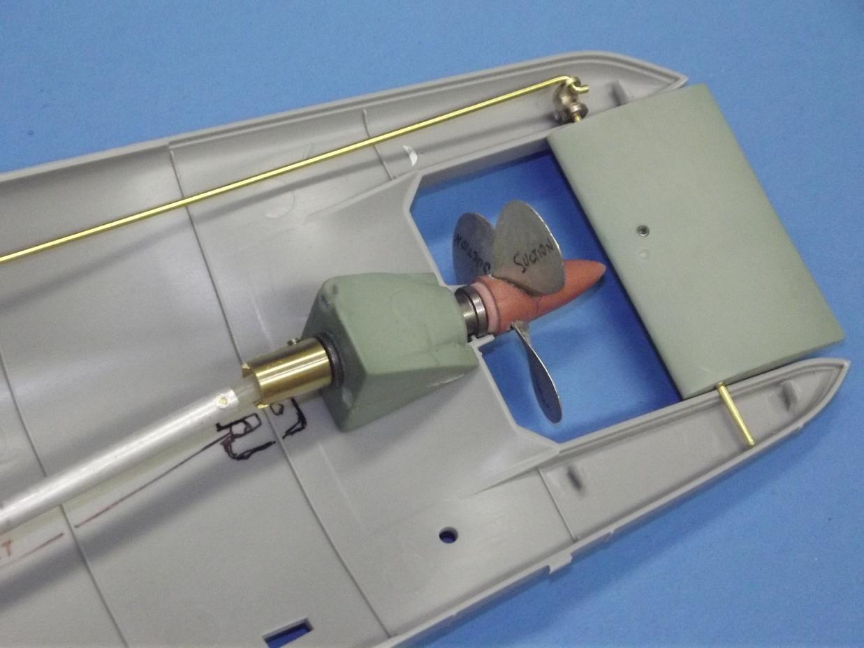

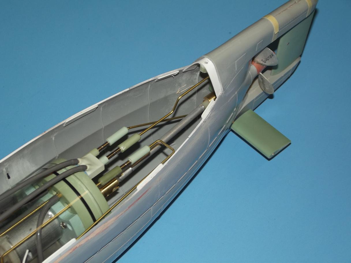

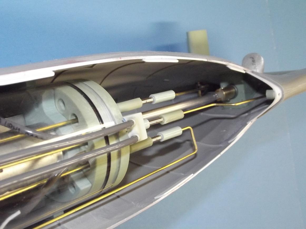

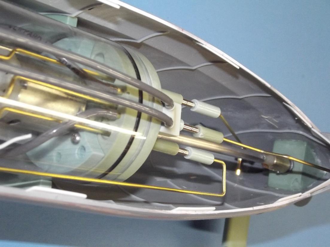

                Now the decision is how to fit the rudder mechanics and when. Place it in now and seal the halves or put it in later and either open the hatch to allow access or I might be able to feed the rod through the bottom.
                  • 13996

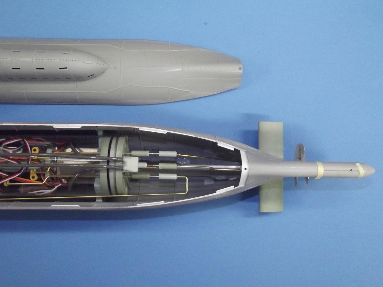

                  You can fish the rudder pushrod and bell-crank in there with the unit assembled, so go ahead, glue away, Tom

                    • 3766
                    O.K., If I see the photos correctly, there is a hole drilled in the top that you drop the wire (rudder shaft) down through. Do I still need to thin the walls down in the upper rudder support?
                      • 13996
                      Yes on both counts. Grind a 1/8" hole into the top of the upper rudder support -- in alignment with the rudder operating shaft -- and the bottom of the lower rudder support. Drill holes to pass the 1/16" rudder operating shaft into the bottom of the upper rudder support and the top of the lower rudder support.
                      With the hull glued together, to install the rudder:
                      1. pass the rudder operating shaft up through the bottom of the lower rudder support -- place the rudder into position -- and push the operating shaft up into the rudder, through the bottom hole in the upper rudder support and hold it there by tightening the rudder operating shaft set-screw (on the starboard side of the rudder)
                      2. Put a Z-bend into the end of a 12" length of 1/16" diameter brass rod. This will be your rudder pushrod. Make up the Z-bend to the bell crank and slather on some CA to make the two a rigid assembly (don't sweat it, that union will break later). Push the bell crank, using the pushrod as a handle, into the tight confines of the upper rudder support. While doing this look down through the 1/8" hole in the top of the upper rudder support and finagle things till the bore of the rudder pushrod is in alignment with the top of the rudder operating shaft. Push the rudder operating shaft upward, through the bore of the rudder bell-crank.
                      3. tighten the set screw within the rudder bell-crank to make it fast to the rudder operating shaft.
                      4. tighten the set-screw in the side of the rudder to make the rudder fast to its operating shaft.
                      5. sing my praises, sprinkle rose petals at my feet, and deliver 20 Filipino virgins (female types, please) to my bed chambers, immediately!

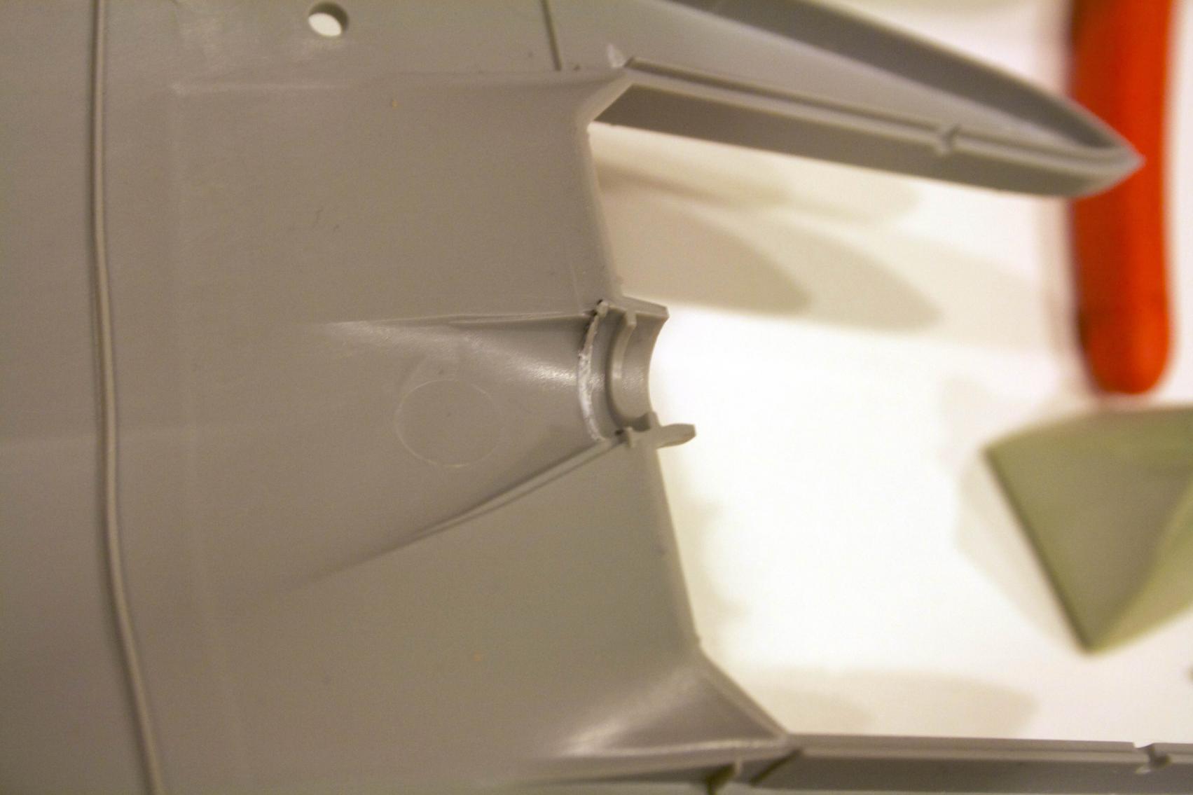

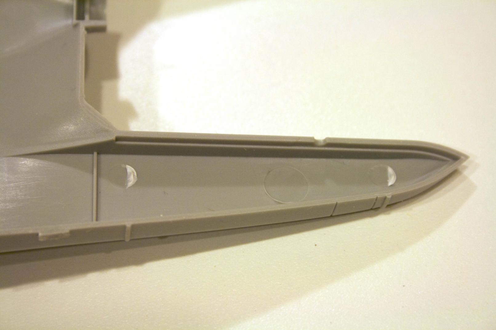

                        There are some things that need to be done prior to sealing up the hull. One is the area the prop bearing will go. There is a thin wall there that was easy to just cut out.
Name:	Bronco Type 23_014.jpg
ID:	84632Click image for larger version
Name:	Bronco Type 23_015.jpg

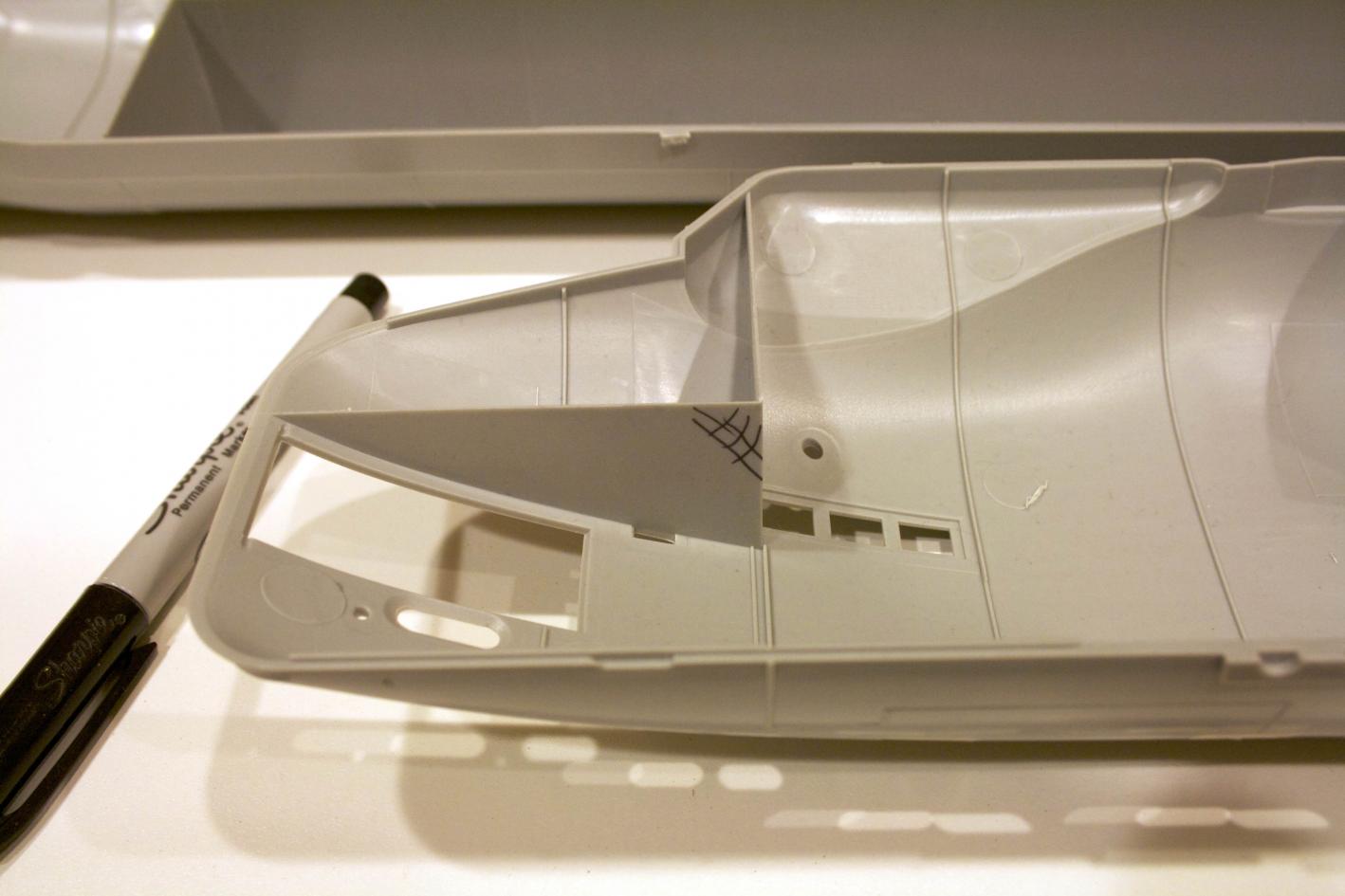

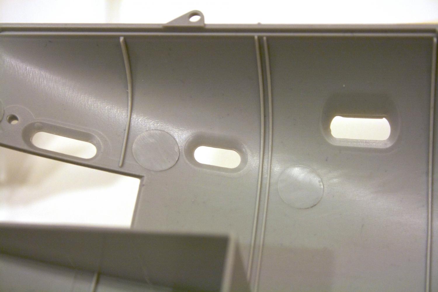

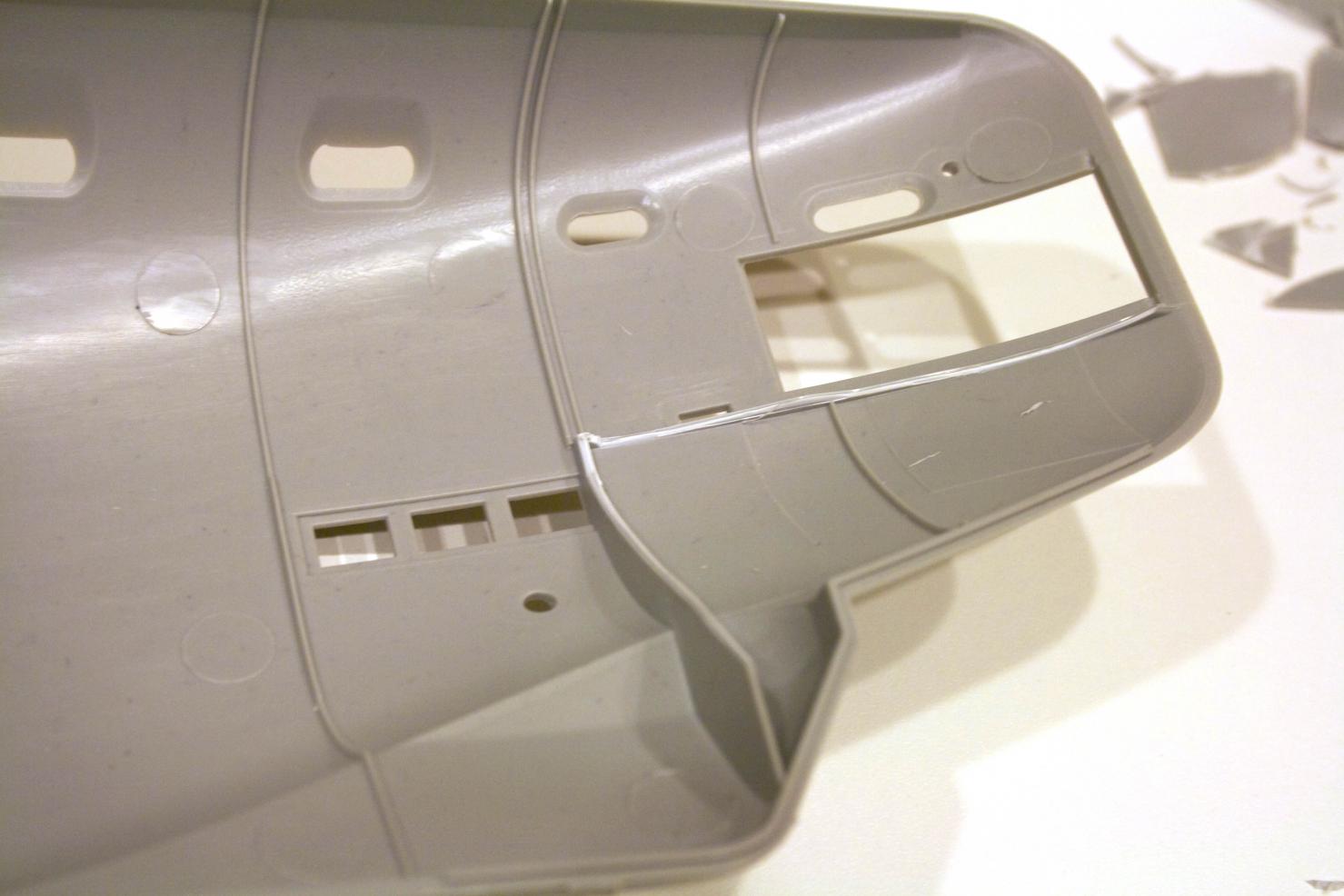

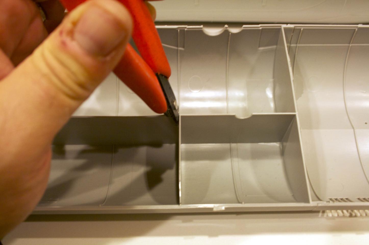

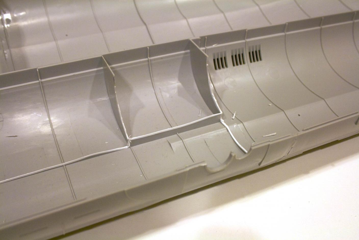

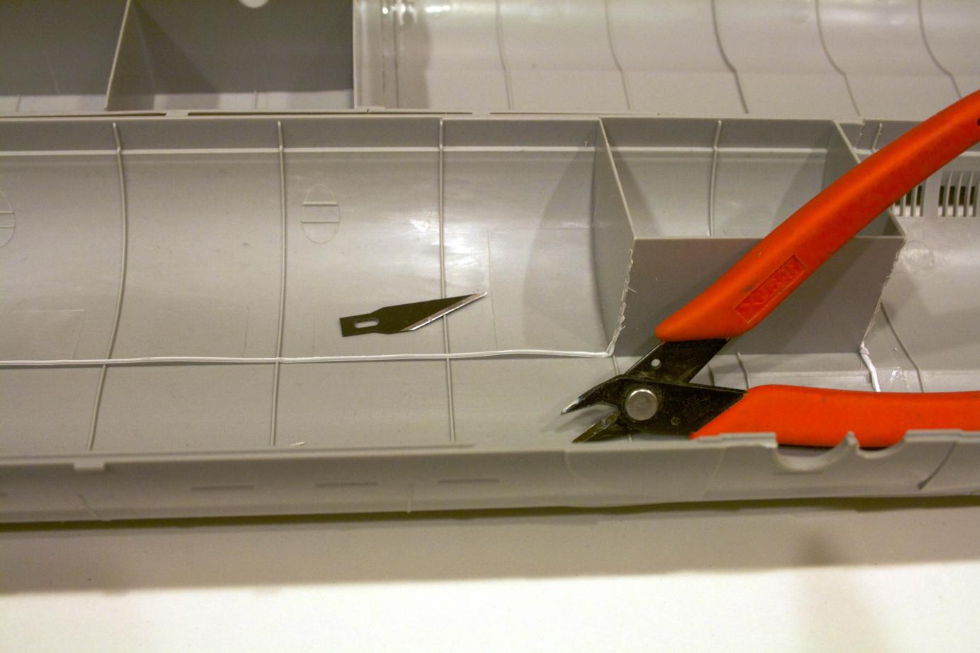

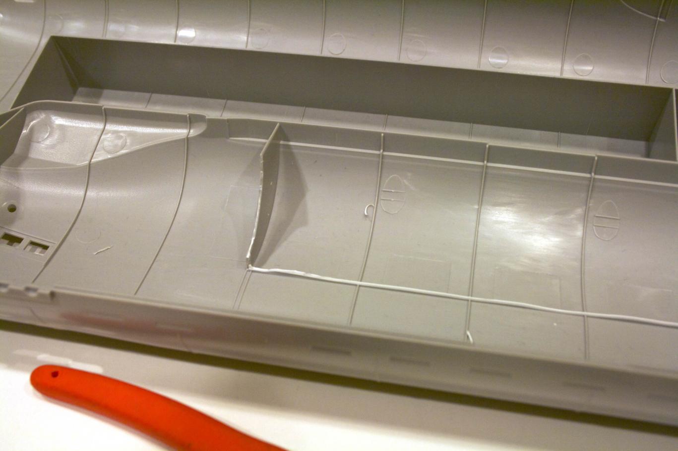

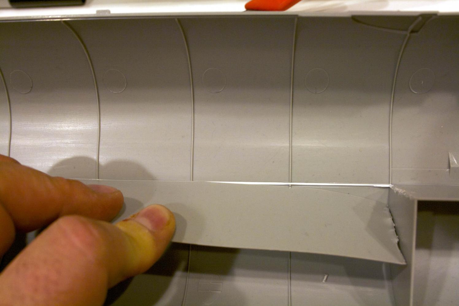

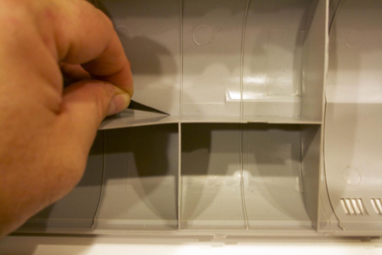

                        There are some walls on each side of the hulls that are support structure or maybe has another use, I probably should read the instructions. Anyway, to remove the walls, I used a x-acto blade to score the base of the dividers and the curved walls. Then snipped down to the base.
Name:	Bronco Type 23_016.jpg
ID:	84634Click image for larger version
Name:	Bronco Type 23_017.jpg
                        Once the wall is separated on each side, then bend the wall and it will split on the area that you scored with the blade.
Name:	Bronco Type 23_018.jpg
ID:	84636Click image for larger version
Name:	Bronco Type 23_019.jpg

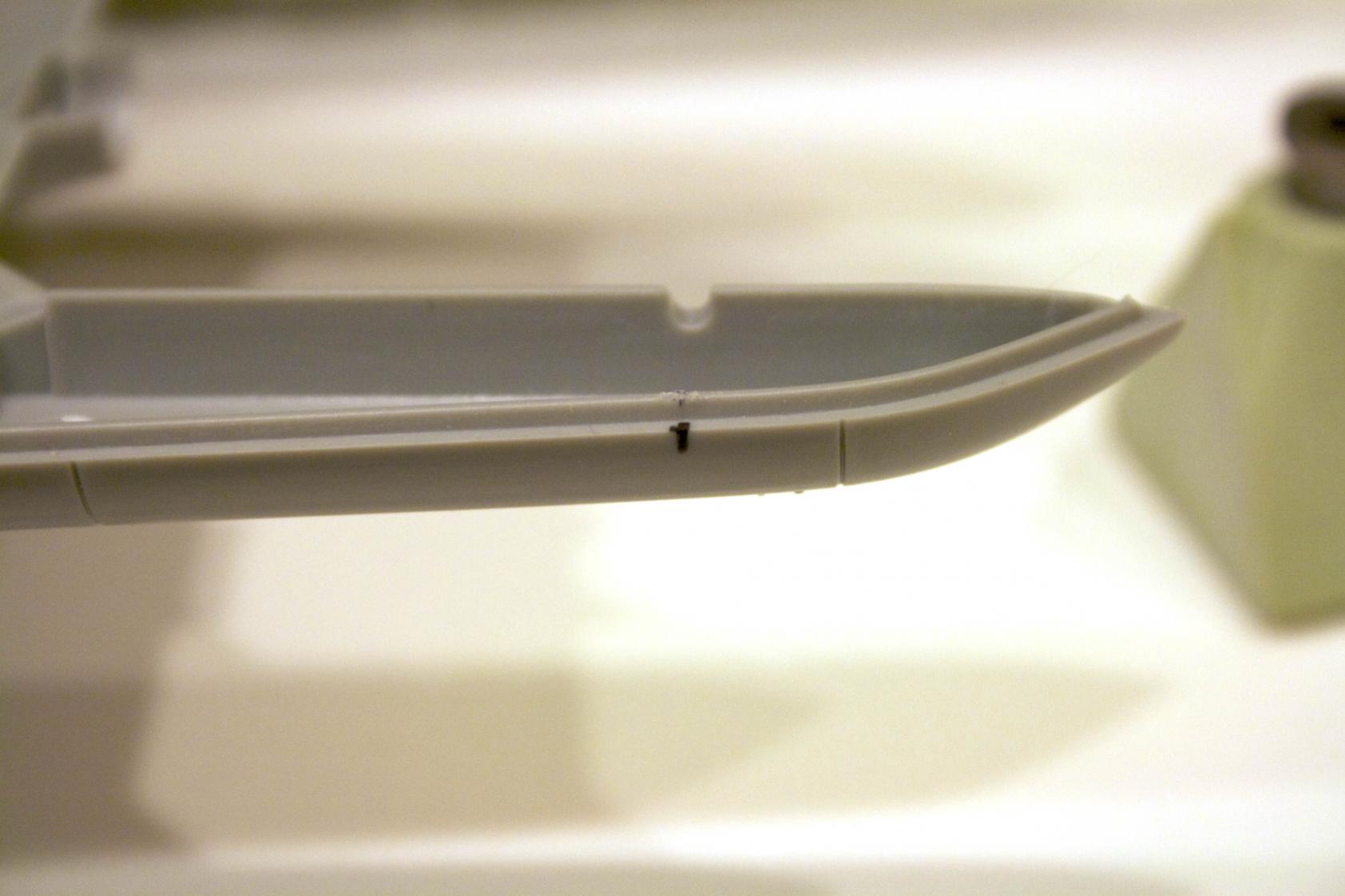

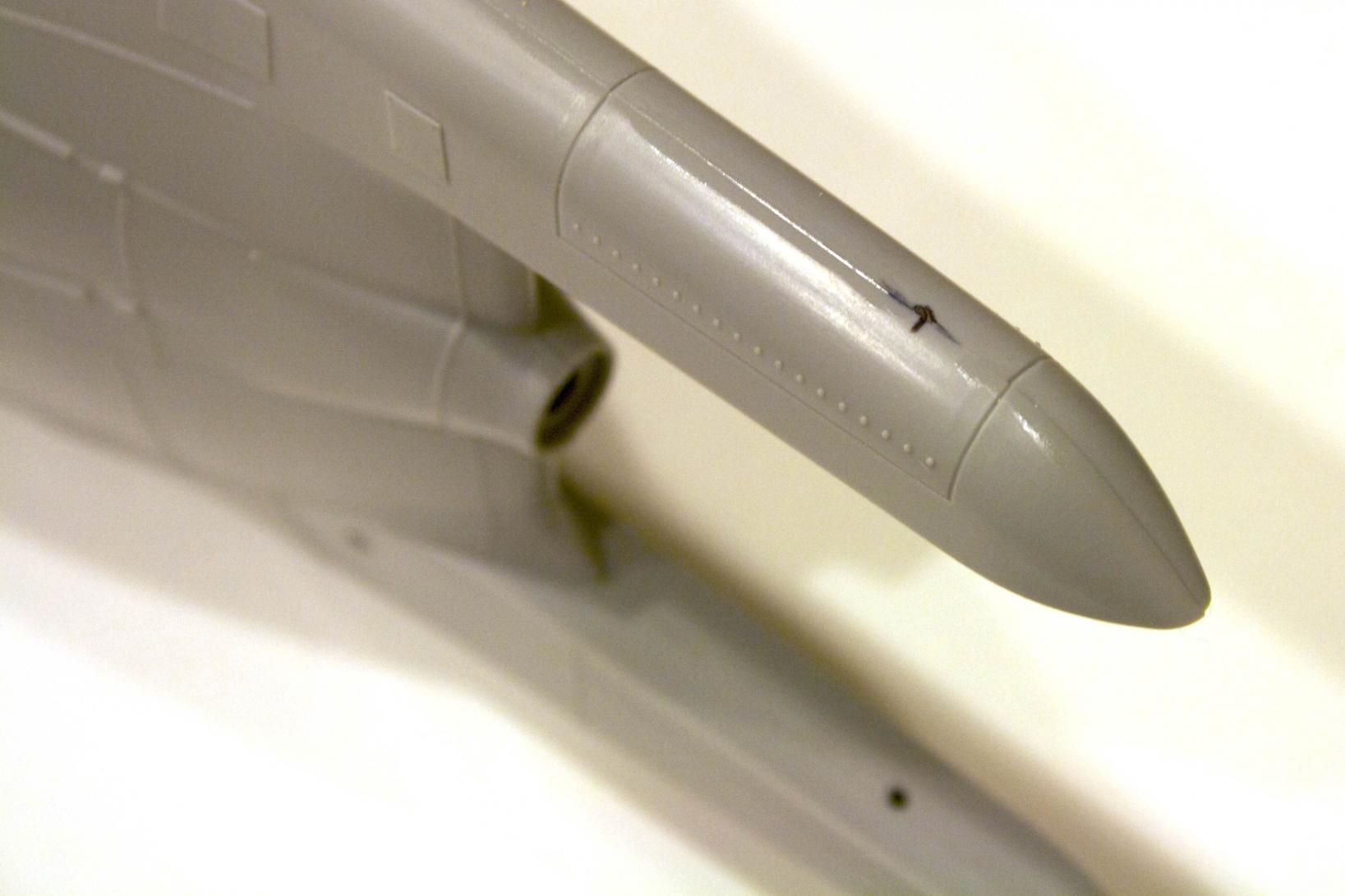

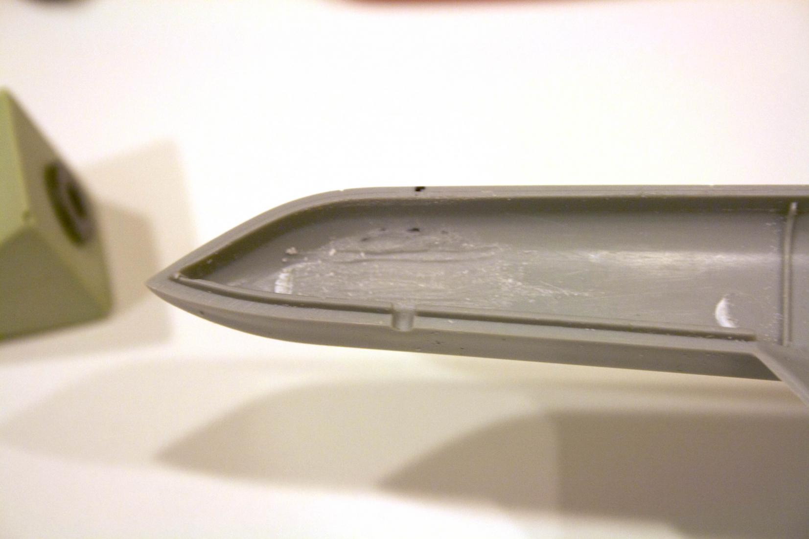

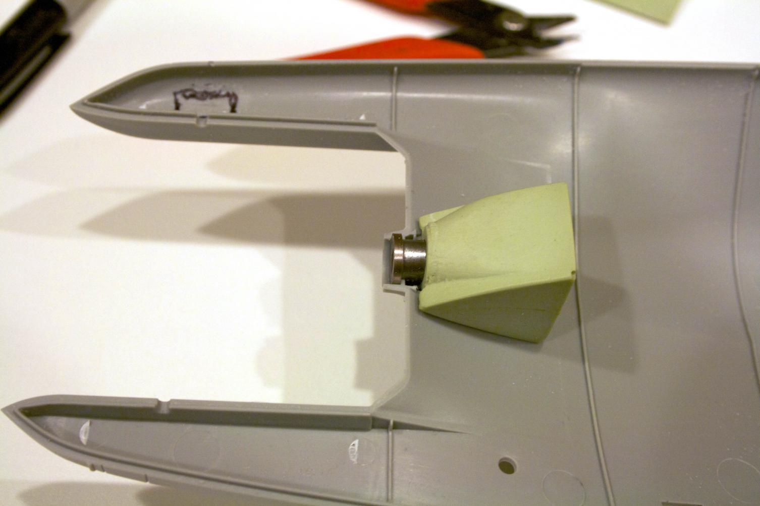

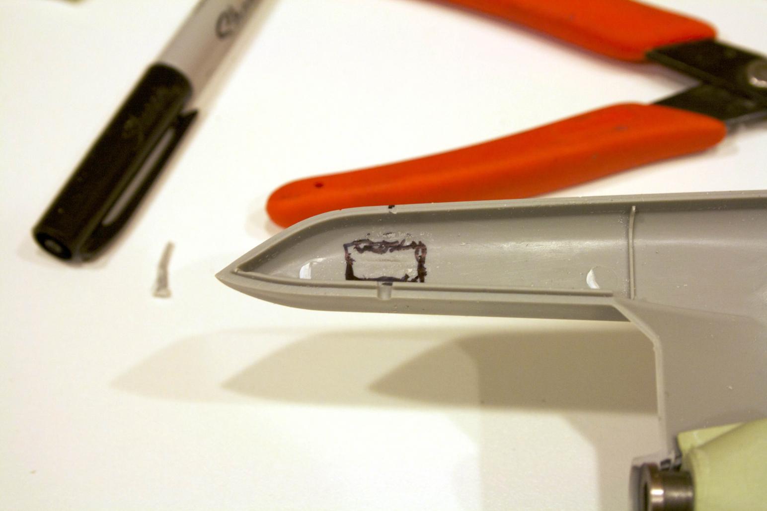

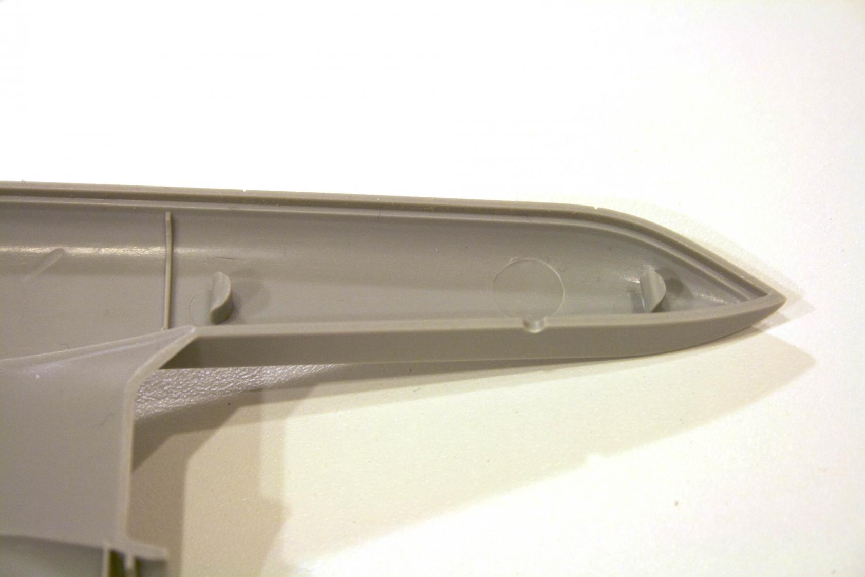

                        The bow had an area that could trap a lot of air, so I cut out most of it.
Name:	Bronco Type 23_022.jpg

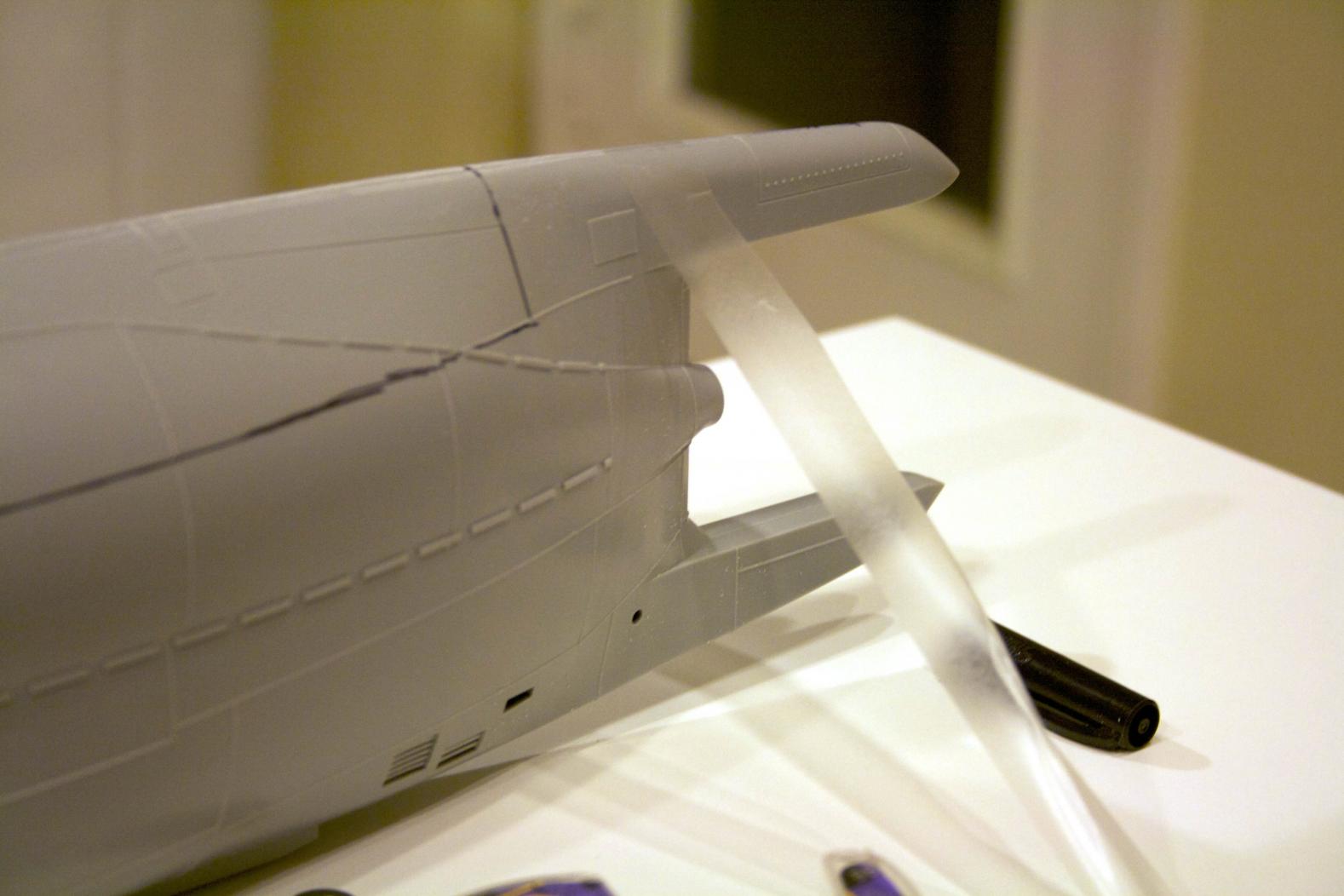

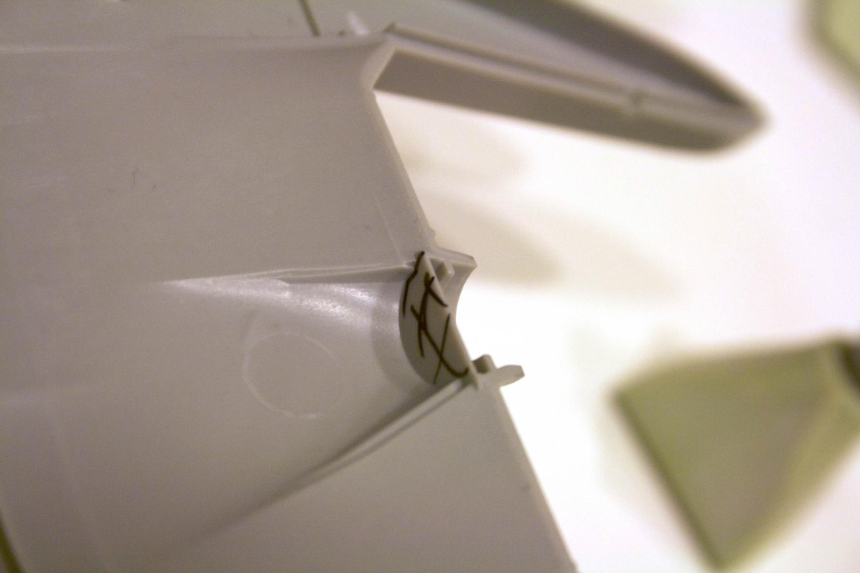

                        Morked on the upper rudder support where I will need to drill a hole.

                        Also laid the rudder assembly into the notches and marked the range of reach the horn has.

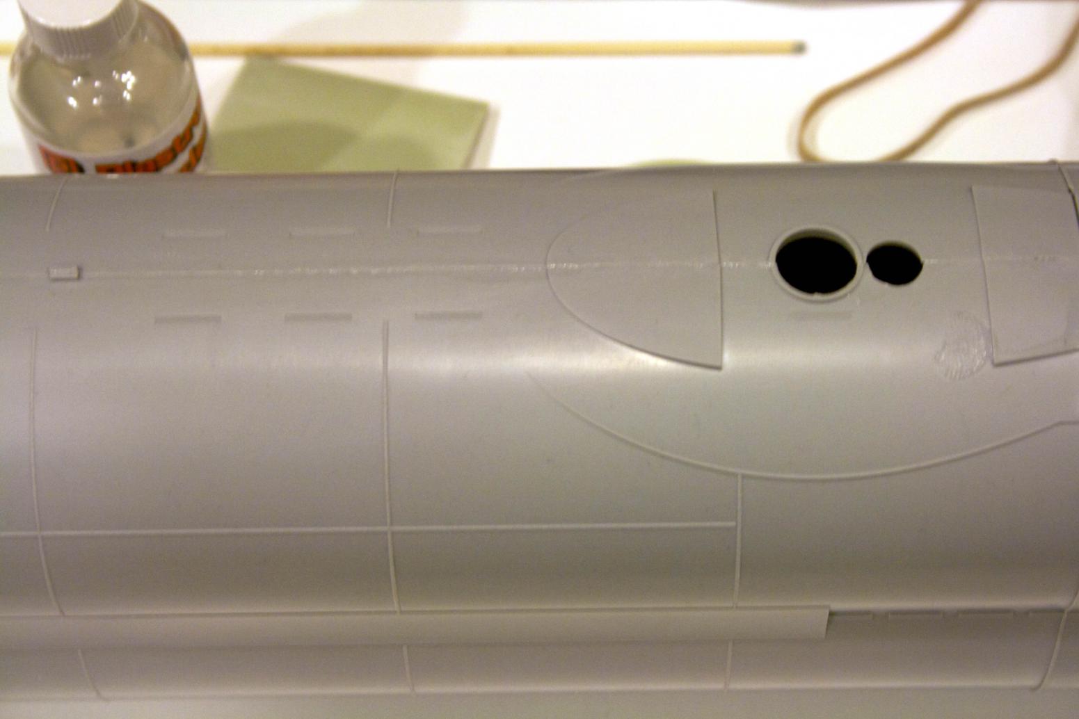

                        Using a cohesive glue worked my way around the sub's hull seam. You can also see the mark for drilling out on the upper rudder support.
Name:	Bronco Type 23_029.jpg
                        Fot he most part everything fit together well. Worked my way around the sub in sections. So, now it is sitting to dry overnight.
Name:	Bronco Type 23_030.jpg

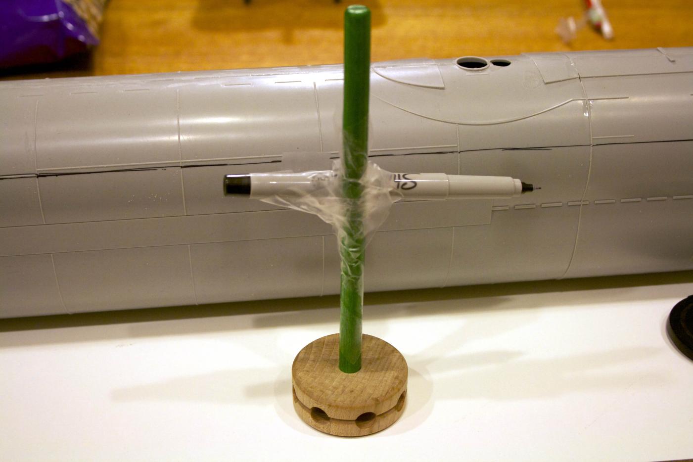

                        I will need to build a holder to mark the hull and another for holding the Dremel to saw the hull open. With Thanksgiving coming up this week, sub work space will be hard to come by, but I will try to do what I can.

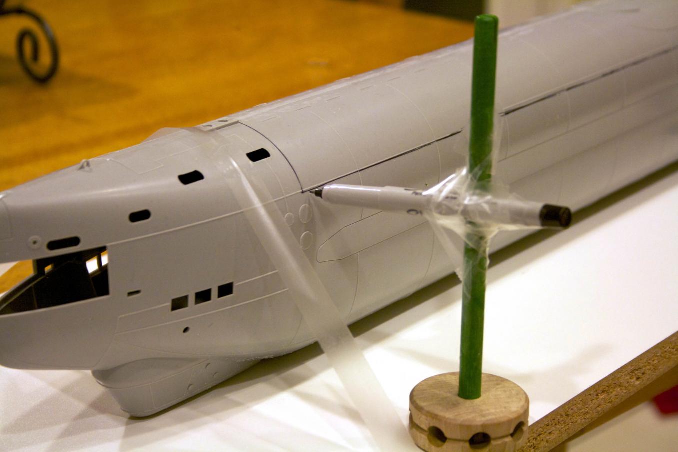

                              Come and listen to a story about a man named Jed
                              A poor mountaineer, barely kept his family fed,
                              Then one day he was shootin at some food,
                              And up through the ground came a bubblin crude.
                              Oil that is, black gold, Texas tea.
                              Well the first thing you know ol Jed's a millionaire....
                              I am not Jed, but you might think that with this contraption.
Name:	Bronco Type 23_031.jpg
                              It worked for the most part.
Name:	Bronco Type 23_032.jpg
                              My hold down technique leaves a lot to be desired. Surprisingly it held the sub pretty good for getting the cut line laid out.
Name:	Bronco Type 23_033.jpg

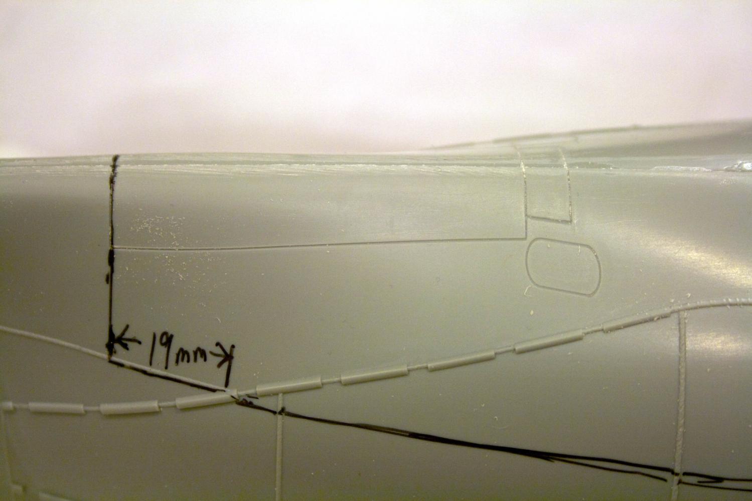

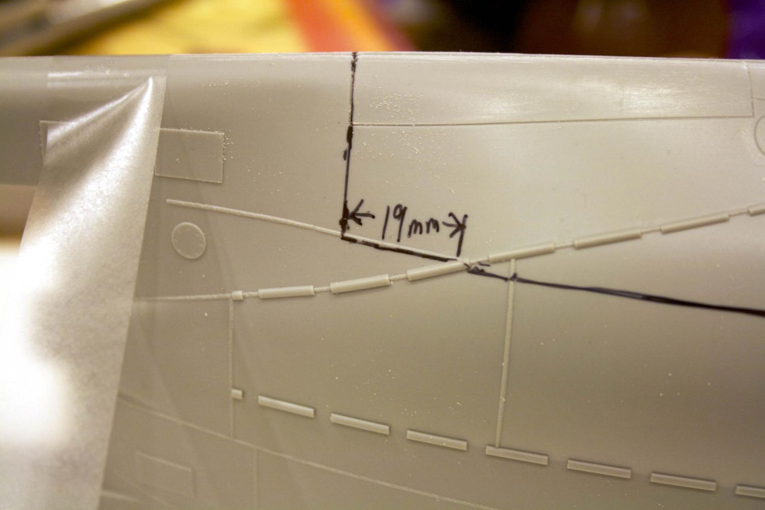

                              The bow vertical cut is just behind the rectangle square on the bow and the aft vertical cut is along a scribe line.
Name:	Bronco Type 23_034.jpg
ID:	84713Click image for larger version
Name:	Bronco Type 23_035.jpg
