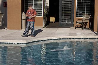

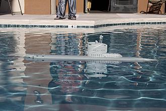

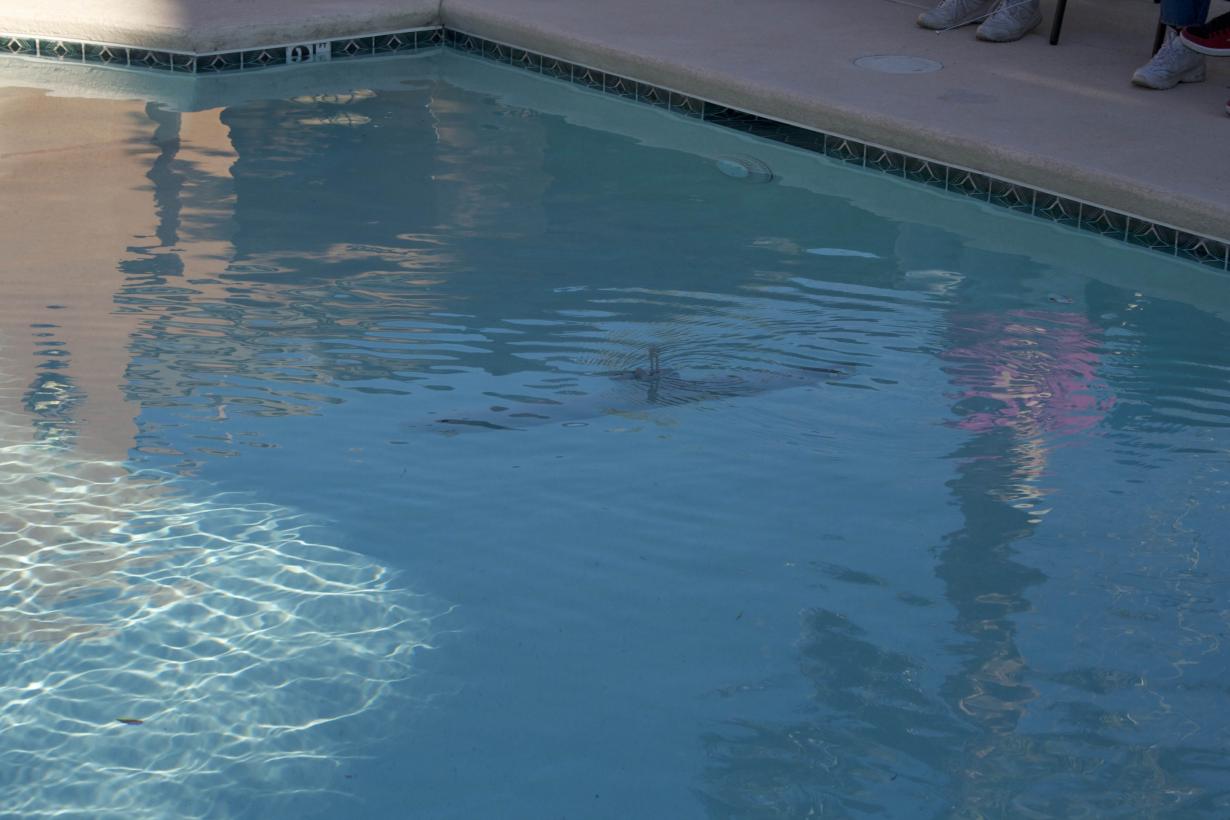

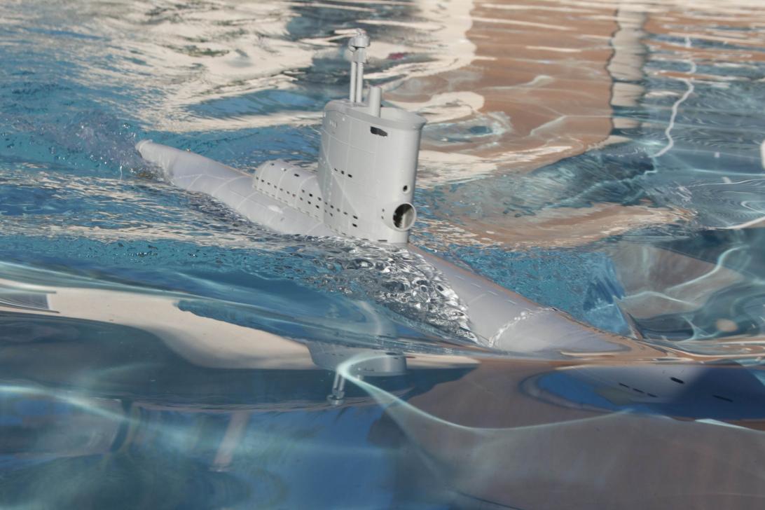

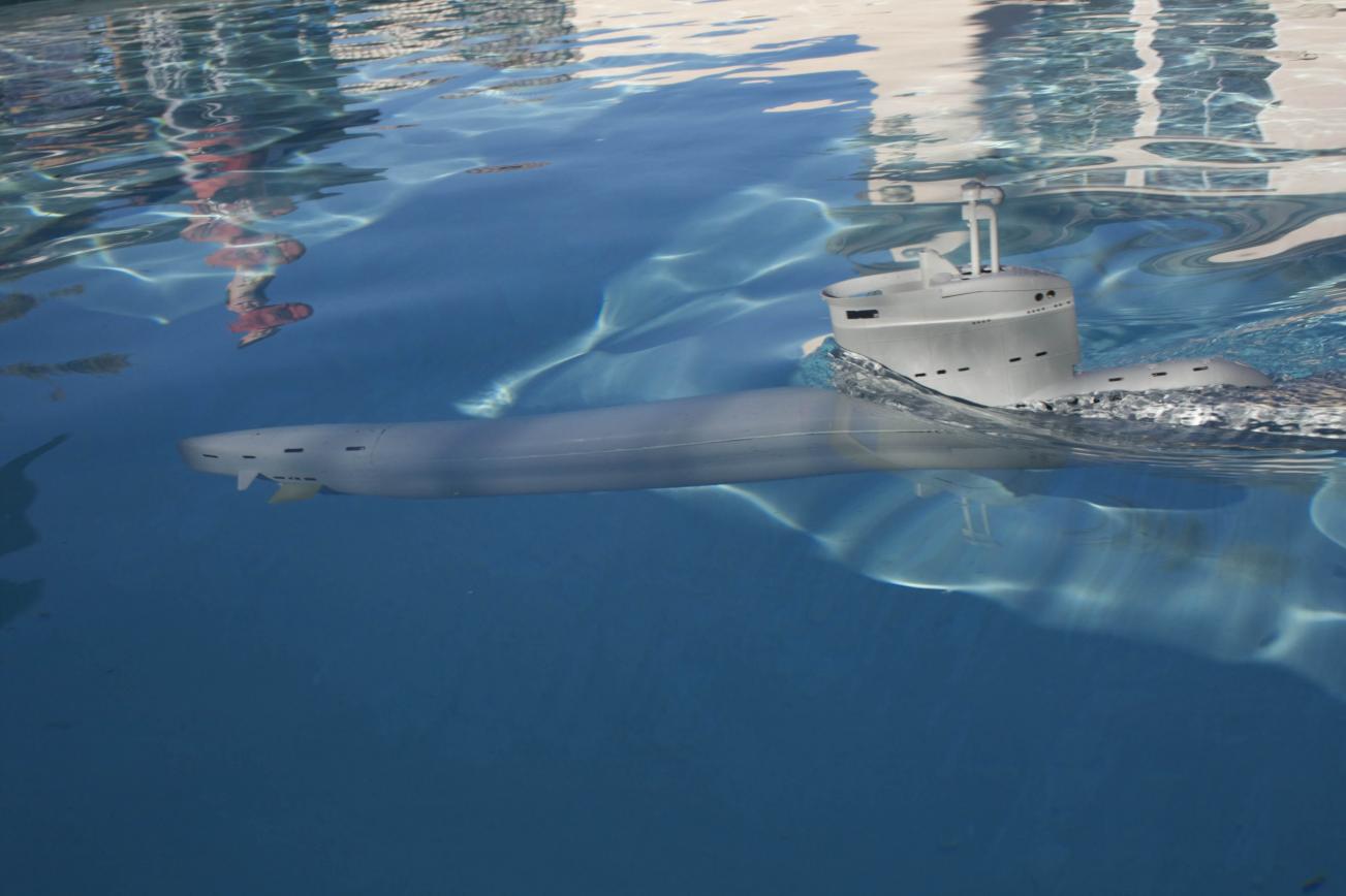

                        Here are a few photos from yesterday.
                        Sam is driving while I snap a few photos.
Name:	Bronco Type 23_209.jpg
                        Begin a dive.
Name:	Bronco Type 23_210.jpg
                        Cruising at periscope depth.
Name:	Bronco Type 23_211.jpg
                        A fast passing. I had not set end points on the speed. This sub takes off even on 7v.
Name:	Bronco Type 23_212.jpg
                        Sam taking control.
