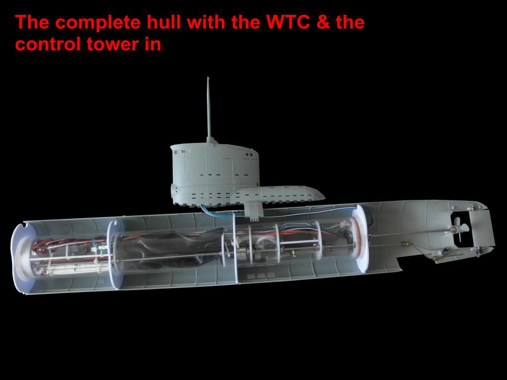

            Some of the goals and equipment for the U-2326
            Goals
            The first goal is to have it in the water in the spring of 2019, here in Ga.
            The U-2326 will be mine “learn how to sail boat”. Not a lot of scale details. My next build or one after the next build, will be a load with scale build at 1/48 scale U-505. 65 inches long.
            (Frames being made as we write)
            This must be a fun build, and a learning build, for the U-505.
            And a 3d printer model the Nautilus, also around 65 inches, files being worked on as we write.
            One more goal, how to paint a U-boat, and to add a camera

                    I got my Bronco kit from Hunter up in NY, and what a great bye it was. I got the 1/35 fit kit with it , and it is great
                    Unable to upload photo of the paper work, will have to work on that . But this is the name on it
                    1/35 Bronco Type XXIII Fitting Kit Product Code T23FK.
                    It seems that I can not up load any of the photos that I took with my cell will play with that later today.
                    But I removed the walls inside the hulls much like Tom did in his 2013 build
                    Bill

                        fix what?
                          A WTC stands for Water Tight Cylinder or Container. A SD stands for Sub-Driver which is registered just for David Merriman’’’’s WTC. All SDs are WTCs, but not all WTCs are SDs (that almost sounds like fortune cookie wisdom huh?)
