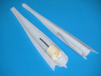

        Demonstrating this: the picture below shows the movie SEAVIEW SD and fittings kit. This fittings kit has no provision to make the bow planes practical. On the other hand, the movie version fittings kit contained conversion parts to make the bow planes practical. (you can see what an ugly arrangement practical bow planes were below, and the two pictures that conclude this article).
        Practical bow planes on this submarine look terrible and were found to be of limited utility in the water. As these control surfaces were so tightly nested into the tips of the SEAVIEW's strakes they become subject to turbulence that blanketed them from rational water flow, reducing those control surfaces effectiveness. And once they deflect in operation... THEY LOOK AWFUL!

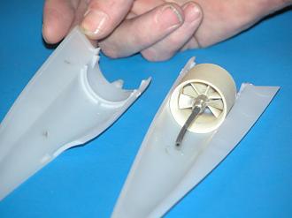

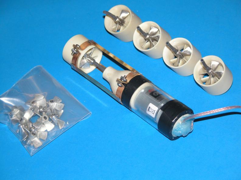

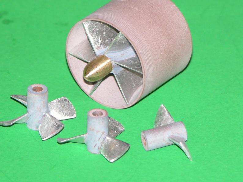

        We placed an emphasis on providing functional control surfaces, and efficient pump-jet propulsors – and to render those items to scale with the SEAVIEW; no over-sized control surfaces or out-of-place running gear. The last thing we wanted to do was corrupt Gary Kerr's excellent work of capturing the 'look' of Admiral Nelson's iconic submarine.

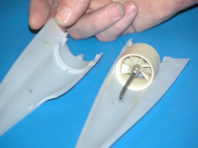

        However, and these were necessities of function, departures from scale included opening up the pump-jet intakes in the propulsion tubes ahead of the internally mounted pump-jets; punching flood-drain holes either side of the central keel; and inclusion of a set of guide-vanes within the propulsion tube nozzles.
        Those well hidden guide-vanes produce a pitch-up moment to the submerged submarine when thrusting ahead, needed to counter-act the pitch-down moment produced by the shovel shaped bow.

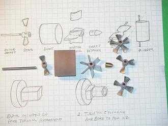

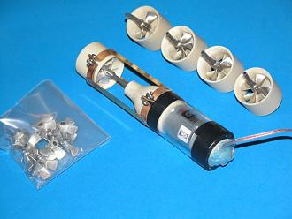

        As the pump-jets are fixed within the narrow confines of the propulsion tubes, a means of easily making up the intermediate drive shafts that inter-connect the SubDriver motor shaft to the rotor-shaft of a pump-jet and are inaccessible to fat fingers. The solution took the form of spring-loaded, telescoping intermediate drive shafts.
        Note that there is very little room near the stern, and the long reach the intermediate drive shafts have to make to reach the rotor shafts within the pump-jet duct.

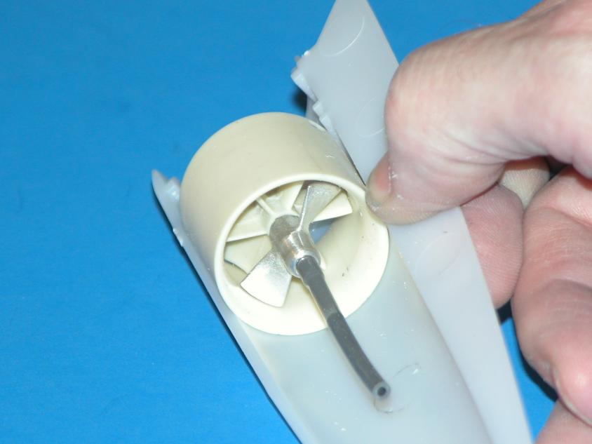

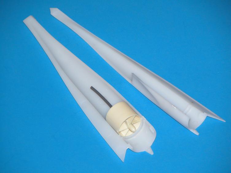

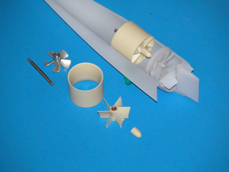

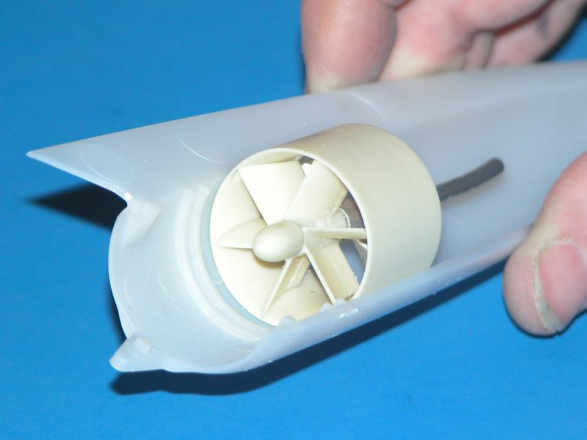

          Thank you for posting photos of those fixed guide vanes.
          Was looking over photos of your fittings kit and was initially wondering why were there 2 smaller elevators. I then remembered you mentioning the need for fixed vanes to counter the bow down effect but could find any photos of them in place.
          What's their angle of deflection?
          Pity you ceased producing fitting kits for the Seaview. Just got my hand on a Moebius kit. Just need PJ and stern fiitings.
            • 13988
            #1730
            about five-degrees at the trailing edge. Bob has all the masters and tooling now.

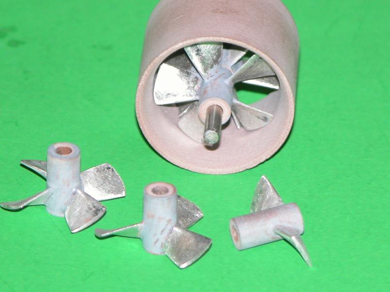

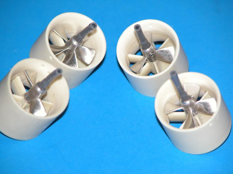

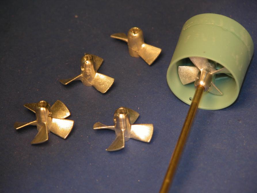

              Thanks.
              Would it matter if the PJ stators are straight ?
              I got this idea for a homebrew PJ using some odds and ends from another hobby.
                • 13988
                #1732
                Thanks.
                yes.........................
                  #1733
                  Yes good or yes bad?
                    • 13988
                    #1734
                    Yes. It matters.
