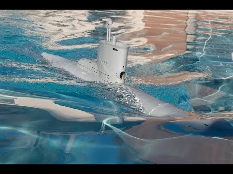

        I believe this Tom's Chalfant's Type XXIII with your 2.5 SD. No porpoising whatsoever.
        Unfortunately it was lost out on patrol.
          • 14014
          #3004
          First time I've seen this video. Thanks for sharing. Now, I have hope!
