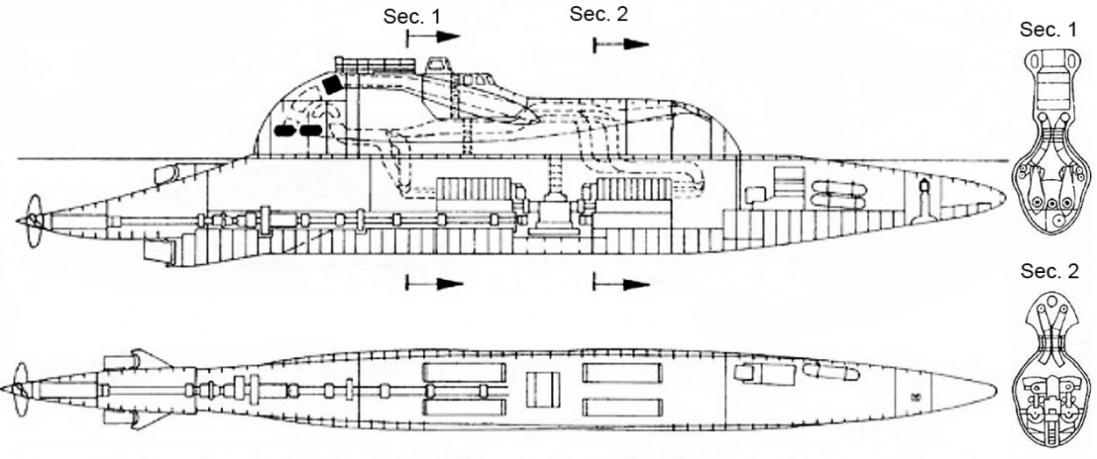

    Submersible Tragflugelboot. Plan was to wait in submerged mode. Once the enemy was in range ballast tanks were blown and high speed attack and subsequent evasion was done on the surface.
    Here's something I wish Manfred made.
ID:	187965 Click image for larger version
ID:	187966 Rudolf Engelmann's Versuch Schnellboot 5 (Experimental Fast Boat 5 or VS 5) also known as Engelmann-boot, a semi-submersible, fast-attack torpedo boat for use in coastal waters. Armament consisted of two forward-firing, 21 in (533 mm) torpedo tubes in the bow and two 20 mm cannons atop the superstructure.
