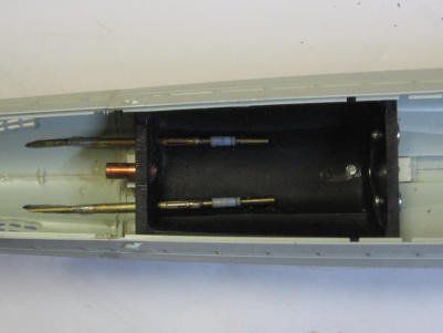

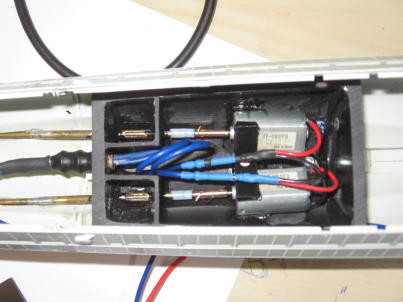

            Waterproof motor box? Click image for larger version
ID:	181025 Click image for larger version
              • 13990
              #2241
              Nope. In the wet.

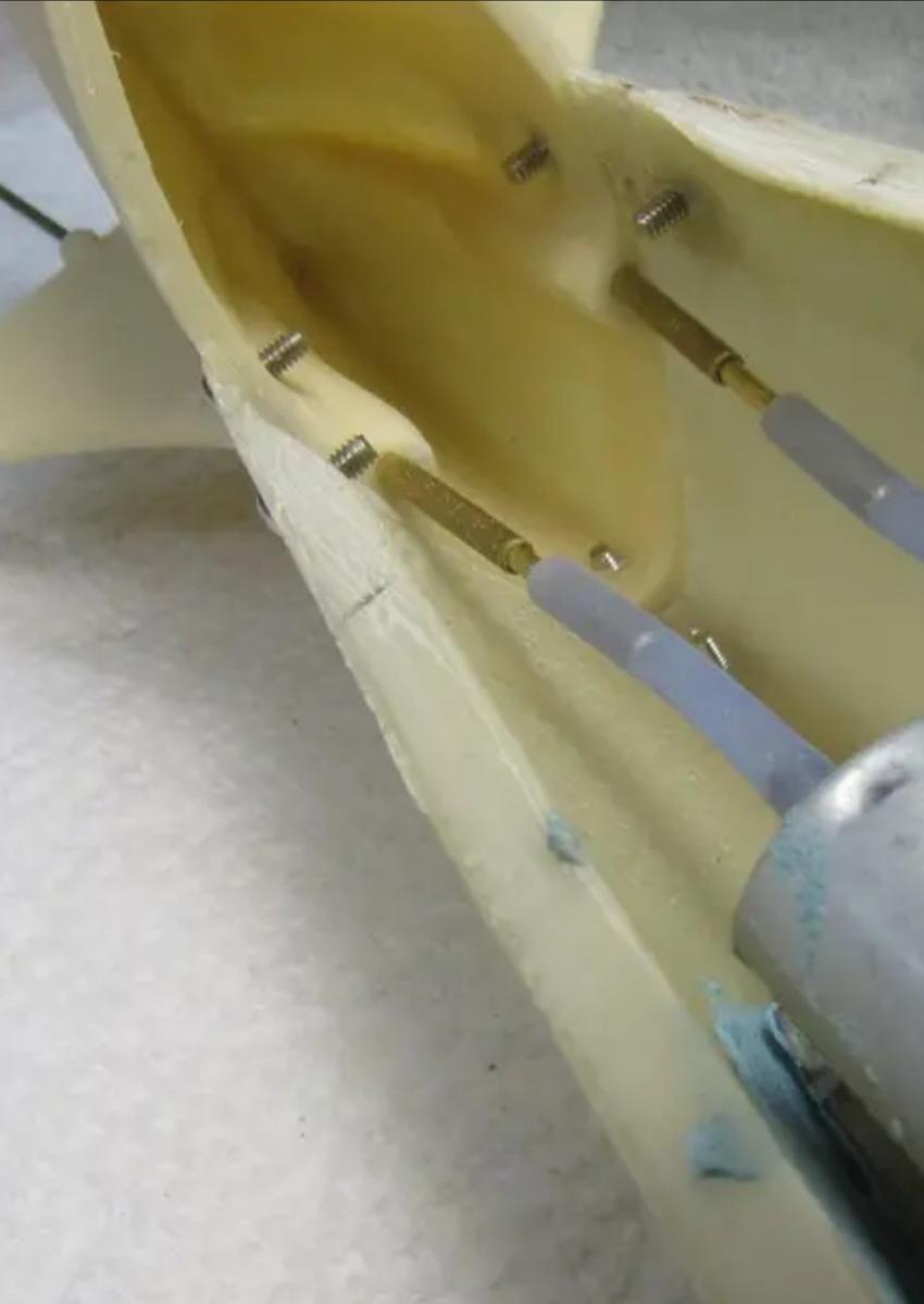

                Thinned the air dry putty to paint it on and then sand it down?
                Grtz,
                Bart
                "Samuel Smiles"
                  • 13990
                  #2243
                  Grtz,
                  Bart
                  Yupe......

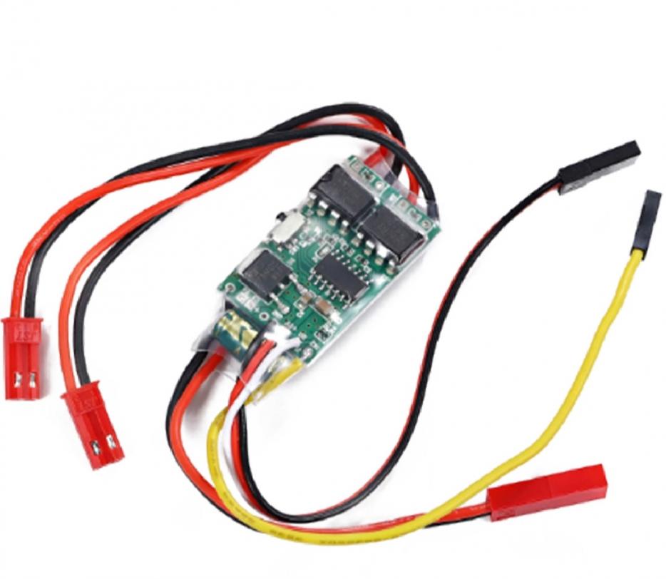

                      #2245
                      6-14v dual brushed motor esc for RC tanks

                        No such thing as differential steering with varied propeller thrust on this design -- the nexus point of the two shaft forces is so close to the actual boats c.g. that the only effect was a slight crab -- a lateral motion -- instead of the desired yaw motion.
                        On the actual boats, that nexus point was aft of the c.g., so what very little yaw differential thrust produced was ass-backwards to the norm. Conning one of these beasts within the breakwater must have been a total *****.
                        Study the toe-in of the Type-21 shafts and think it through, pal. Nice ESC you've dug up on the internet, but useless on this submarine.
                        The two motors will be wired in parallel, and one ESC will do all the work. KISS.
                        Rudder, stern planes, and bow planes will be practical... as usual.
