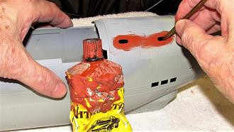

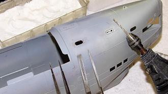

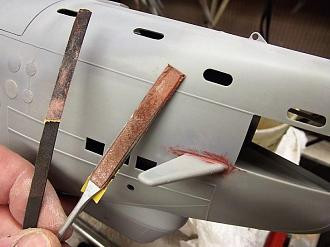

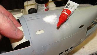

      I wonder if the modifications David did to the limber holes on his boat has some effect?

      Like the holes in a flute, cover one and the pitch changes.
      Maybe repositioning and changing their size results in some turbulent flow which causes the oscillations

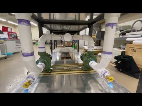

        Would be great to have access to a hydrodynamic test facility to test the theory on David's actual boat or the 1/144 scale Type XXIII modified to mimic David's.
