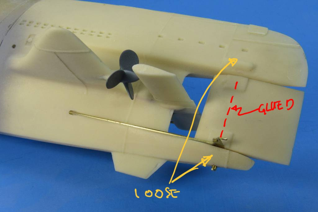

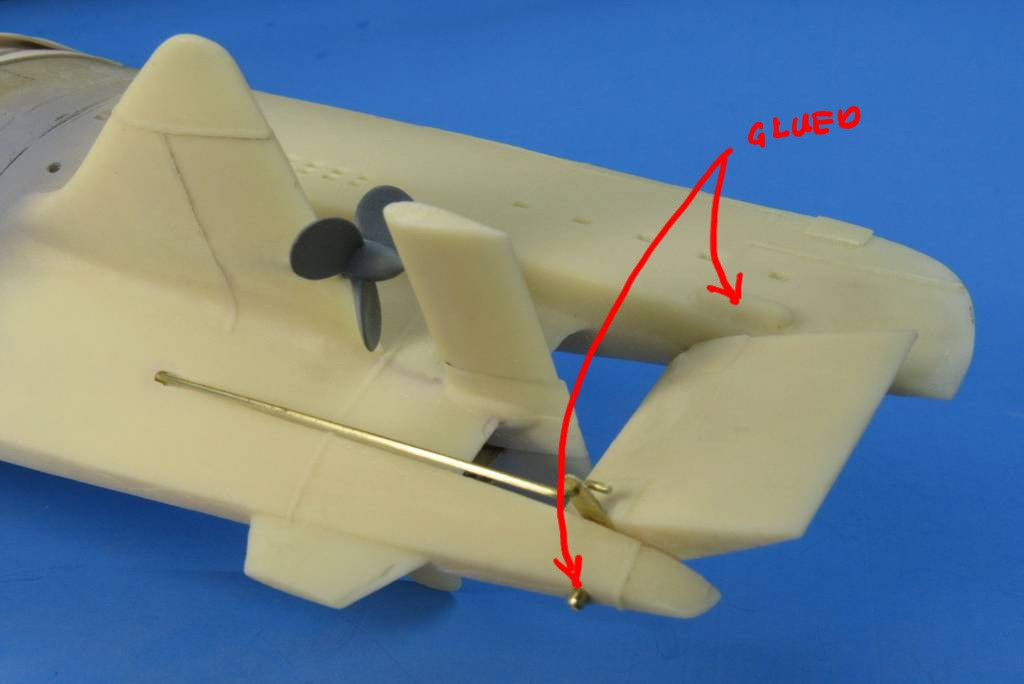

          Is the rudder post glued to the rudder piece and freely rotates in the top and bottom stern section
          or does the rudder piece pivot around a fixed rudder post?

            The rudder operating shaft is a jam fit to the skeg sections and the bore of the rudder is a non-interference fit to the operating shaft. It takes only moments to install/remove the entire rudder assembly.
                Interference Fit. Got it....

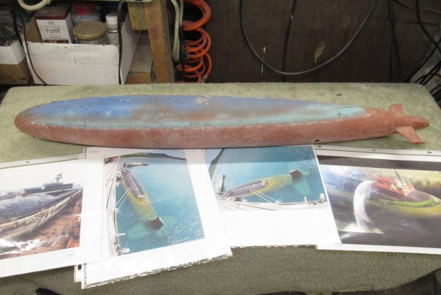

                            Fellow Torpedoman and all-round pain-in-the-ass, 'Jake'. Getting his 1/96 SKIPJACK up to speed. Class is in session!
                              #2279
                              Jake,
                              a before and after shot of the hull would show the great deal of work that was accomplished. Well done.

ID:	181313 Does Jake incorporate static grass/flock to replicate the "marine growth" on the hull?
