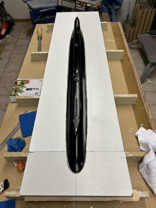

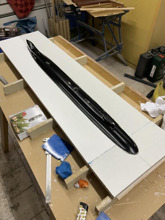

      Herr Doktor.
      Yup. As I dared not physically split the hull master longitudinally, I elected to form the tool parting plane by embedding the master, about half way, into a depression cut on the moldboard to receive it.
      That process demonstrated here, during creation of the glove-mother mold tool used to produce our 1/96 Type-212's, and other tools:
