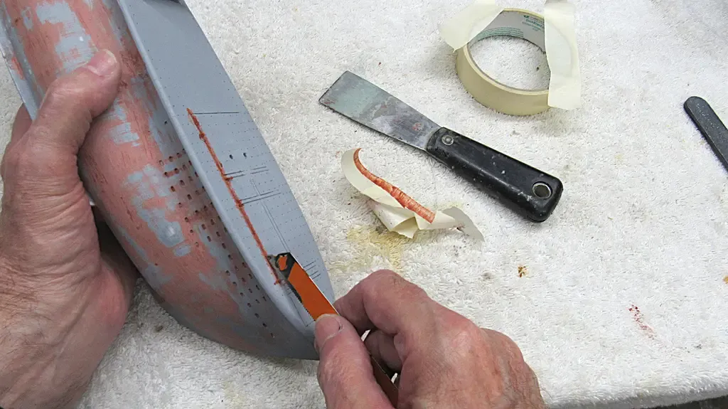

                            David - are you getting a totally smooth cut that needs no more work other than sanding off excess red putty at this point? No crumbling edges on the red putty? Thank you.

                              The trick is to re-scribe as the putty is half-dried; hard enough to push out of the scribing tools way as you dig the putty out of the engraving, but soft enough to keep from chipping away from the filled area adjacent to the engraved line.

                                Got it. I’m going to use an old hull and just practice, practice, practice until I really have the technique down. Did not do too bad on my South Dakota scribing but I think there is huge room for improvement next time out of the starting gate.Thank you David.
