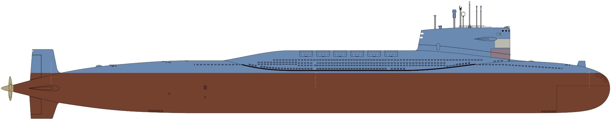

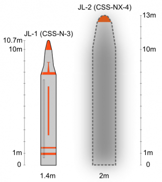

          #1114
ID:	159949Click image for larger version
ID:	159952Click image for larger version
ID:	159950Click image for larger version

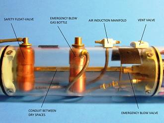

                    Can the Seawolf 2" SD be used for this boat?
                      • 14014
                      #1120

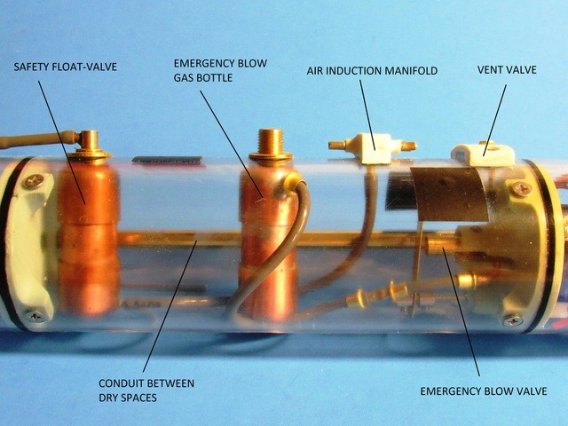

                      I'm using the 1/96 BALUGA, 2" SD

                        #1121
                        How long is your ballast section?
                        • James Wittaker
                          • Oct 2021
                          • 67
                          #1122
                          Maybe you can weigh the mass of all the plastic kits above the waterline yourself and then make an estimate to get a reasonable ballast water volume , it's really not that hard.
                          Mr. Merriman has done this operation tens of thousands of times and is probably tired of answering such questions, because you can do it yourself and it is not difficult.

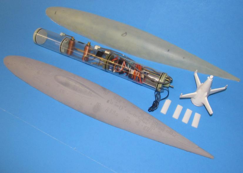

                            #1123
                            I don't have this particular kit, yet.
                            I posted the pictures in one of my FB groups and someone was asking for the size of the BT and actual SD.
                            Looking at the photos the entire SD looks like it's around 15 inches long. The ballast section looks like it's 6 inches long giving a approximate volume of 300 cc. Click image for larger version
