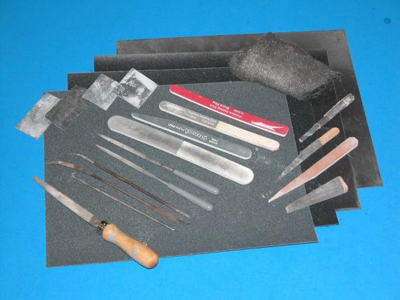

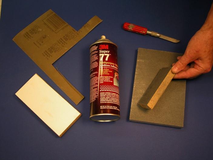

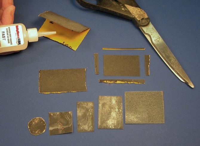

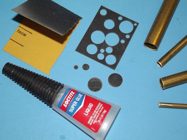

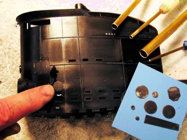

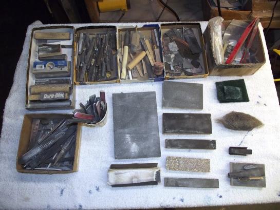

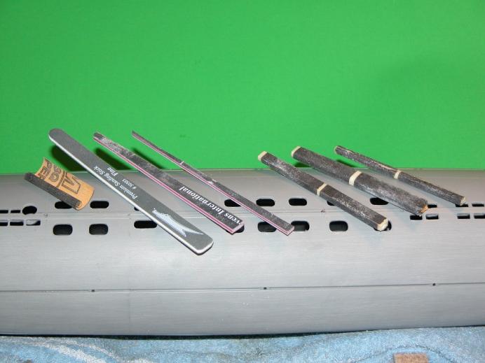

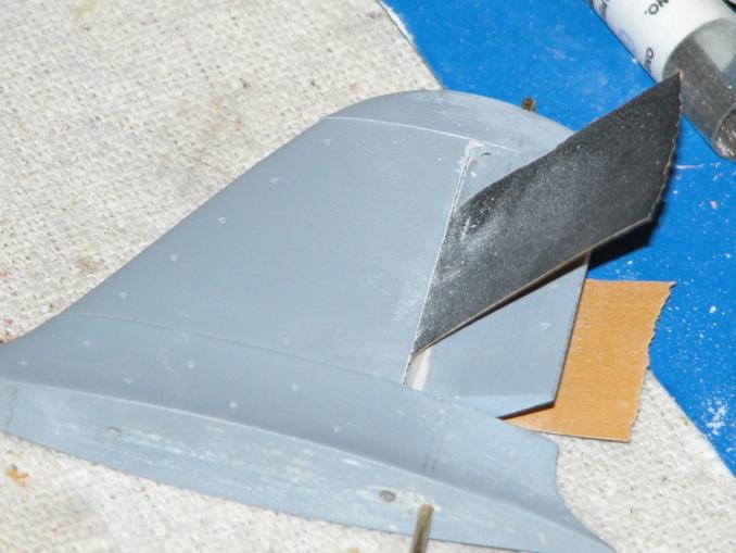

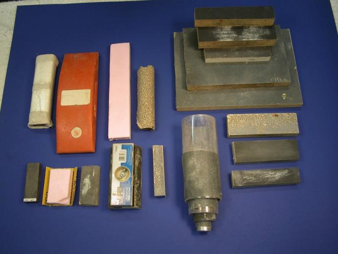

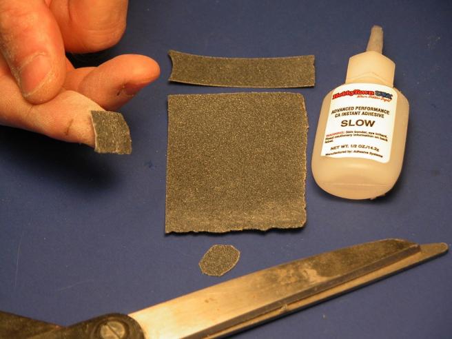

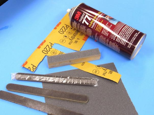

            You big goof-ball! I've seen your work. You're already doing it! Here are some abrasive tools and tricks to put under your hat, Ken.
            Files and scrapers are also abrassives.

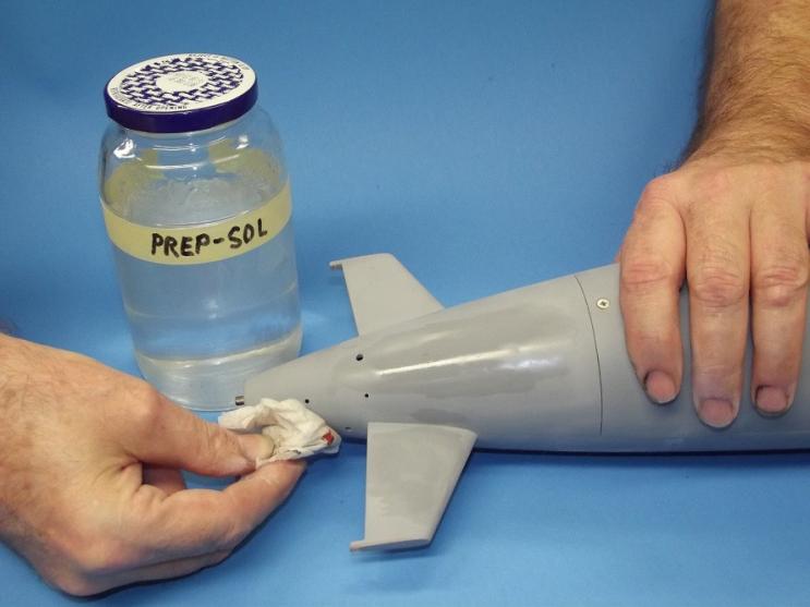

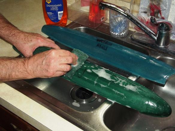

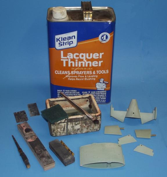

                  What matters -- and negates your remove the masking before/after the paint dries question -- is that the models surface is clean, freshly abraded, scrubbed down, and degreased with an appropriate solvent before any glue, filler, putty, paint, or clear coat goes down.
                  Once you handle the model with your scummy, oily, greasy, smelly paws it is contaminated with what is, in essence, a release/masking agent that must be removed before applying any of the above mediums. If you don't, the primer won't adhere properly to the model. And this applies to the later overcoats as well.
