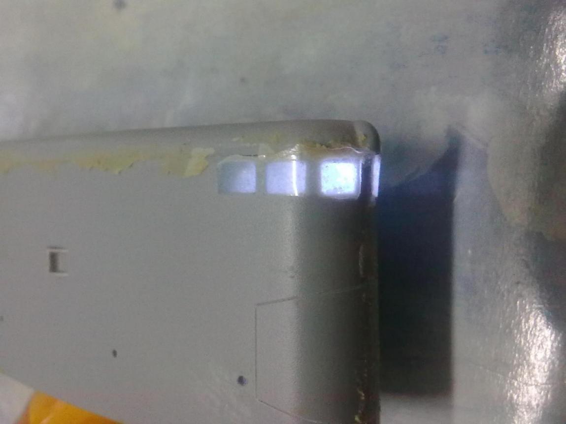

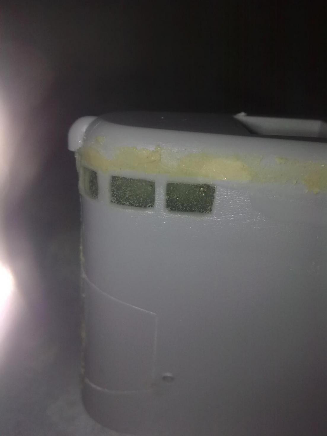

        #1788
        Did the same with my 1/144 Kilo. For some reason the clear epoxy didn't dry clear but with a yellowish tinge. Must be the bubbles from the mixing.

        Those UV cured resin might be a good alternative for small windows, portholes etc.
        https://www.dakkadakka.com/dakkaforu...st/800247.page
