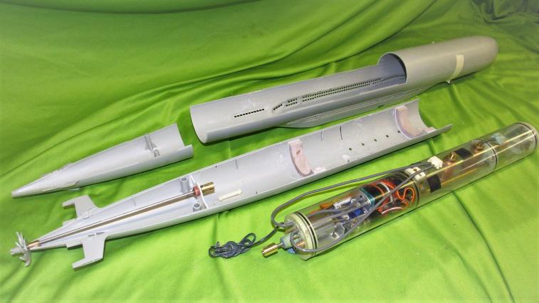

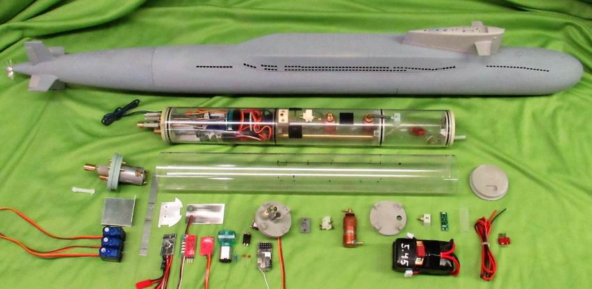

              Is that 2" Subdriver tailored specifically for the Astute or a repurposed Seawolf SD?
              What happened to the Chinese PLAN Xia Class?
                • 13988
                #2542
                The ASTUTE will have a dedicated SD of it's own -- ballast tank volume to suit that particular boat. The XIA is alive and well and hibernaiding in a dark corner of the shop.

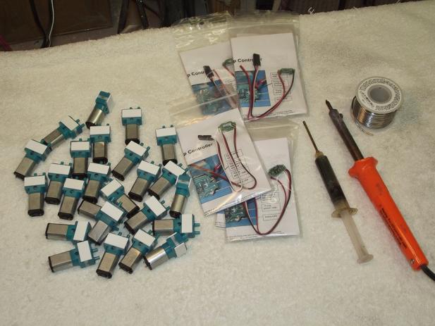

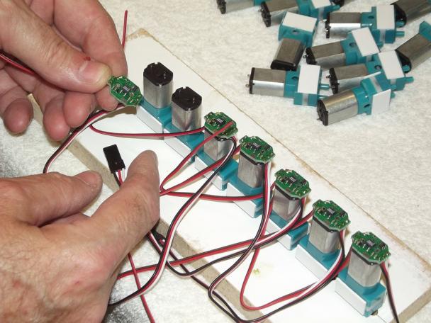

                  One of my Gato pumps is not sealing (allowing free flow backwards, so need to run pump continuously to keep ballast empty. If I do not, air will work its way out. Where can I buy some of those pumps (like the ones in your TrumpeterAstute)? Was there any modifications I need to do once purchased?
                  Peace,
                  Tom
                    • 13988
                    #2544
                    Peace,
                    Tom
                    Today I can't find any of them on Amazon or Ebay. Back in the day -- when we worked for Mr. Caswell who had the buying clout for massive discounts from China -- he would order them by the hundreds, but over time I've pretty much exhausted those I had left in the bins since I retired. Sorry, not much help from this end, Steve. Good luck. They are used in portable blood-pressure machines, so if you can tear one of those apart, you likely have the pump you need.

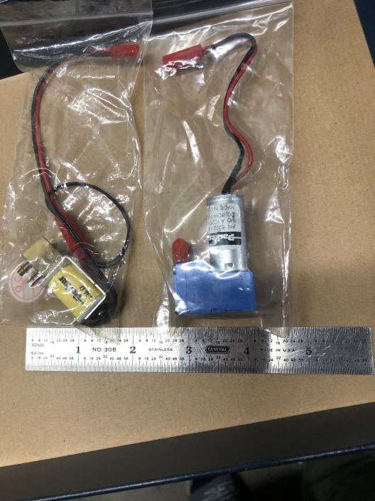

                        Cliffhanger67 (Honorio Lim) uses micro diaphragm pumps from Parker Hannifin onboard his scratchbuilt Harpoon Sub. Click image for larger version

                          You can get them from Aliexpress for pennies. e.g. https://www.aliexpress.com/w/wholesa...etail.search.0
                          Sounds to me like your existing pump has a leaky valve, shouldn’t be difficult to fix, they’re simple little diaphragm pumps.
