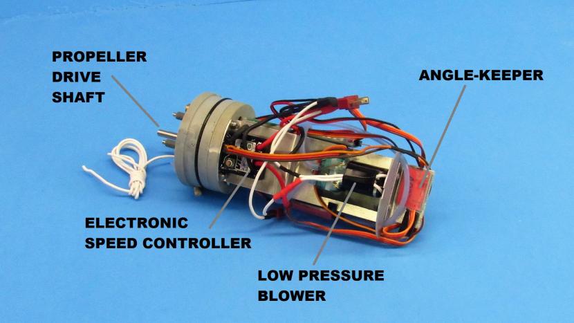

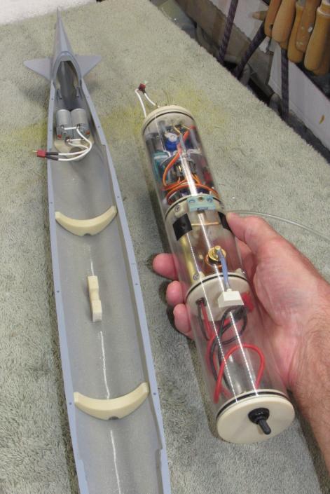

                            Question, at which setting you run the ADF?, got to know for the future, still have to order some ADF's from Bob together with some other needed stuff.
                            Manfred
                              • 14013
                              #2699
                              Manfred
                              For a new boat -- and I've only got a few minutes underwater time with my little Type-21 -- I set the ADF to its least sensitive setting. The Type-21 was rock-steady about the pitch plane with the ADF set to the lowest sensitivity setting.
                              Only rarely do I find a boat that needs a more responsive angle-keeper.

                                Thanks, it will be noted down for the future, saves time adjusting the ADF
