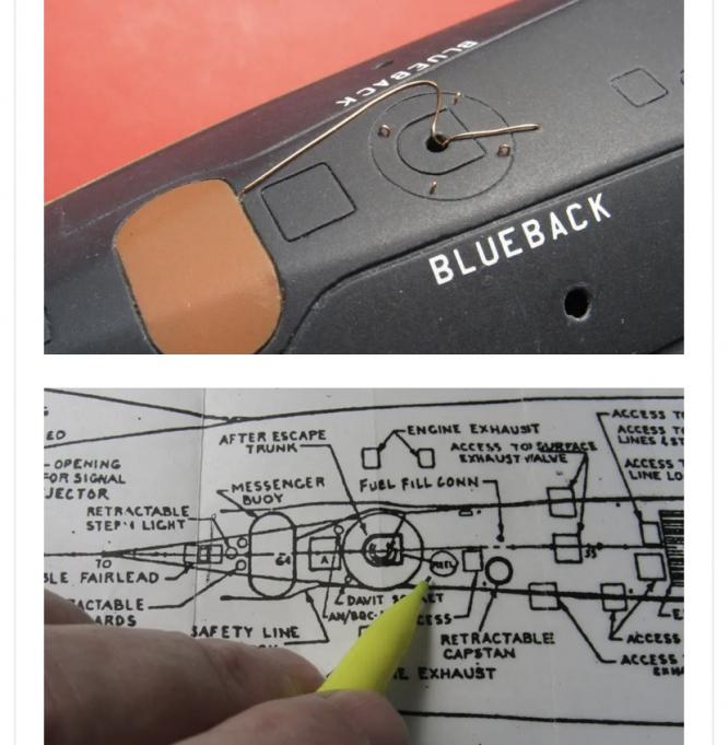

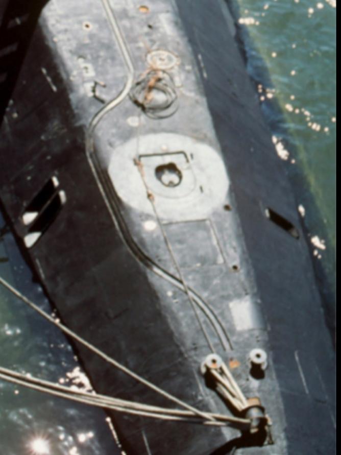

            Did the actual Blueback have messenger buoys? Because every photo I’ve seen does not show them. Were they at one time on the boat and removed later? This photo shows where the bouy should be, along the safety track and in front of the retractable bollards at the stern. I ended up doing away with mine.
              I honestly don't know. The BLUEBACK TAB general-arrangement drawings show the buoy and cable reel, so I went ahead and am completing the model so configured. Also, I strive to make an r/c type model submarine as 'colorful' as possible to help with visibility while operating submerged, and that internation-orange buoy fairing is most colorful and an opportunity I just could not pass up.
