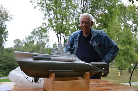

              Pictures of Norbert Bruggen's 1/15 scale CB 20 I got from AMS site.
ID:	185613 Click image for larger version
ID:	185614 Click image for larger version

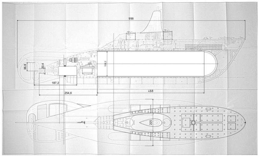

                        Going to printer to enlarge plans this morning. The CB submarines used a 450 mm (17.7 inch) caliber torpedo. So, adjust accordingly. I'm sure you have the appropriate torpedo in your quiver. I will need to make measurements in the printer store where they have the self-serve enlargement printers.
                        Will see if 1/32 scale will work - thats my scale target. I want to use off the shelf existing components wherever possible. It could be 1/32 might be too small for the 2-inch WTC. We might have to opt for 1/24. Will get back to you after returning to the printers. Stand by
                          • 14012
                          #2757
                          I'll defer to you on what scale we settle on, Steve. Better too big than too small. Ideal would be a scale that results in a mean annular space of at least 3/4" between WTC and hull.
                          Regardless, I'm compelled to scratch-build new torpedo masters. No biggy.

                              The 1/32 scale is do- able. We will go with 1/32. The waterline break affords a curved flared out contour allowing a big gap wide enough (if the hull break is at the waterline) to basically shoehorn in a 2-inch wtc. Tipping front up and in and sliding back. the drawing seems to suggest that's very possible. Like loading a cartridge in a rifle backwards. Magnet connects should make easy & sure to shaft and stern controls. No bow planes. If you think the scale should be different, time to say now.
                              a
                              It's a great size the hull lines are widened a skosh more - 1/4 inch more an 1/4-inch deeper for added volume that no one will ever notice.
                              I am starting off on the template sections tomorrow and its 'get going'.
                              How long is this 2-inch wtc Dave?
                                a
                                Click image for larger version Name:	cb-flare-out.jpg Views:	0 Size:	67.8 KB ID:	185632
                                Go with 1/32. As I'm doing the layup, I'll strive to make the above waterline structures paper thin to minimize displacement of those structures. If I put the motor in the wet, I'll be able to size the 2" WTC to fit.
                                Proceed, sir!
