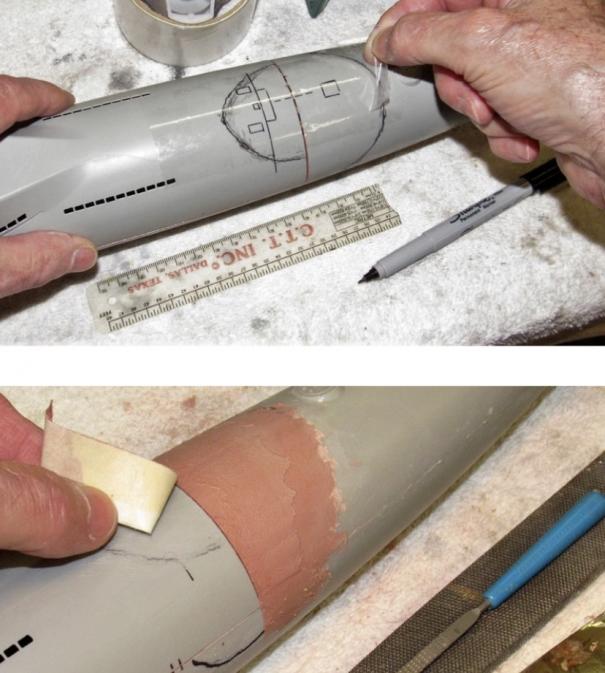

                  Dave on your Chinese boat, can you advise me what you’re doing here?
                    • 14013
                    #2634
                    After splitting portions of the upper and lower hull and joining them to the opposed halves I found that the assembled hull went 'bannana' i.e., it was bent, not straight. The Bondo work was performed to straighten the hull as best I could.
