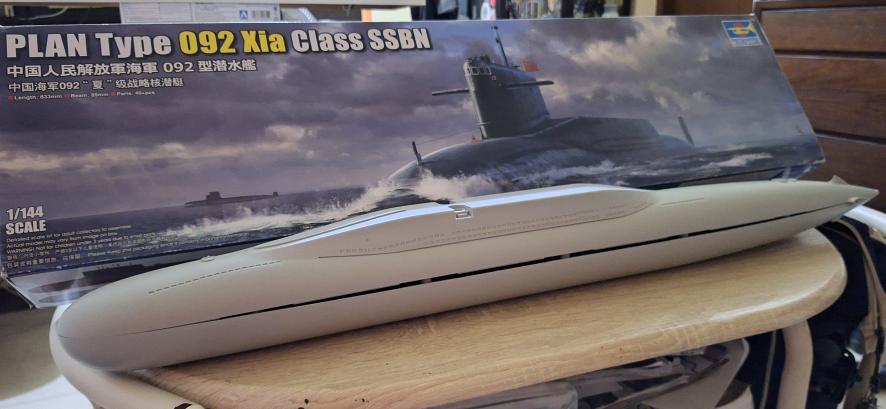

                Well for what's it worth, I just got a Type 092 Chinese SSBN Click image for larger version  Name:	20241117_192450.jpg Views:	0 Size:	49.5 KB ID:	184153 I weighed the upper hull sans the sail, sailplanes, rudder and missile hatches and got 0.19kg or 190 gm.Let's over-estimate and put it at 250gm.
                So the Type 092 needs around a 250ml ballast tank. With a 2" diameter wtc, the BT section would be around 5 inches long.
