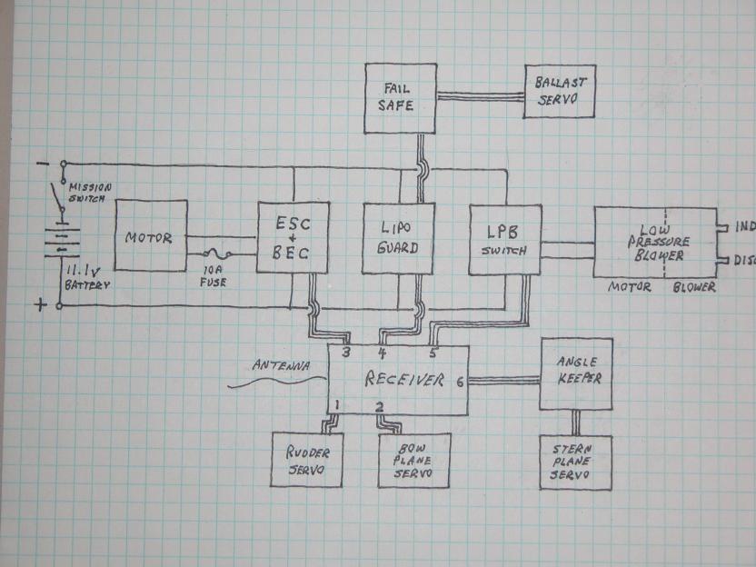

    Can you post a wiring diagram of your SAS/SNORT subdriver?
    It goes something like this:
      #2522
      In the case of your 2" SAS SD instead of an electronic LPB switch on ch5 you use a mechanical switch (red) activated by the ballast tank servo, correct?
        • 13988
        #2523
        Yup................
