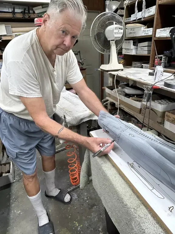

today's work

    why this particular cut?

      David, what type of cutting wheel are you using and on what rpm? Genuine Dremel?

        It's a standard circular saw that produces a kerf of about .025". As I'm cutting polystyrene, I'm using minimum RPM's. Feed is in the direction of saw rotation with multiple passes of very shallow cut till the two halves of the hull are parted. Slow work, but if done right only a cut is achieved and no melting of the adjacent halves. It's a standard Dremel multi-speed motor mounted on a fixture that assures a solid stance while pushing the saw into the work. Work and saw must be rigidly secure to the working surface for this technique to work without flaws.
        If cutting GRP, or that funky plastic you encounter if cutting a robot produced hull, I outfit the Dremel with a thin diamond wheel. GRP will dull a carbon cutting wheel in a heartbeat.

          Thank you, will make such fixture and try on a future project!
