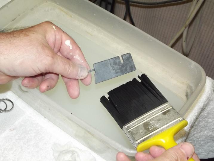

          I'll also use this gun to apply un-cut gelcoat to the LOTUS tools when the time comes to lay up GRP hull parts for Darrin, Bob, and myself.
          Something a bit like this, but with ... ah... a bit more fines!

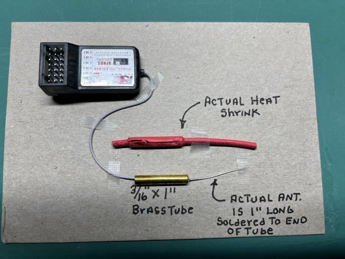

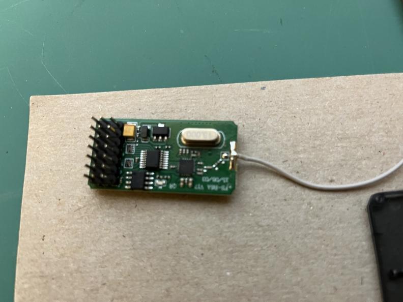

                          I am sorry for jumping your build blog! But I do need your advice on my 2.4 MHZ receiver.
ID:	169210Click image for larger version

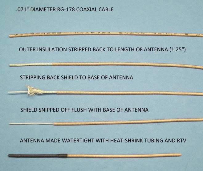

                          Do I need to install a 3/16"X 1" brass tube on coaxial cable install? Or can I eliminate it and just follow your photo that is listed below. None of my receivers have the button clip, so I need to solder my coaxial cable to the receiver as the photo above shows. Curiosity! What purpose does the brass tube serve anyway?

                            I know not the function of the brass tube. I've operated systems without it, and the radio link works.
                            Proceed as I've instructed.
