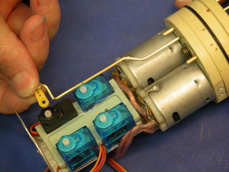

                      #3130
                      Dave, I’m always afraid of putting stress on the entrance/exit of the servo linkage while bending them, causing damage to the gasket. I use another pair of holders on the exit to ensure I don’t. You make it look easy and unnecessary. Also, I’ve never seen you slip that cut out WTC on when you bend the linkage. That’s a new one on me.
                        I have the complete range (diameter) of those 'linkage/pushrod integrating jigs' but this appears to be the first picture I've posted of one being used.

                        Though I'm long out of production-mode of WTC assembly, I still break out the relevant tooling, jigs. fixtures and documents (not lost in the flood) when the need arises.
                        What was once a business is now again a hobby.
                          #3132
                          Do you find the Z bend always the easiest to use, and does it have the best range of motion?
                            Good range of (rotational) motion, marginal anti-back-lash. But good enough for us. Chosen because I'm from the school of, 'don't permit perfection to become the death of accomplishment'. If it works, don't fix it.
