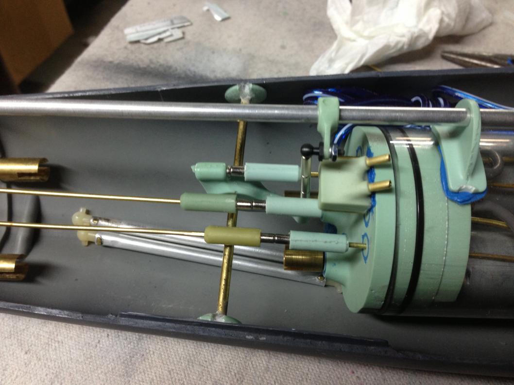

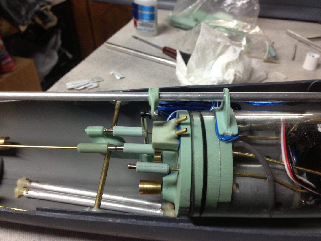

      1) the placement of the rod and torque tube on top of the wtc does it make a difference? What hardware resin pieces are involved?
      2) how do i make up the push rod connections to both the rod and torque tube? I see some pics and i have a general idea, but nothing concrete
      3) torque tub to the retract mechanizim. Do i make another dog bone connection like the thrust rods?
      4) is there a permanent connection step i need to do with the bow planes to the retract mech? Right now there are two small rods that the struts go over but nothing keeps them from sliding off them over time and movement

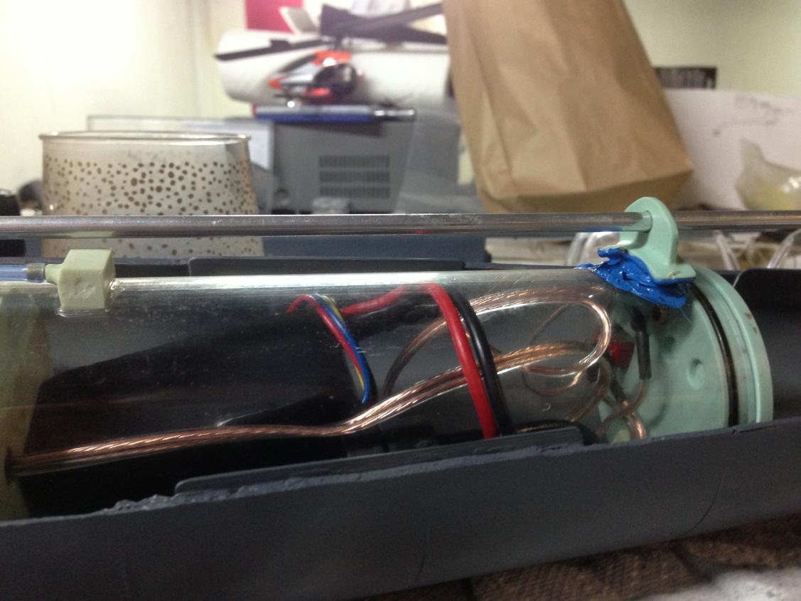

        So, i think ive got this figured out. I had to really study trouts pics to make sure i understood what was going on. I also readjusted the wiring inside the drive area. Still squished but better. I might use rtv on the servos instead of servo tape. Ill see how the tape holds up
        ive rtv the switch. Ive added the snort bulkhead to the end of the wtc with more rtv for a nice seal. I raised the bow torque bearing some using more rtv. Seems to work nicely.
        More to do tonight

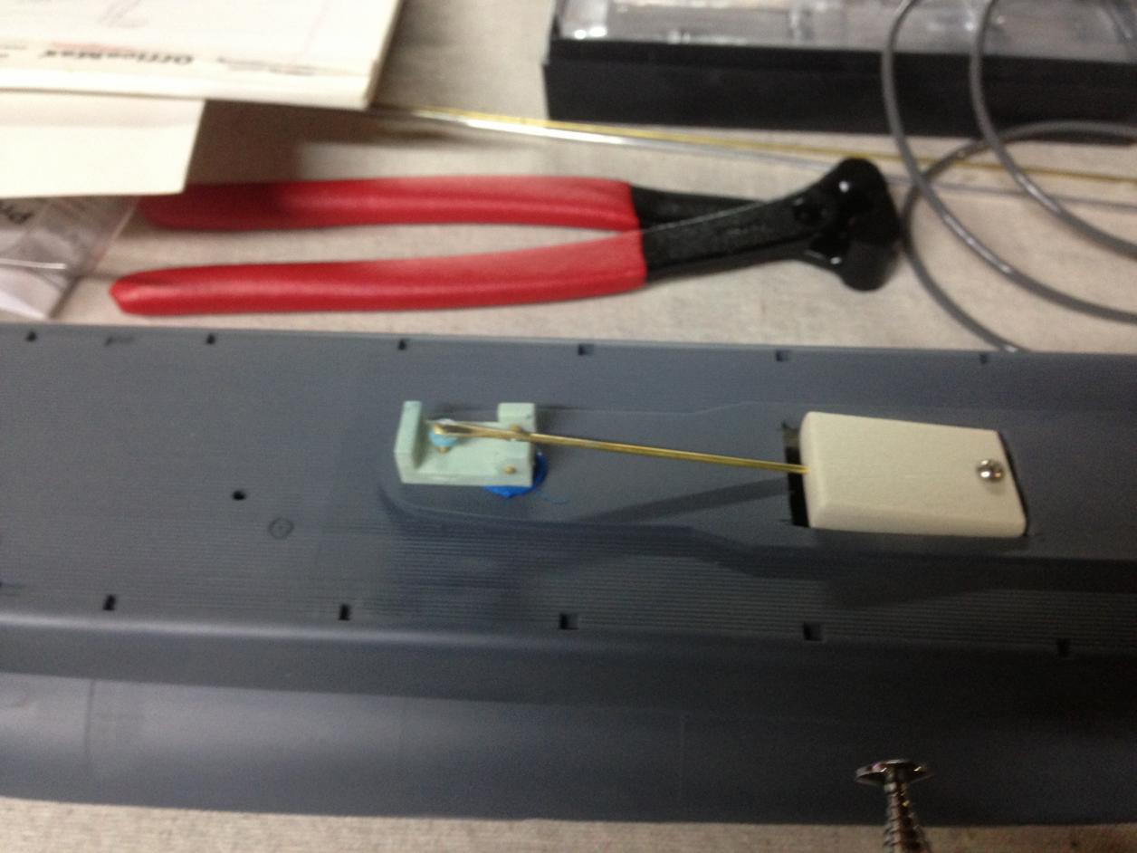

          #244
          When hooking up the snorkel within my SAS. Is there anything special i need to do with the hoses that leave the wtc? From the pictures ive seen it seems that i just match them up to the bulkhead on top of the wtc then take another hose and connect it to the float part on the upper hull
          thoughts?

              #246
              Test your ends by placing a finger over the openings to see which is sucking and which is blowing just to verify.

                #247
                So, when that is determined where do i go from there on hooking it up to that bulkhead right before it goes to the upper hull. That bulkhead has two hose ends and one on the other side that leads up to the upper hull float

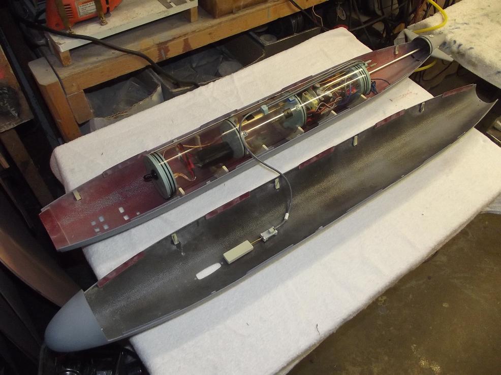

                    #249
                    The hoses will look like this.
