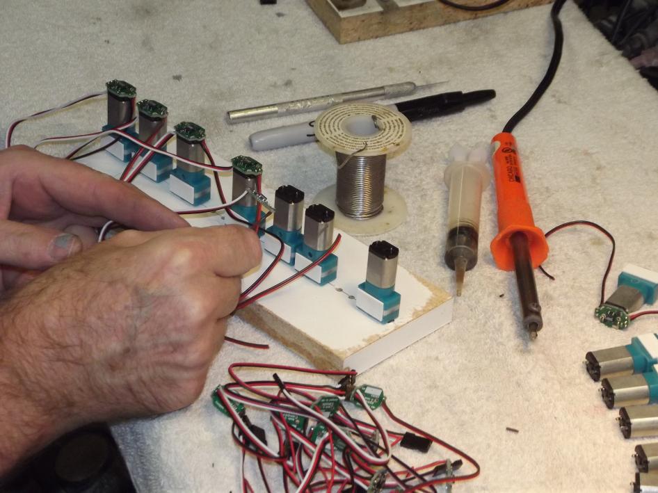

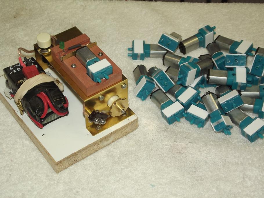

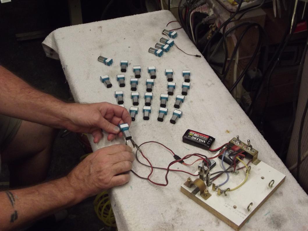

          No problem. However, when I get it I want to affirm that your particular pump motor was one of the bad lot that got out of China and into our supply chain. The last year I've gotten in two batches of LPB's and only found two (out of fifty), that had the infamouse bald spot on the commutator. During that awful period I deviced this motor tester that cycles the new arrivals so I can nip bum units in the bud -- long before they are installed into a SD and off to a customer who has plunked down the big bucks for a bad unit.
