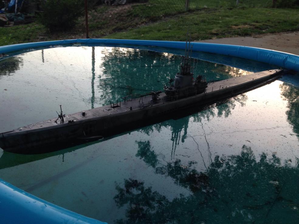

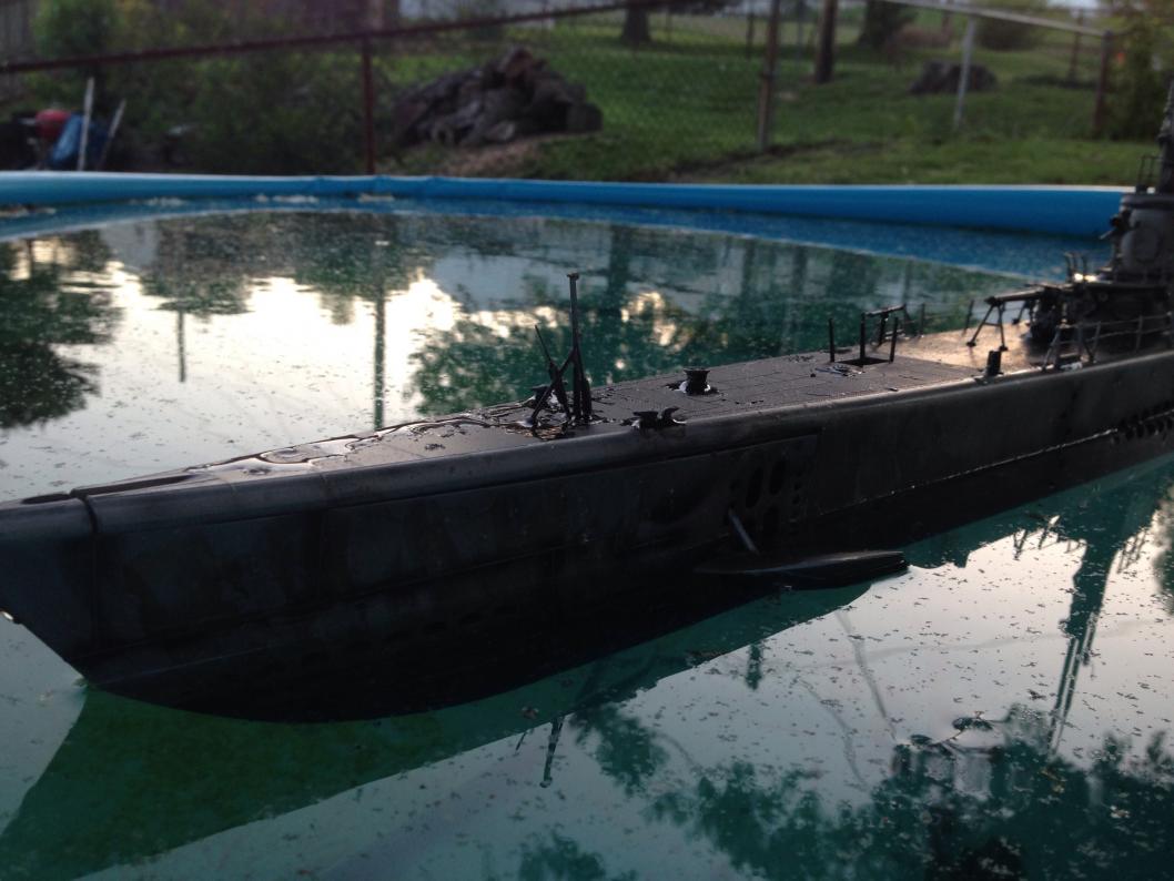

ID:	91458Tonights testing yielded a higher freeboard, but still not boyant enough to come back after fully submerged (which i still dont understand why the stupid thing doesnt come back at all if i have no leaks ... As the sub was floating just fine before venting)
      but im about to run out of space to tuck foam. Ive got a few more spots then im going to either go drastically below the waterline or start attaching to the upper part of the upper hull

        You're closer than you think.
        You've almost got the freeboard to be scale, and you still need to add foam as the boat is still terribly negatively buoyant when the ballast tank is full. Good.
        Keep cramming foam until you achieve the correct surface trim waterline -- if then the boat is still negatively buoyant submerged, then you can start placing the foam in the above waterline portions of the superstructure, keeping at that till the boat in submerged trim floats with only the shears above the water.
        Almost there, pal!
