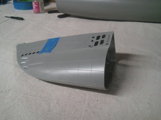

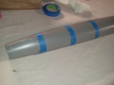

    So, as posted earlier on I think trout's thread of being scared ****less about taking on this challenge with his build (after seeing his troubles), I've decided to carry on with my build anyhow. I officially started on the 1st of this year with cleaning downstairs to prep for the area that I'll be working in. Below are the first pictures of the sub's hull being assembled.
    The hull didn't have too much of a bow in it, so that was a nice surprise. This morning I removed the tape and finished gluing those areas. Tonight I should have some time to continue:)

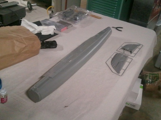

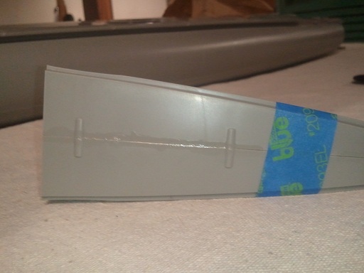

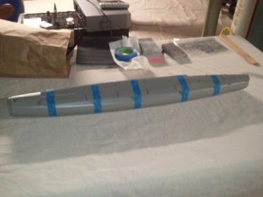

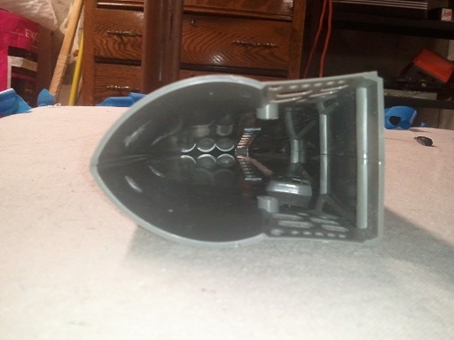

                              Progress:
                              Last night I assembled the bow, I had to use some tape as these pieces were slightly warped and not fulling touching for a good weld. This morning I removed the tape and finished off the weld as everything turned out well from last nights drying. I should be cutting out access points within the bow tonight.
