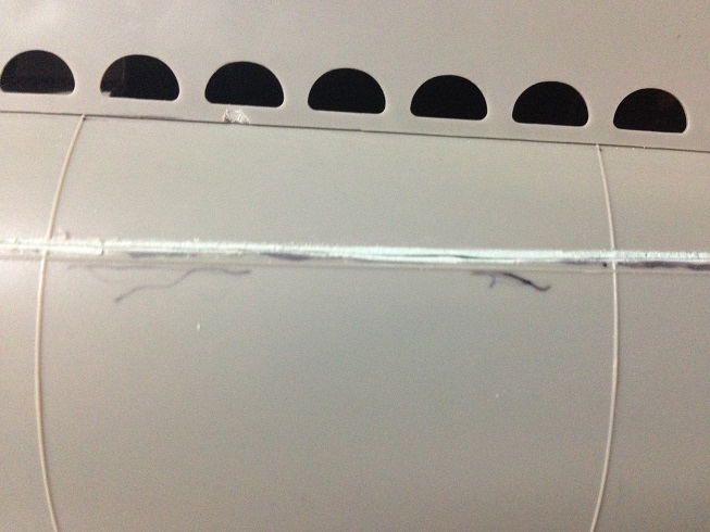

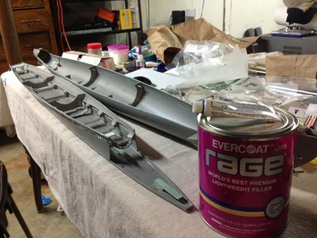

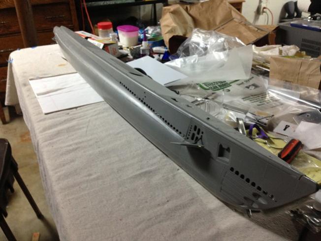

    So, i went through the filler part of the sub build. I used Rage for my filler of choice that i actually had purchased 2 years back. I naturally followed the directions as listed on the can, but realized that it was a mistake ... for a small go of the filler on the sub i wasted 90% of my first batch ... then i realized how dense i was being (this is for a model and nothing larger) so i drastically reduced the amount of material and hardner that i needed with each application.
    So instead of just hitting spots that i thought needed to be filled i went ahead and applied some filler across the sub (for the most part there were area's that i thought needed it). Then i did the same for the bottom as well. In the end i was very pleased at it seemed to have produced a nice thin gab between the two sections (granted there are still some parts of the hull around that line that i see areas to fill (but i think that's further on the building process when i start applying any last minute smaller fills).
    pics and more pics

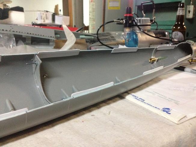

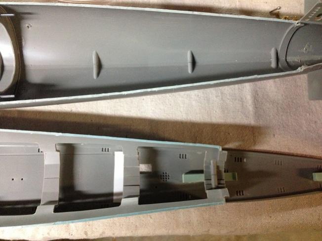

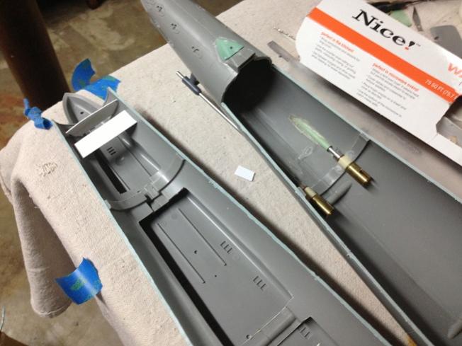

      Last night, i finished the tabbing on the upper and lower parts of the hull. Pic of the lower hull is below. The fit is nice and tight; but there are some tabs on the upper hull that I need to sand down just a touch so that they fit better. Once I finish that task i think i'm ready for sanding down the model as described in the DVD set (Very thankful for the DVD set ... a lot of things about building these types of models are described within the set that i can and hope to apply to other builds after this one). Are there any other build/kits that have this type of DVD kit? Also, did i start off with a harder model lol (so far i've been enjoying) for my first build? What is considered to be the easiest kit to build?
