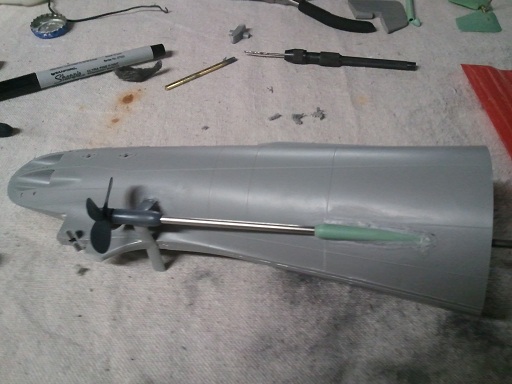

              Ok, so reviewing my photos ... i really didn't have a lot to show LOL as most of my time this weekend was dedicated to fixing minor mistakes with the rudder. But, ultimately; I did managed to do the following:
              1) prepared both the stern tubes and propeller cones
              2) removed the skag piece (and if you noticed I didn't glue the entire piece to one side of the stern before removing. Was easier for me this way (well i say that now lol). Was cut at an angle because i'm retarded and didn't square of the cutline before hand; but it will serve its purpose. Also, if you noticed the build up of CA on part of the skag; well that's because of the mis-alignment i had with the rudder and such....thought it would be brilliant to remove some material from that portion of the skag so the rudder would rub at the angle it was at. Ultimately i had to redrill the holes in the barrings used to support the rudder for better alignment; thus not needing to have that material removed in the first place.
              Some interesting notes: I'm a pro at CA and baking soda now ... lol.

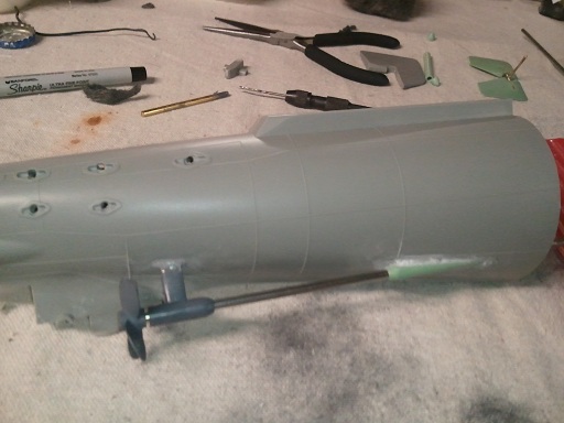

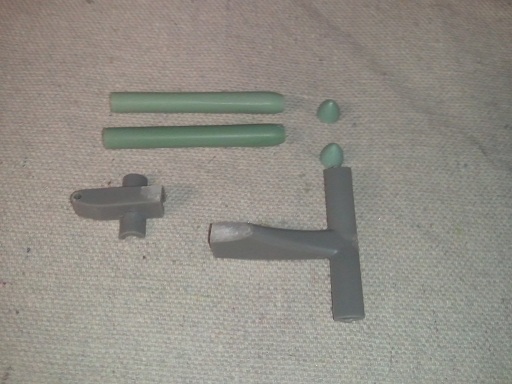

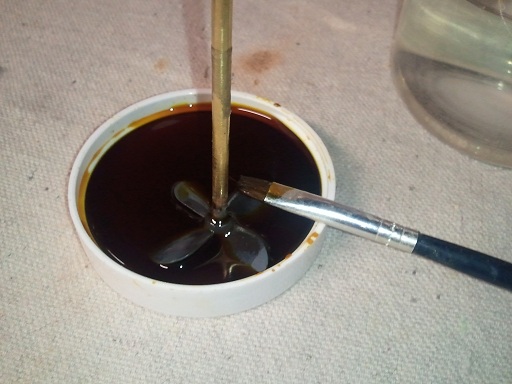

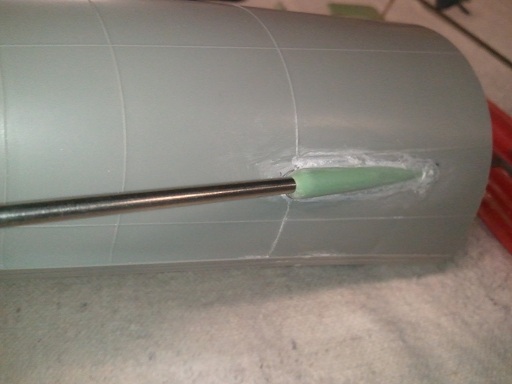

                  #38

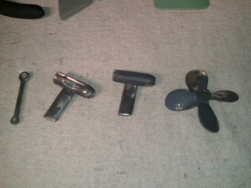

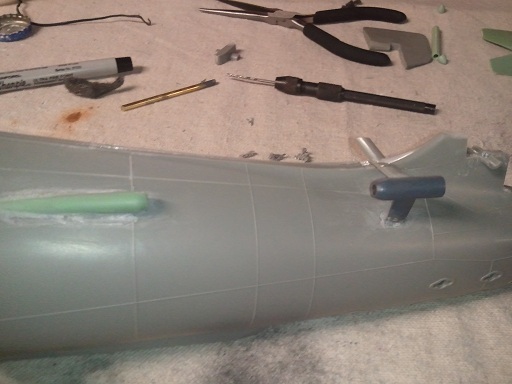

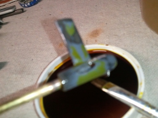

                  Ok, so over the weekend i got a lot more done on the build. I would have had more and would have uploaded these earlier; but i've been pretty sick (still not feeling well). I've managed to acid the white metals, primer them, fill them, sand, acid, primer, fill, etc...etc. Furthermore i've managed to install one side of the stern tubes along with the strut for the propeller shaft ... even after filing/sanding/etc the CA makes it look crappy on the model; but i'm assuming the primer and paint will cover that up nicely:)

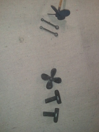

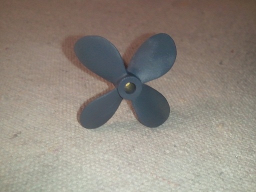

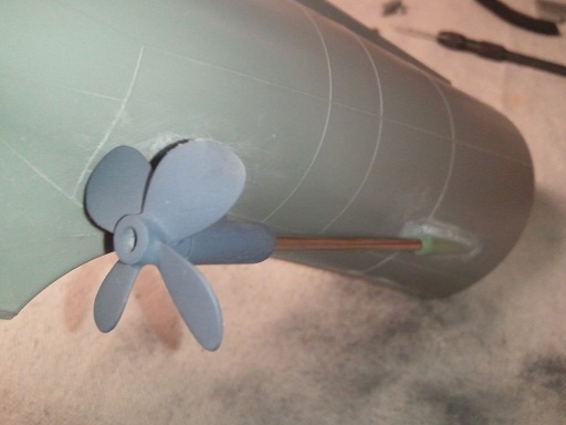

                    #39
                    Ok...so curious question. I just finished the other side of the stern and i used the same propeller and shaft for fitting the components in place before applying CA. Clearance was perfect.....BUT, when i decided to try both shafts and propellers i noticed that the other propeller now hits the side of the hull?? i'm thinking what is going on. Perhaps this is just my ignorance of these props, but it seems one is slightly larger than the other and they both have exact opposite pitches (even if i turn the other upside down lol) .... is that normal?
                    Thanks,
                      • 14013
                      #40
                      No. It's my error. That one prop is a bit too much in diameter. Trim it down. The fix is on my 'to do' list.
                      • matthewnimmo
                        • Dec 2011
                        • 271
                        #41
                        ok cool....but them having exact opposite pitches is normal right?
