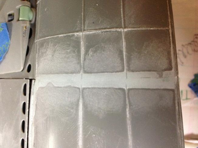

              I might try that David, problem that i'd face today is that I don't have any spreadable wax to apply to any tape (which i don't mind going out today ... i already have to hit the walmart...perhaps they might have some that will work?)

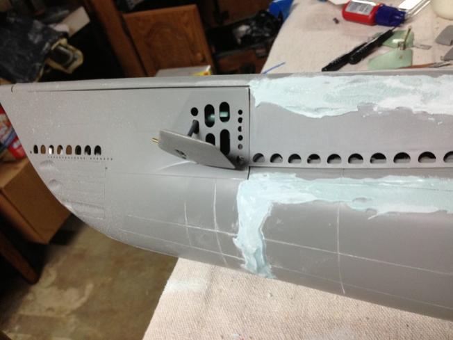

              But below is all the work that i have done so far. This was all done before any of these suggestions
              1) Right after I had done the first side of the sub (no masking tape...lot of sanding/grinding ... lot of regret). Starting of the grinding/sanding
              2) Almost done with that section
              3) Done, you'll notice a big glob of it on the upper part of the hull...that's because that section was a little warped and didn't match up well. So, the filler applied smoothed it out very nicely.

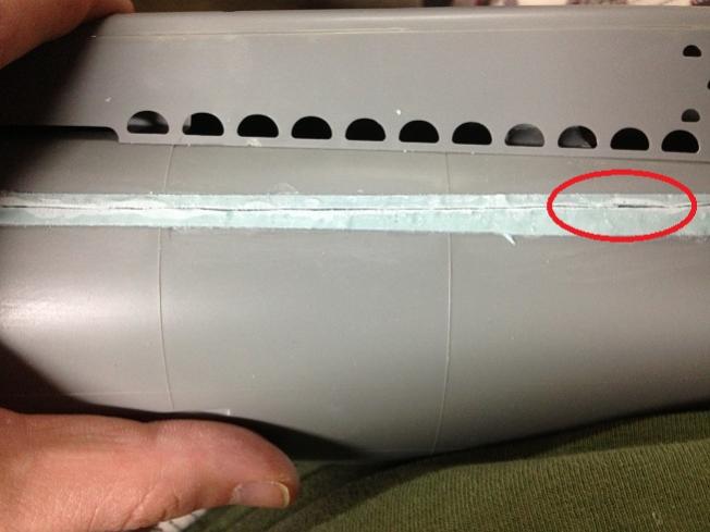

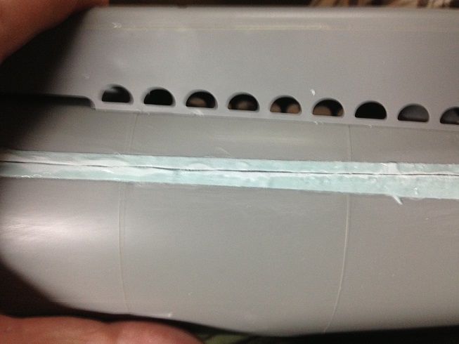

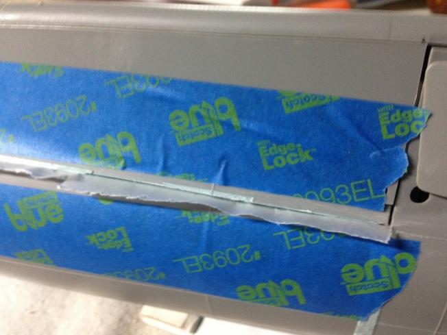

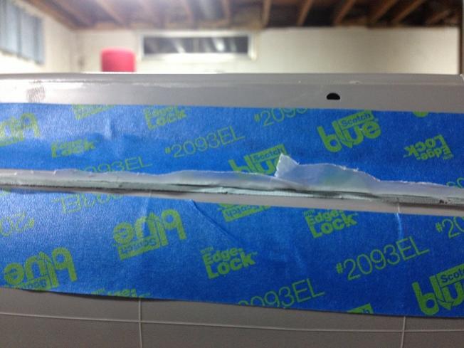

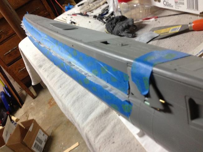

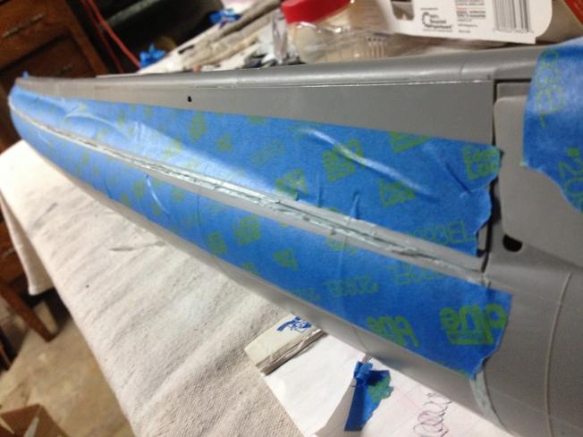

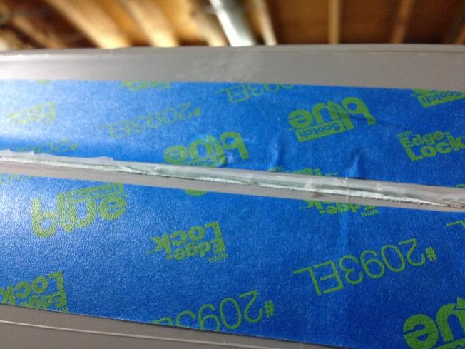

              4) Here is were I've already tried the masking tape and filler, but nothing to keep the two parts of the sub separated. I figured if i could apply it fast enough and gently pull them apart then i would sand down what was uneven....well that turned out to be a nightmare, i had entire section come off onto the upper hull or stay behind on the lower...not an even split. So (this was with all the indexing tabs in place still), i decided to try something very similar to what David had already suggested. on each index tab i had tapped a small section of wax paper (on both upper and lower hulls) then I connected the two pieces together and prepped for more filler. This way i would have a clean separation when removing the two sections. The last two pictures are ones that i have trimmed down the access wax paper that stuck out.
ID:	89835Click image for larger version
ID:	89836Click image for larger version
ID:	89837Click image for larger version
ID:	89838Click image for larger version

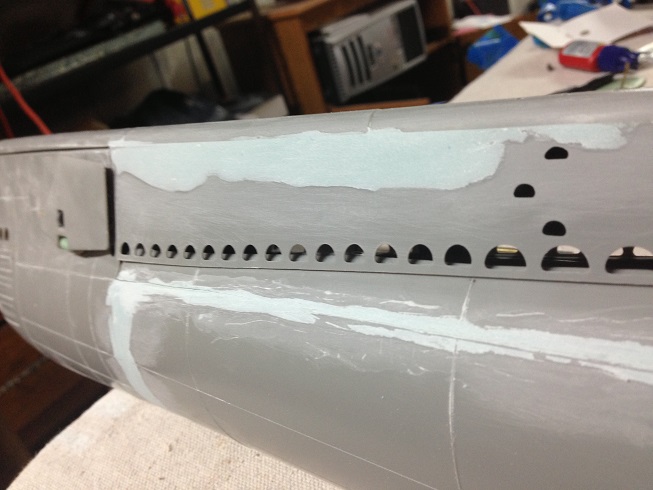

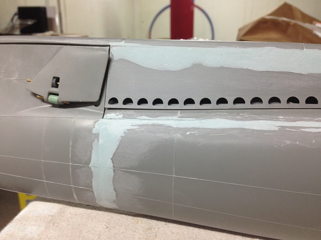

              5)Now, this is what is left over. Now, this is what i'm wondering about if i'm being "too anal" about ... now that I look at it again this morning ... some areas don't look too bad; but I wonder if i should strip it down and try it again for even better. or if i should call this good and move on now that I have the entire both sides done and ground/sanded down? The picture with the red circle is the issues that i'm talking about. Even after this sort of work, i still see these sections. Also, if i was to look closely on the top and bottom lips of the top and bottom parts of the hull...they are not flat and smooth (but in the pictures one can never tell)...just wondering if i'm taking it too far? The last picture is a good filler/sanding job i thought (that turned out nicely).

                  You won't get the seam perfect at the filler stage. That will happen as you progress through the putty and primer stages. Once you have coated your filler with CA, sand the surface of the filler areas with #400 to make the following air-dry touch-up putty stick to it better.
                  Put the two halves together, and brush the putty over the seam (I cut it a bit with fresh lacquer thinner for application with a semi-stiff brush). Before the putty sets up you lightly run the tip of a #11 X-Acto blade into the seam, this to keep the bridging putty from sticking the two parts together. leave alone for a bit, for the putty to dry, and wet-sand the applied areas.
                  Once you think you have things looking good, squirt some primer on -- this to reveal what a ****-hole job you actually did.
                  Repeat the putty-sand-prime cycle till it looks good in gray.
                  ... and take that pair of AMS-goggles off your noggin and stomp them to death -- you got a SD to outfit, install, and integrate yet. I don't want you flaming out on me!
                  Stop sweating the small stuff.
                  No wax?! What's wrong with you!!!!!? Vaseline then.

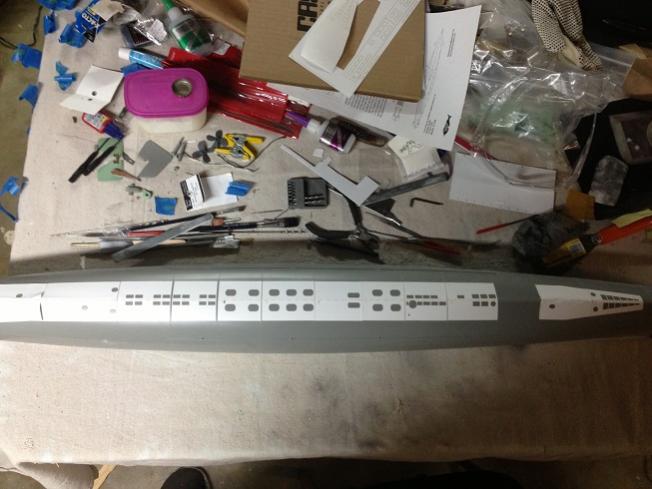

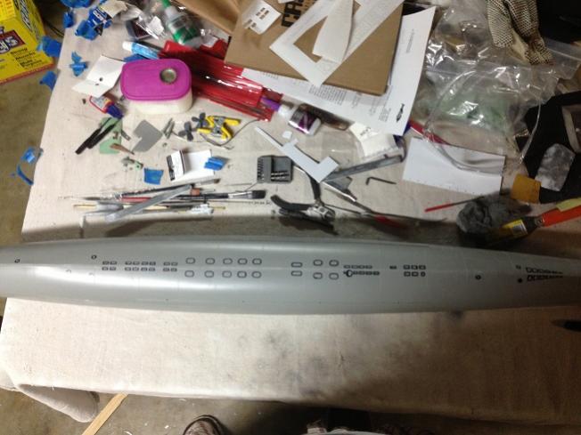

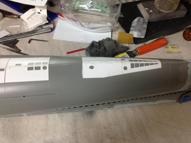

                        Thanks David for the info! Tonight was a lighter night of work. I spent a lot of time figuring out these flood templates (also not sure if i need any on the top of the model or anywhere else besides what i have below. BTW, i love the sticker templates from www.sub-driver.com, they were freaking easy to put on and work with.
ID:	89858Click image for larger version
ID:	89859Click image for larger version

                          #117
                          If you notice in the pics i didnt use the #4 flood template as when reviewing Davids dvds i didnt see that he used that on for whatever reason. Also, for all future gato builders i would like to say dont get rid of the weld lines until you have applied your flood templates. It makes life easier applying them
                            #118
                            Getting the flood holes marked and cut out is the next big hurdle. You're doing great!

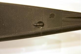

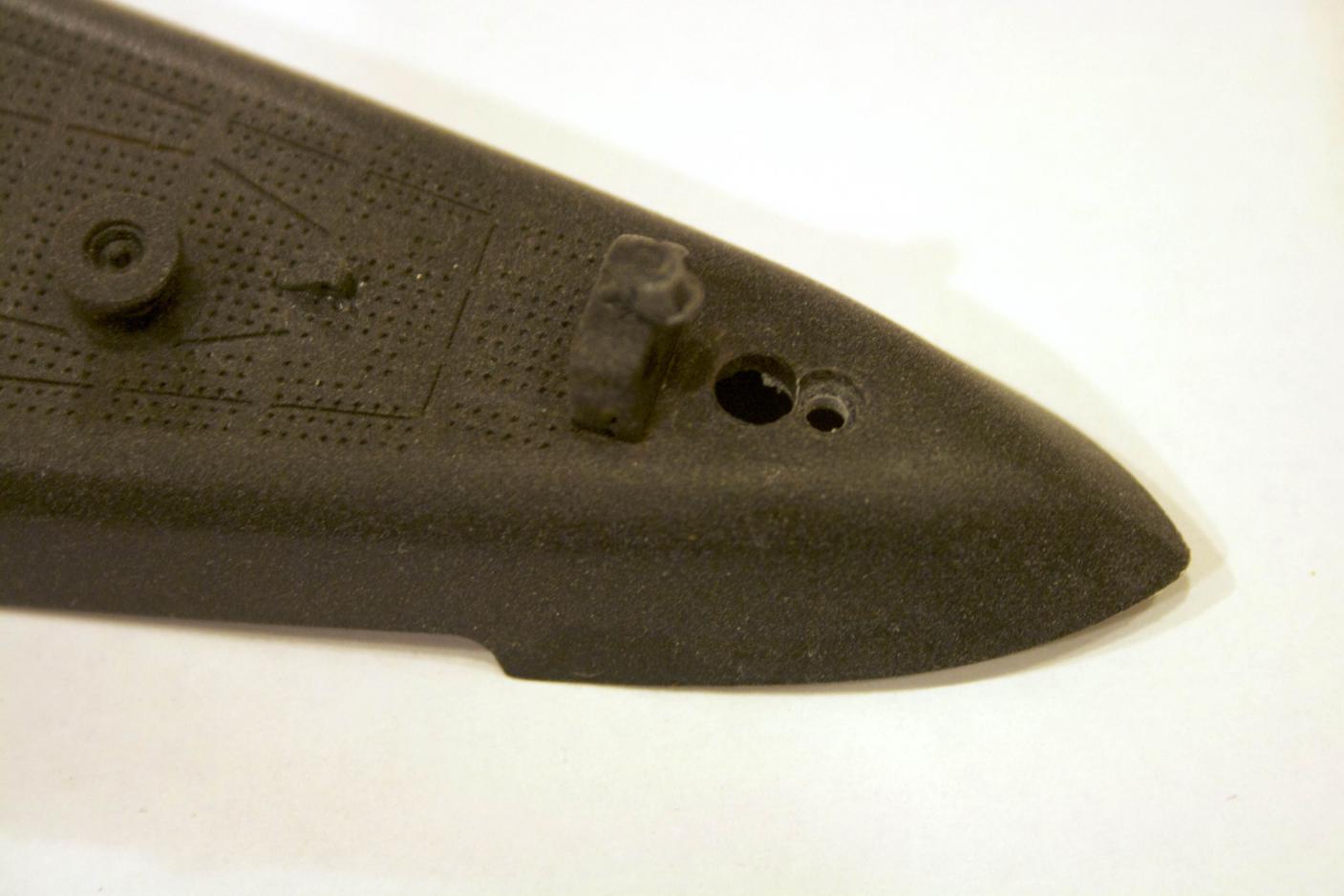

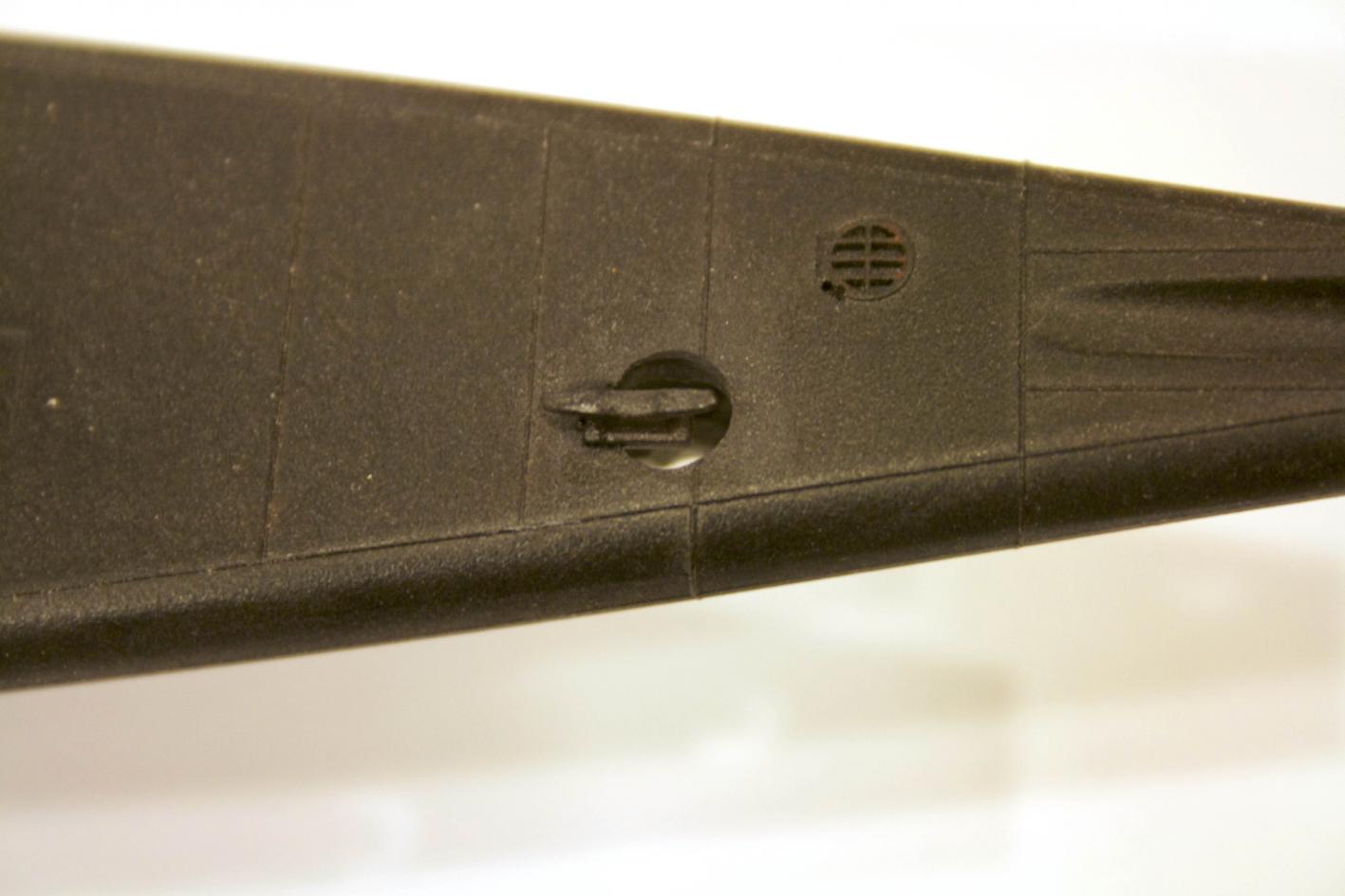

                                The areas I added vent holes on the deck are:
                                Bow under the cleat.

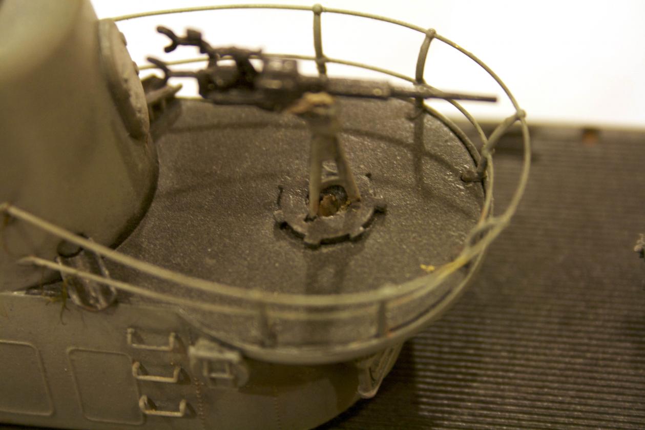

                                On the conning tower I removed the riser and drilled a hole in the base.
                                At the aft end just forward of the screw hole.

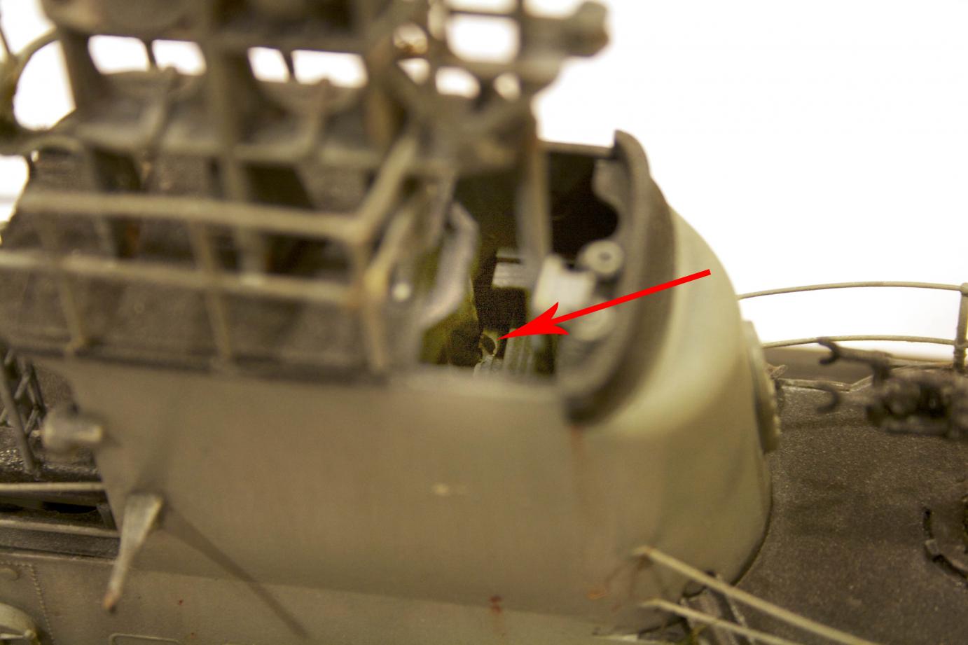

                                Also on the conning tower there are several hidden holes to allow air out.
                                The bow and aft end were important if I remember correctly. The one under the gun was added and not critical. The ones in the conning tower were put in there from the beginning and it helped reduce trapped air. Just look for anywhere that air could be trapped and open up some escape routes.
                                Hope this helps.
