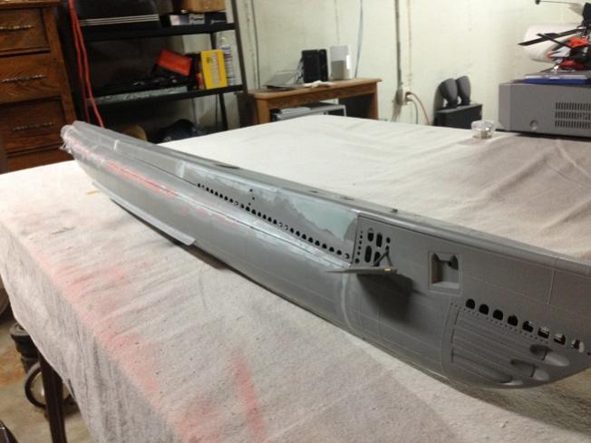

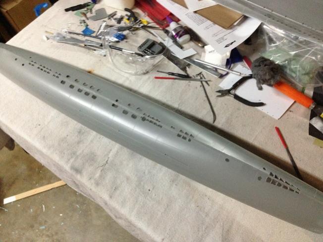

        And now for some posted progress.

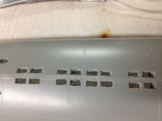

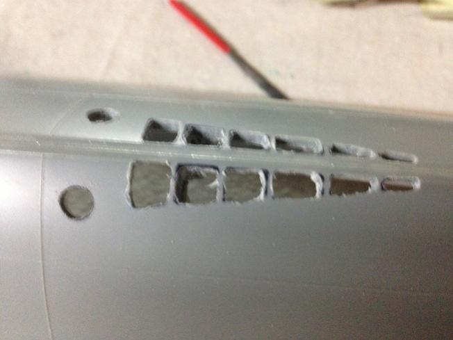

        Got all the flood holes drilled out.
ID:	89886Click image for larger version
ID:	89887Click image for larger version
        Then Sam Adams and I took a break after we filled down the holes after being drilled out (yes, i could have left them all circular; but that was bugging me some) Tried to get as close to the template as i could

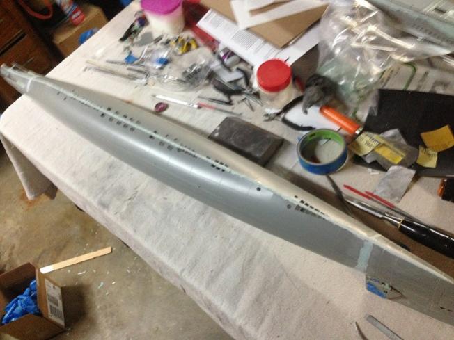

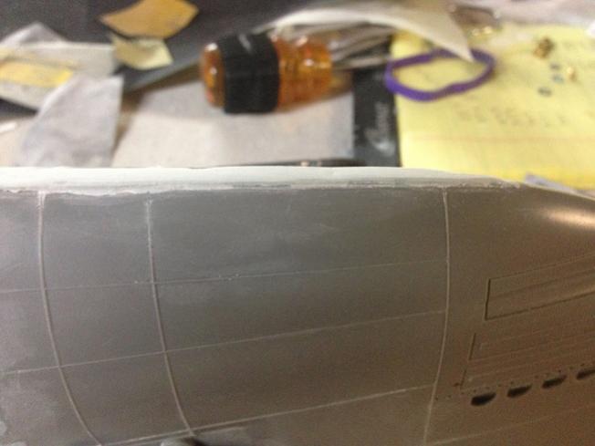

        Then i went back through and started applying more filler to some of the last areas. The biggest part was the keel, the other areas were the joining sections on the top part of the hull (not much to see on that but a thin blue line). But, below you'll see that i've started to grind/sand down my keel build up to something smooth and more level.
ID:	89890Click image for larger version
        I hope to have the keel and new filler areas smoothed out and ready for some final sanding. Then i'll prep for some CA then more sanding with 400 grit. After that, i'll do some touch up work with the putty/lacquer mixture and primer it until it actually "looks good in grey" as David said earlier:)
        "Scratches head" I might need to start on the conning tower before i think about primer now i think of it lol ... but i still might do the putty/lacquer to fill in the small gaps.

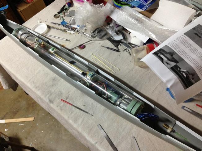

          Captain's Log:
          @David: The SAS SD finally arrived! But, i think I might know why it was delayed lol ... see below (you forgot a 7 in my address 2373 not 233).

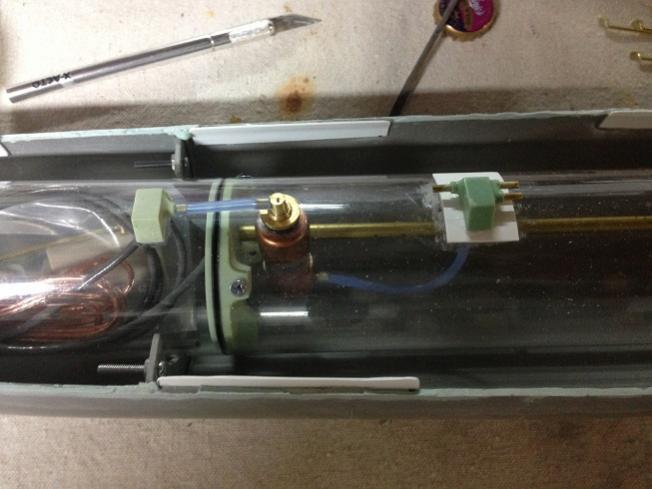

          All is well! Thank you so much David for your hard work converting this over to SAS for me. I sincerely appreciate it all of this!
          So, I couldn't help myself and put the SAS WTC into place just to see how it looks! It seems more real having it just sit there....like i'm actually going to get this done:) Spent the rest of the night with more boring sanding/grinding on filler areas. I'm hoping this week i'll finish up with the putty/lacquer combo (which i didn't even touch this weekend like i hoped).
ID:	89949Click image for larger version
ID:	89950Click image for larger version
          I'll have i'm sure a billion questions about how to fully hook this thing up (especially with the tower section and the snort ... that part wasn't covered in the DVD set).

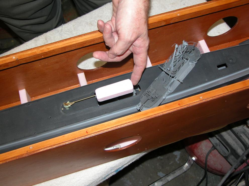

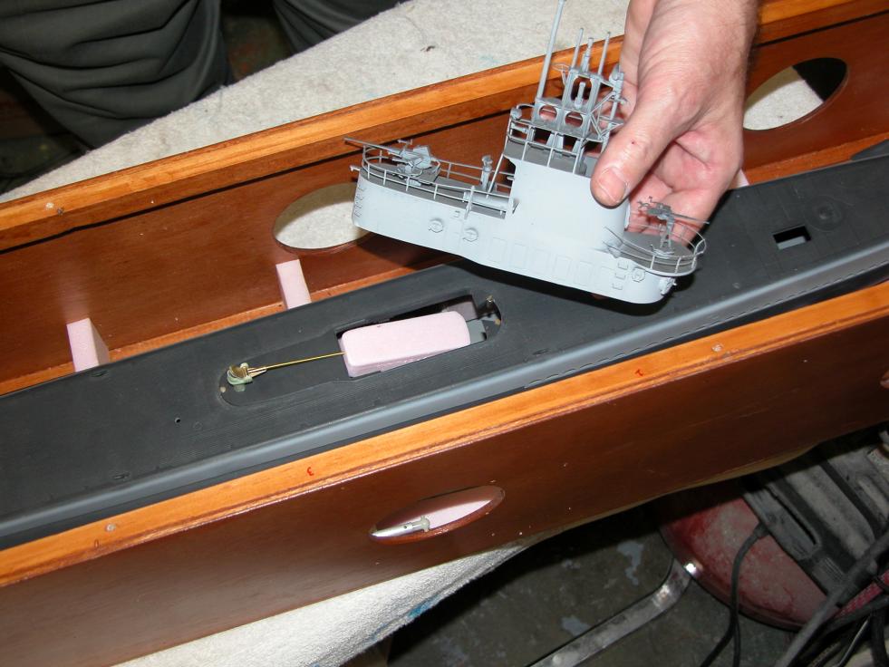

              Though the type snorkel head-valve provided with your SAS type SD is a bit different than illustrated, the below picture shows you how to arrange it on the deck. Note the cut-out under the sail to give clearance to the snorkels float.
              Yes, use magnets to secure the sail atop the deck.

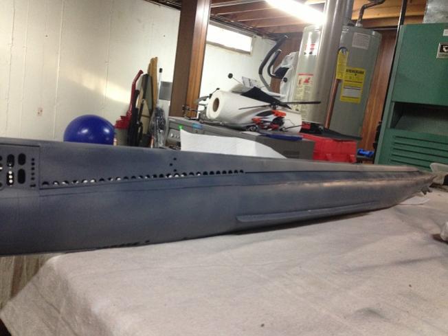

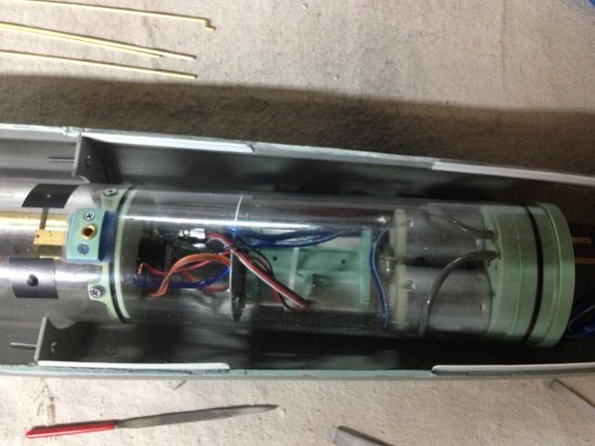

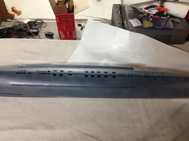

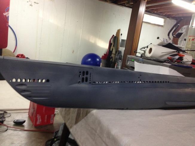

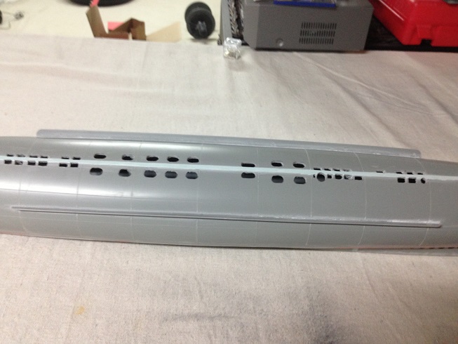

                            Whelp, i've got some updates finally. I didn't go through and do the tape/CA trick around the entire sub; just to some spotted areas on the sub with the main cuttline. That seemed to make a huge difference (was easier than that stubborn filler at times). As you might notice i also tried using some filler putty along the line as well, small improvements; but overall i think i have it fairly close so i'm moving on.
                            I've added the two pieces to the bottom of the hull, i forget the name of them; but i'm assuming they are to keep the real sub from rotating too much in the water?

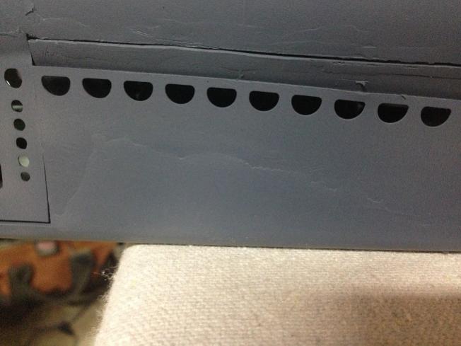

                            I've began priming the model, but when i started i realized that my stupid master airbrush is partically siezed up .... so thats kind of why the prime job is spotty. I had to manually control the paint amount instead of the double action control that i've been use to. I'm going to try to free up the brush some more tonight to see if it will work better; but i might be having to get a new brush (the stupid thing was only used once and when i was done with it...i had ran lacquer through it thinking that cleaned it out...apparently not). As you all can see, the primer has really shown how much of a ****ty job i did sanding down my fillers :( So i'll be sanding more for sure!
ID:	90121Click image for larger version
ID:	90122Click image for larger version
ID:	90123Click image for larger version
                            I still need to cut out the snorkel section of the top of the hull; but one thing i noticed was that the opening that which i would be cutting is in the way of one of the WTC cradles ... so i'm assuming that i just cut a chunk out of the cradle to make room for the float?
