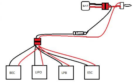

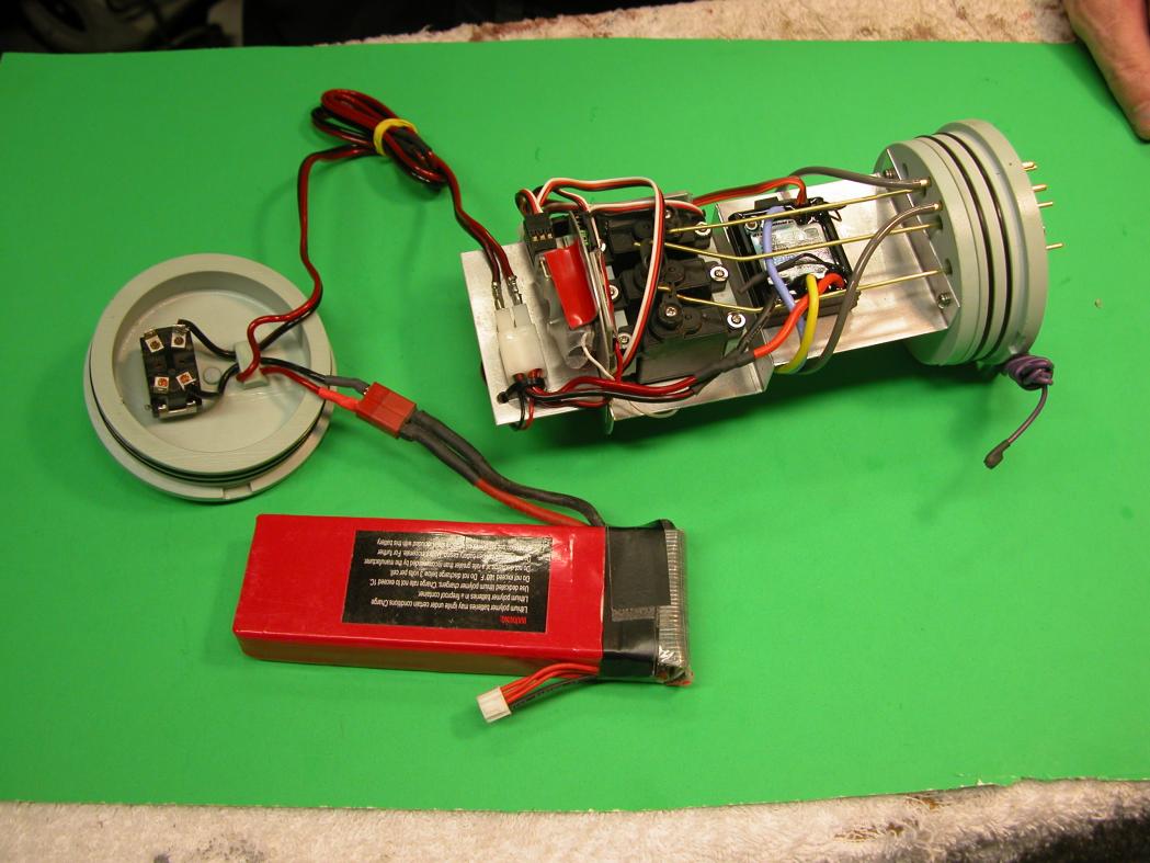

              #171
              So, I've updated my diagram to reflect what i believe David was saying. Is this now correct? Also, what do you mean by "Strain relief block?"

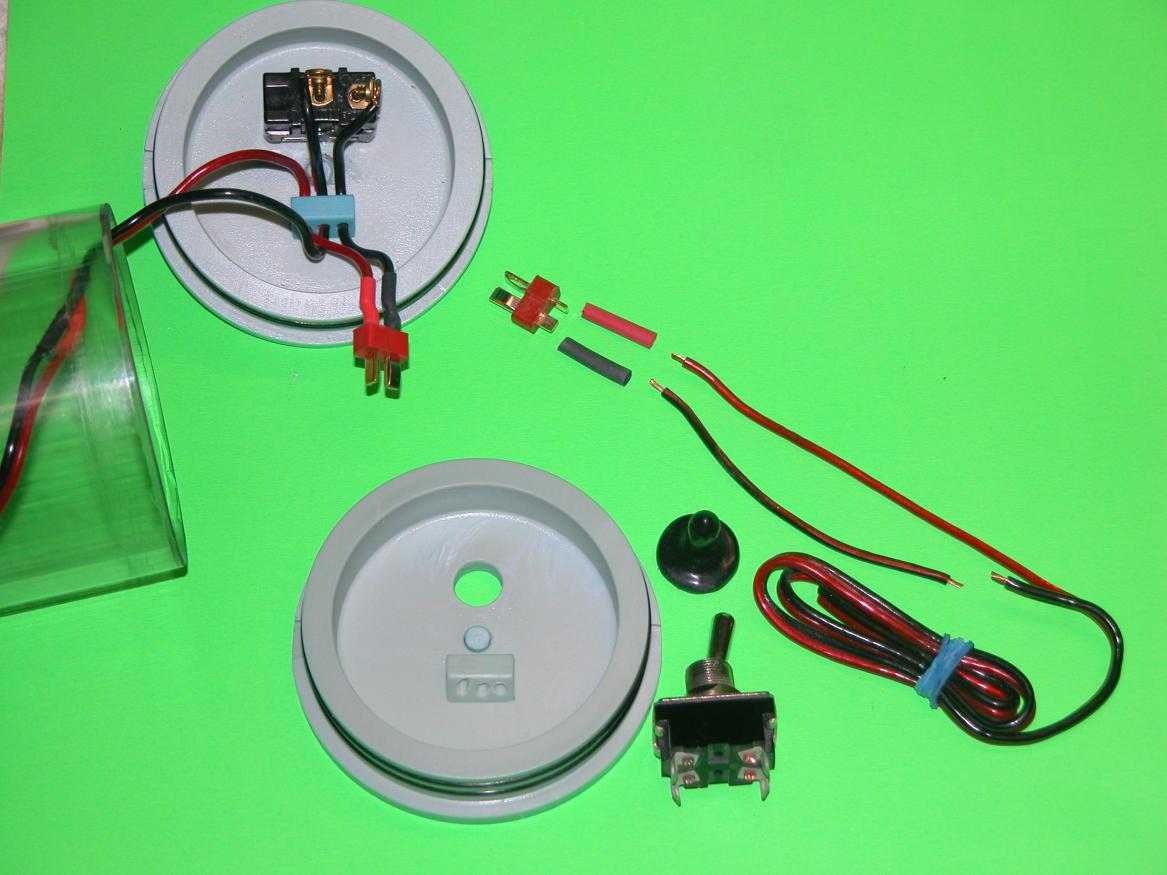

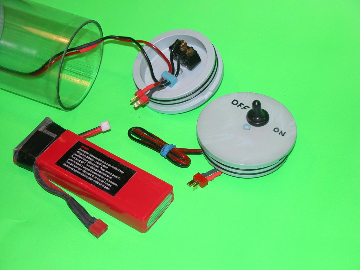

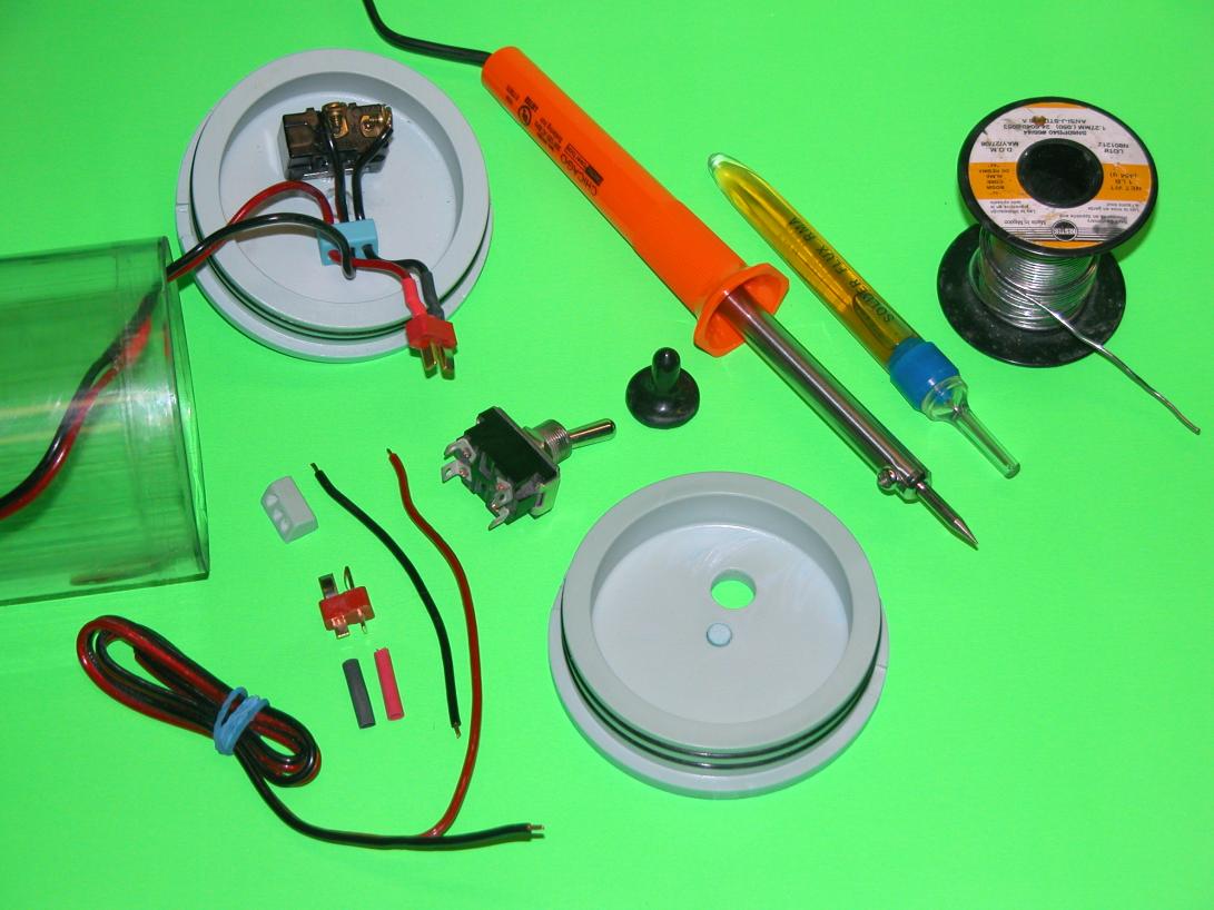

              Also, i'll post up pictures soon; but I finally just had to use a solderless connector on that one end of the red Dean's connector with my bundle of black wires from (ESC, LIPO, etc,etc) ... but that seem to go together nicely.

                #172
ID:	90458Click image for larger version
ID:	90459Click image for larger version
ID:	90460Click image for larger version
ID:	90461Click image for larger version
                The schematic looks good, Matt. Keep at it, pal.

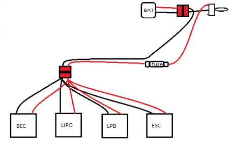

                  #173
                  I was a little confused by your schematic, you have a positive and Negative going to the switch. I put my fuse on the other polarity than the switch, so please indulge me as I modified your drawing. If this is wrong guys let me know because I have been wiring my subs this way and if I need to change I would rather learn it now than share bogus info.
                    • 14014
                    #174
                    Makes no never-mind which side of the battery the fuse is put, as long as it's in series with the battery.
