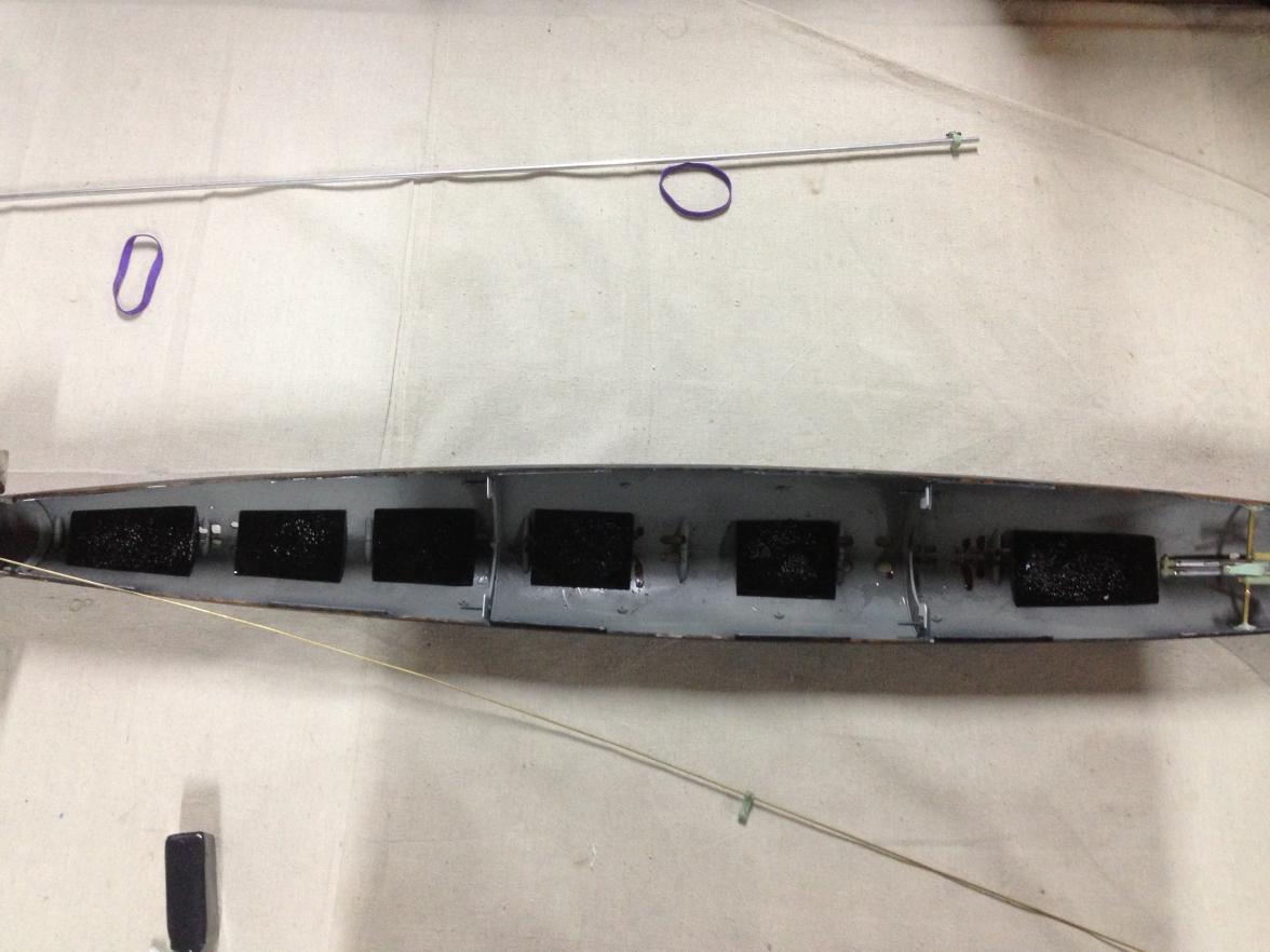

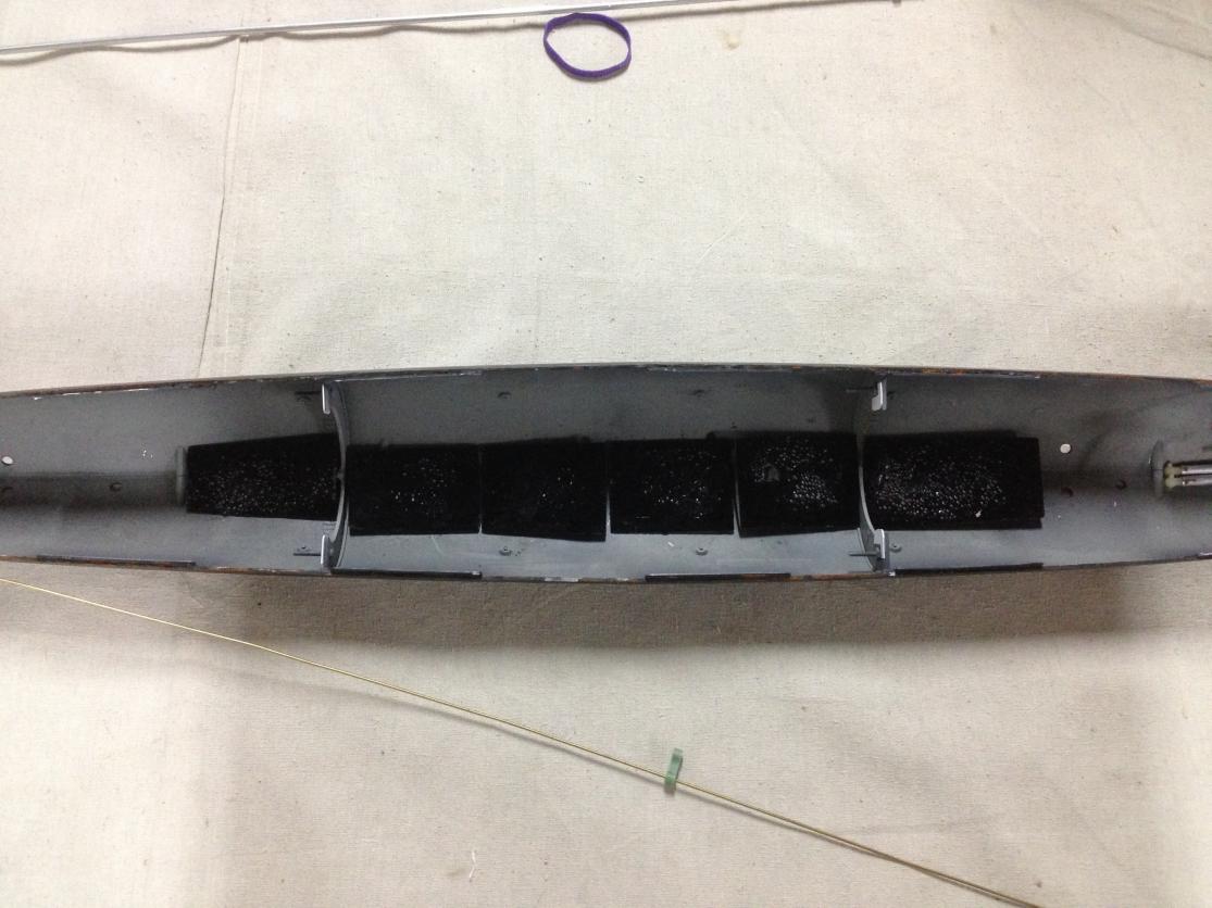

        lastly, i know that im suppose to put weight as needed but the weight and foam kit provided seemed like it had all the weights planned for a specific location are either of these approaches correct with the weight placements from the kit?
        1) wieghts back to back?
        2) weights separated but still in order by number

          Maybe too much weight???
          Always a possibility!
