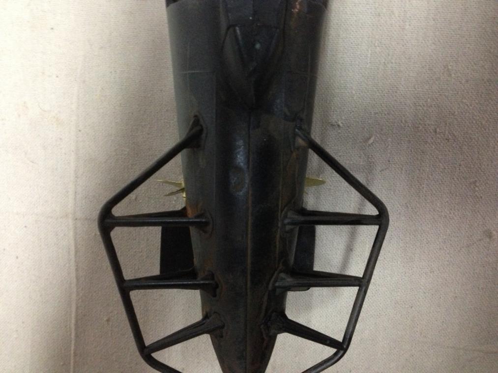

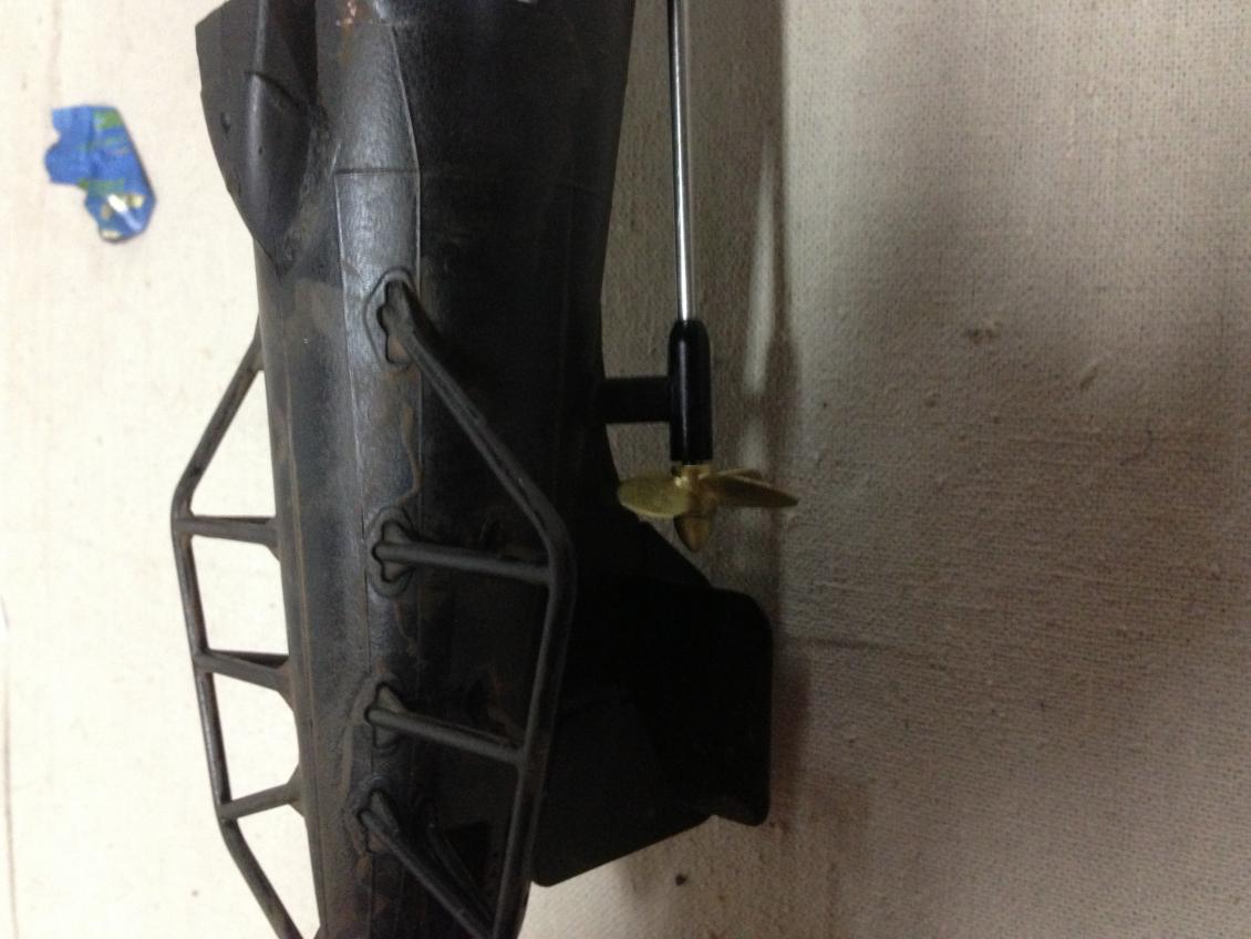

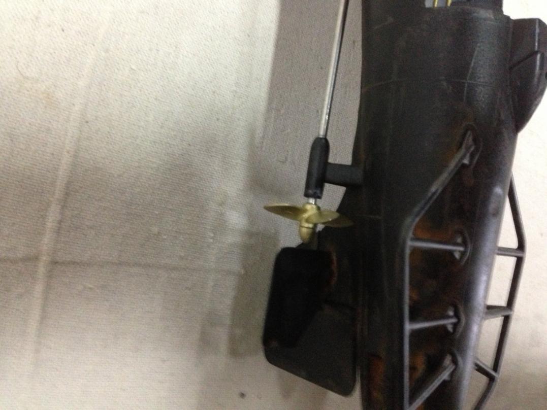

        Here are some shots of what im talking about. Im probably ok but figured id ask Click image for larger version

          Hiya, Matt!!
          Can you see what's preventing the prop shaft from going in any further??
          You may be able to just shorten the motor end of the shaft a bit so the prop hub
          sits right up against the strut tube.
          The way it is, it might create a little unwanted cavitation!? Not sure how critical that is with a model sub,
          but probably not a good thing with a 1:1!!
          CG

            I was an idiot when i put that first one one with the CA. Got too much on it and thats were it stopped lol. I just need to know if im going to really notice the difference of what seems to be less than an 1/8" difference in placement of the props. Im hoping not. As if i have to take that out it wouldnt be the end of the world but probably an hours worth of work (knowing that things wont go my way lol). So, if i should be ok with it as it is. I wont waste my time trying to gain back that extra spacing

              I have a CA de-bonding liquid that works really well!
              It does warn that it "may craze some plastics", but you can try it on a piece of scrap, first!
              It's made by "Zap", and called "Z-7 Debonder". Great for "adjusting" things made of white metal,
              but I haven't tried it on anything plastic yet! Softens the CA back to a "gel-like" state!
              Just a possibility!!

                Don't sweat it, Matt. It'll work fine. Looks like hell, but will work fine. Gary has the simple fix if you're a slave to aesthetics.

                  Sadly I have done similar though I use acetone, not the nail polish variety which i simply wicked via ann old paint brusharound the shaft and prop hub. to get the prop off the shaft once the ca is softened I placed the shaft in a timber block that is drilled to the shaft diameter then with the prop sitt I gently tap out the shaft with a small pin punch or brass rod. Than simply swish the extracted shaft in the acetone and clean with a fine green scouring pad.

                    CA breaks down in heat.
                    Take the shaft out of the model, put a pointed flame to the shaft, about three or four inches ahead of the hub. Eventually the heat is conducted through the shaft to the CA bond, which fails, and you slip off the propeller without damage or hurt feelings.

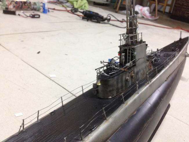

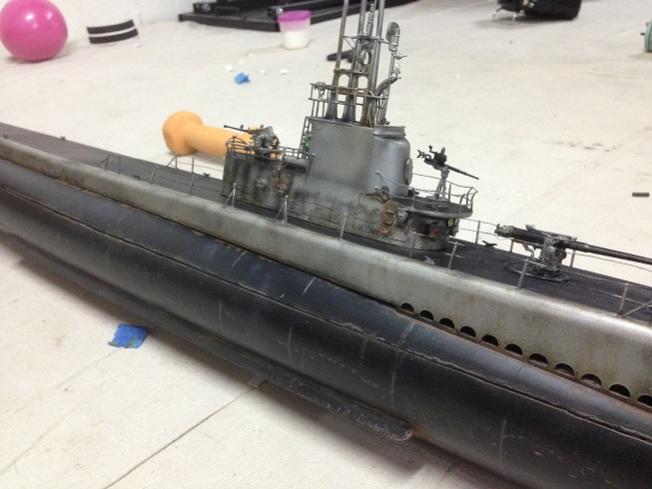

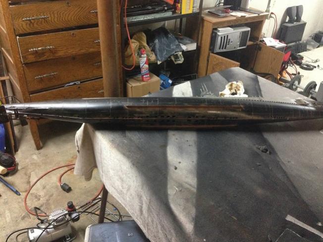

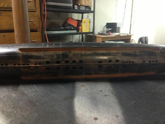

                        So, I realized that I never showed any pics of her underbelly. The rust really showed up well IMO (or at least perfect for what i was wanting).
ID:	91024Click image for larger version

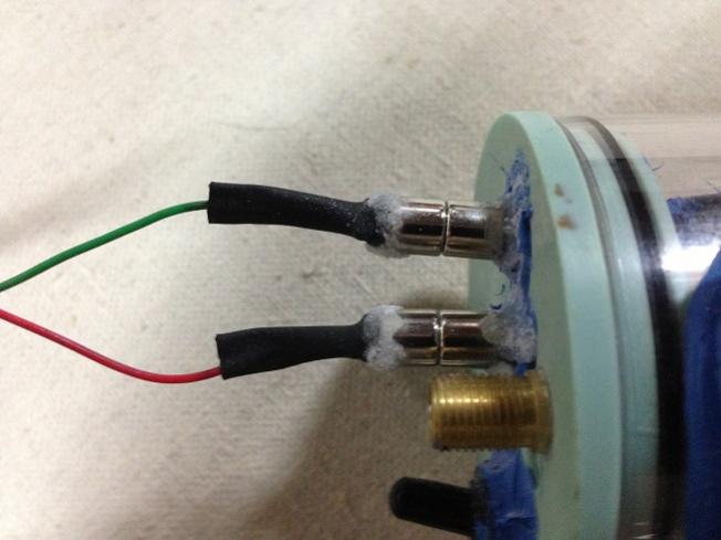

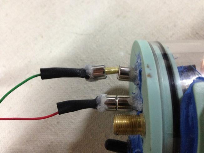

                        Now, let me show you what I did with the cylinder magnets. I was pleased with the disk magnets that I purchased earlier; but I wanted a stronger hold when it came to hooking up the current to my upper hull for the lights. This works out very well (later that night i coated the magnets with RTV for better hold).
ID:	91028Click image for larger version

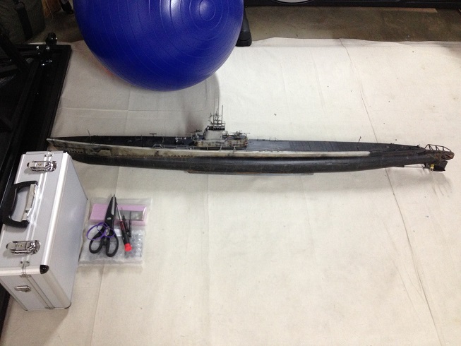

                        Tonight, I get her wet! I hope she doesn't sink like a rock the minute i put her into the pool. I'll bring my weights and foam kit that i purchased from Sub-driver.com along with me. Along with some rubber bands, hobby knife, and various tools for adjustments (plus some swim trunks and a towel).
                        Tomorrow, I plan on putting together its travel box (yes tonight i'm taking the risk of it moving; but the pool is very close to my house ...so i'll secure it nice and tight in the SUV). I'm just hoping the 24hr gym lets me use the pool for my sub at midnight lol.

                            Well I will be honest and say that the rust on the bottom hull came out better than I thought.
                            Good luck with the pool test. Don't forget a post mission report.
