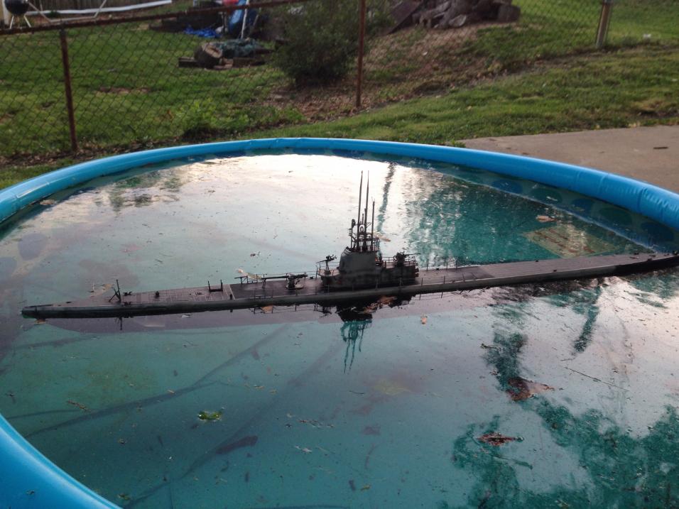

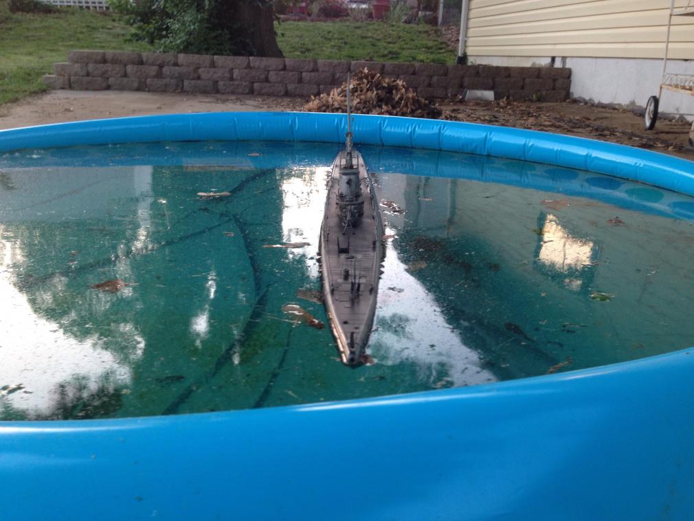

                                I've oiled the vent hole and set my binding to 110% and now she sinks again:)! Not sure WTH happened but that was it
                                attached is sub with a ****ty low freeboard and sinks like a rock. After about an hour of trimming the freeboard has doubled but still sinks like a rock and will not return after many minutes of LPB action. Im going to keep adding foam to get the freeboard higher and hopefully enough bouncy that fully vented her sail is more than half submerged
                                ive been using the pink fanboard foam used when siding a house. It seems to be working. Its just thin so im having to double up on the stuff
