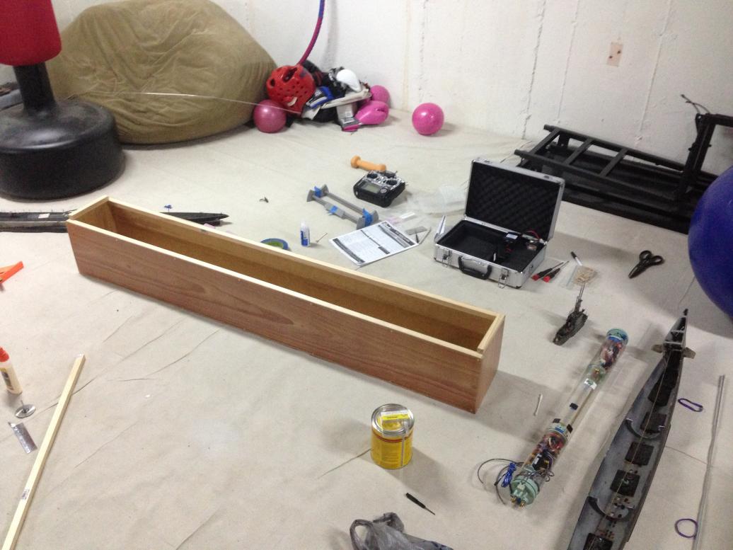

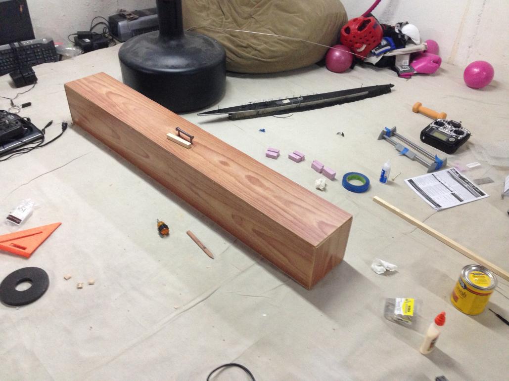

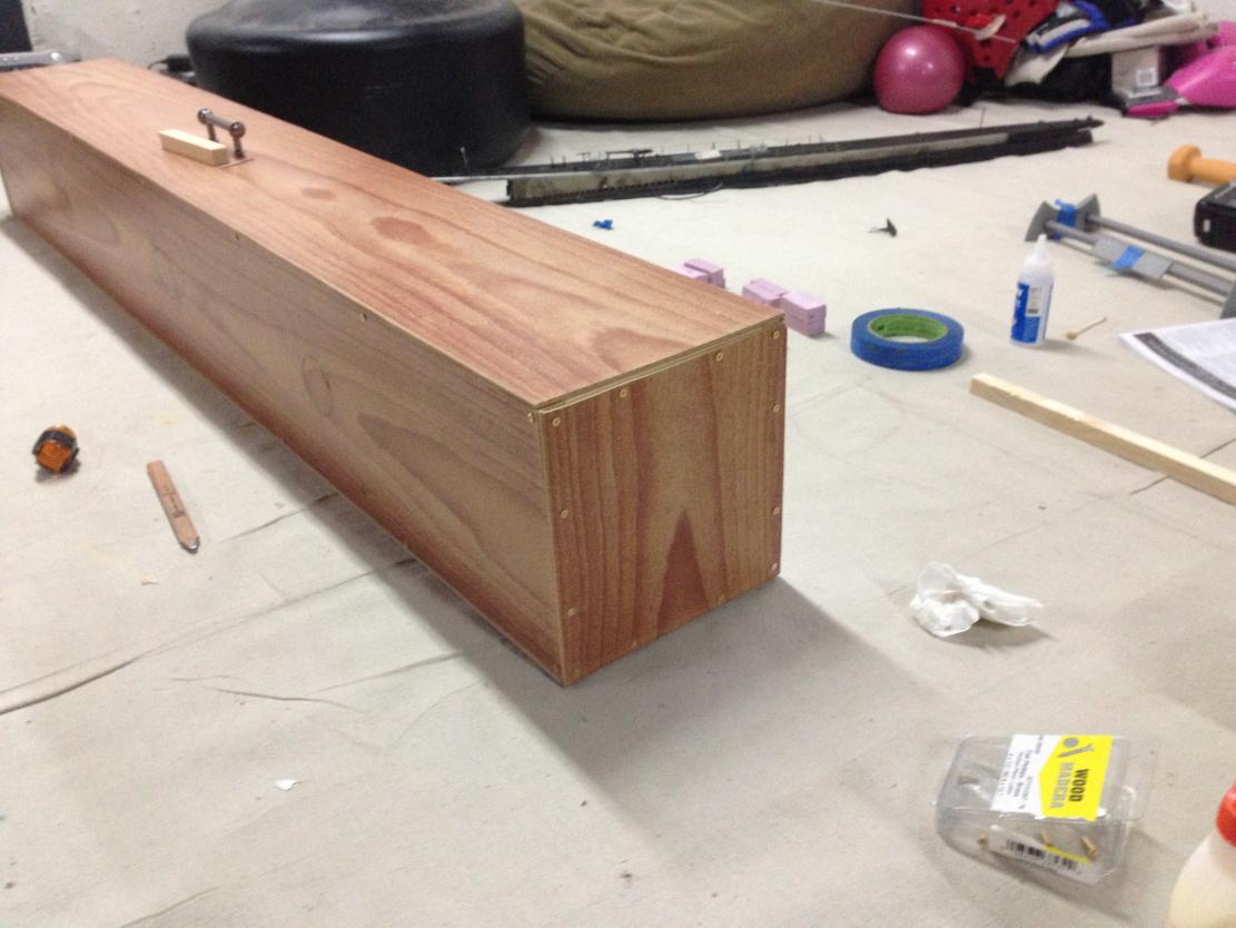

      While awaiting a new LPB ive been building my storage container. Nearly done with it. Just a few more adjustments to the top and cutting out the vent holes. Then ill fit it with some foam

          (nice box, by the way).
              lol thanks David!
