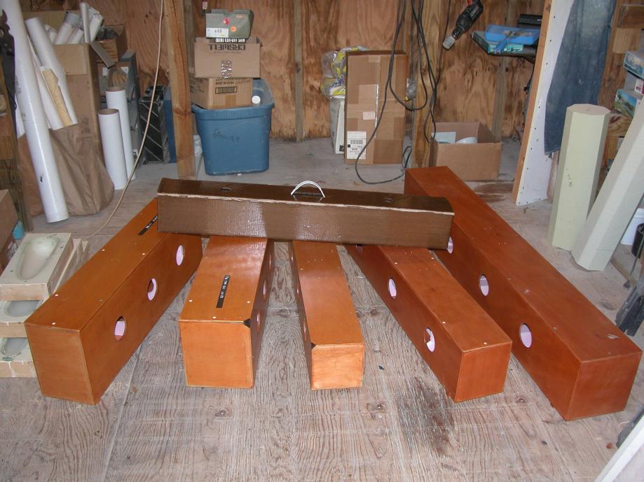

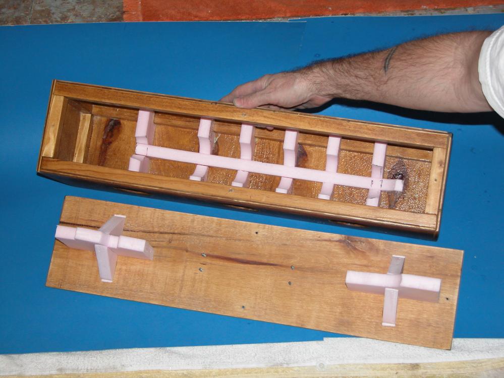

        Thanks! Ill be doing that. Say, what has everyone been doing with travel and storage boxes with their subs? Any tips on what materials to get, designs that work or dont, etc? Im getting close to getting this guy to the point of test sailing before my big paint job on it. I would like to start thinking about the travel box

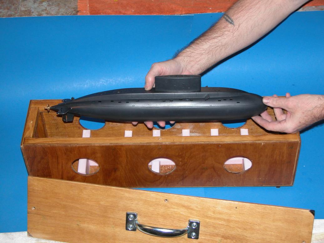

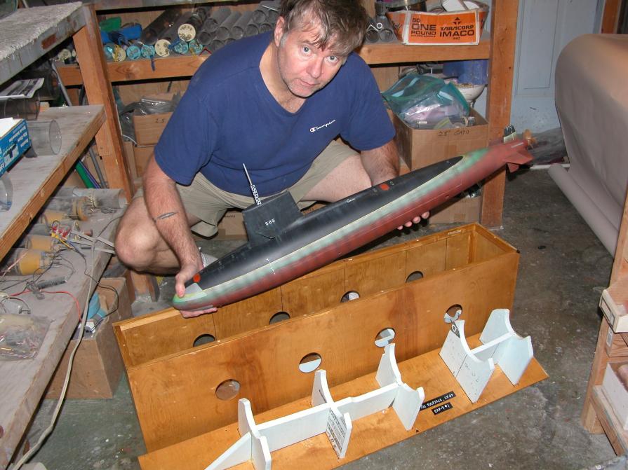

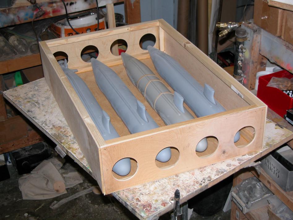

          Can't speak for everyone, but I'm partial to a stout storage-transportation box banged together from exterior grade 1/8" thick plywood with 1/2" square bracing. Foam sheet is employed as a custom fit soft cradle within the box that holds the model centered within the box.
          I've had a 1/96 AKULA, in its box, roll off the end of a moving van and not suffer any damage to the model. To date I have nearly thirty boxed models sitting around the house.
          Matt: you asked the right question. It's important to have such a box to protect your investment of time, talent, and money.

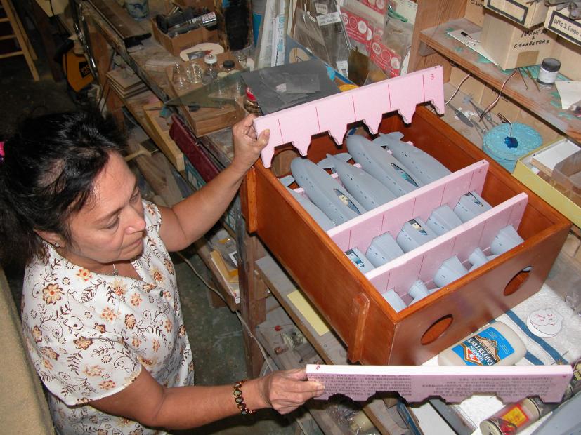

          Shown above is a little 1/144 Trumpeter KILO (you watching, Romel???) and its custom sized storage-transportation box. Next is Ellie showing how we first give from to the supporting foam then glue it to the upper box lid. And next to that I'm showing off a 1/72 SKIPJACK and its box. Note how the foam is glued to the bottom of the box lid -- when the lid is in place the model is safely cradled between the conformal foam pieces at the bottom, sides, and top of the box.

          Box construction is straightforward: crosscutting, ripping, nailing, gluing, band-aids, and some bad words. If I have to explain how to bang a wooden box together for you, then you, pal, are in the wrong game!

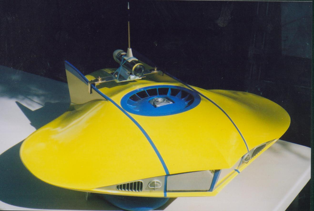

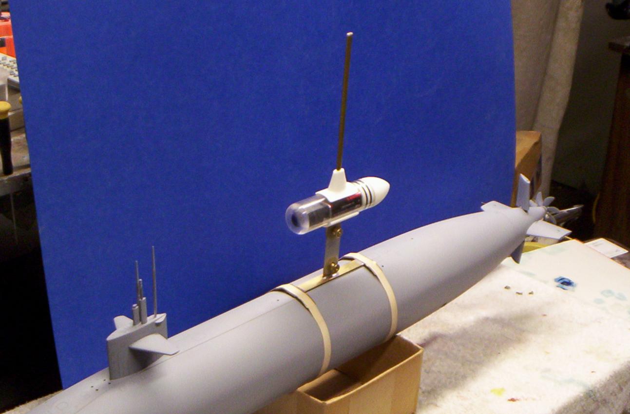

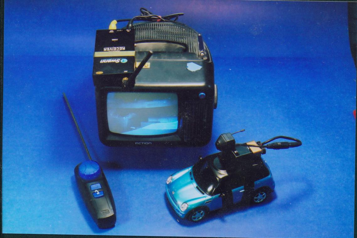

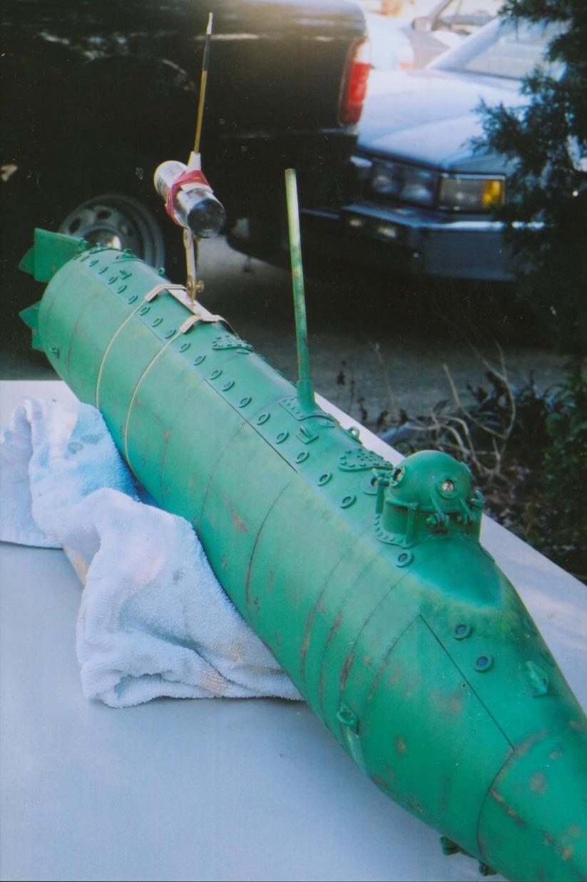

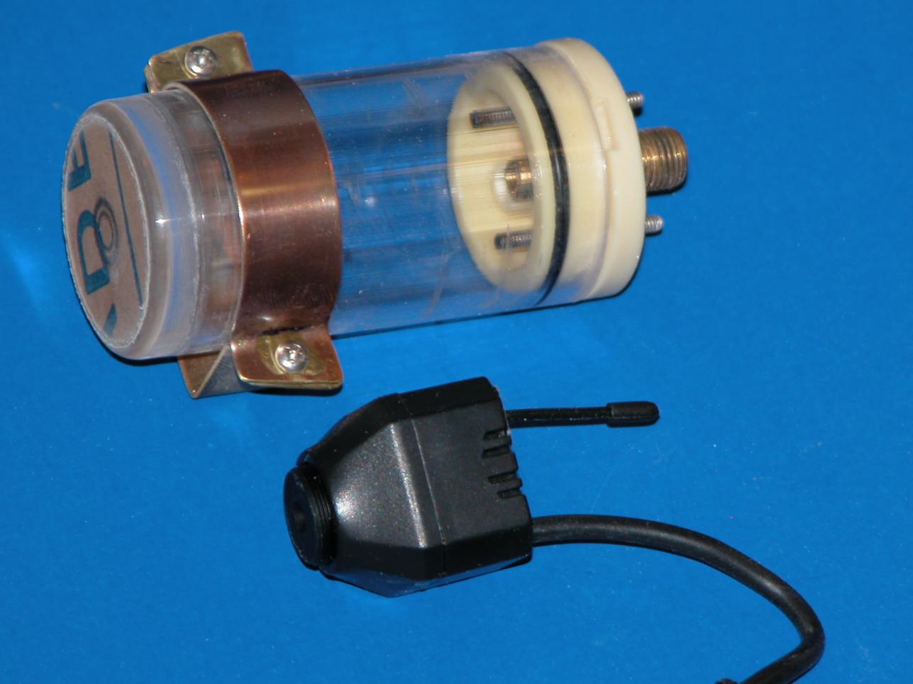

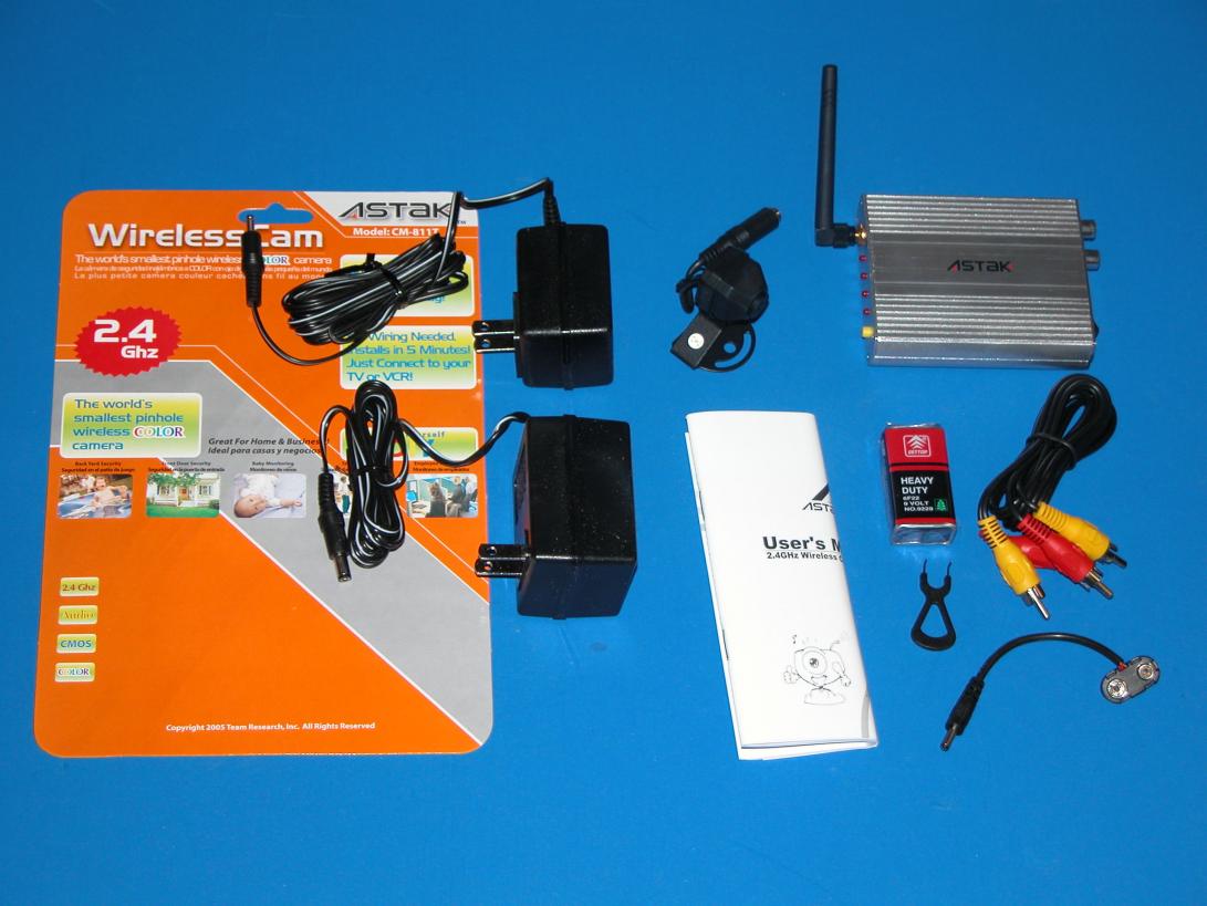

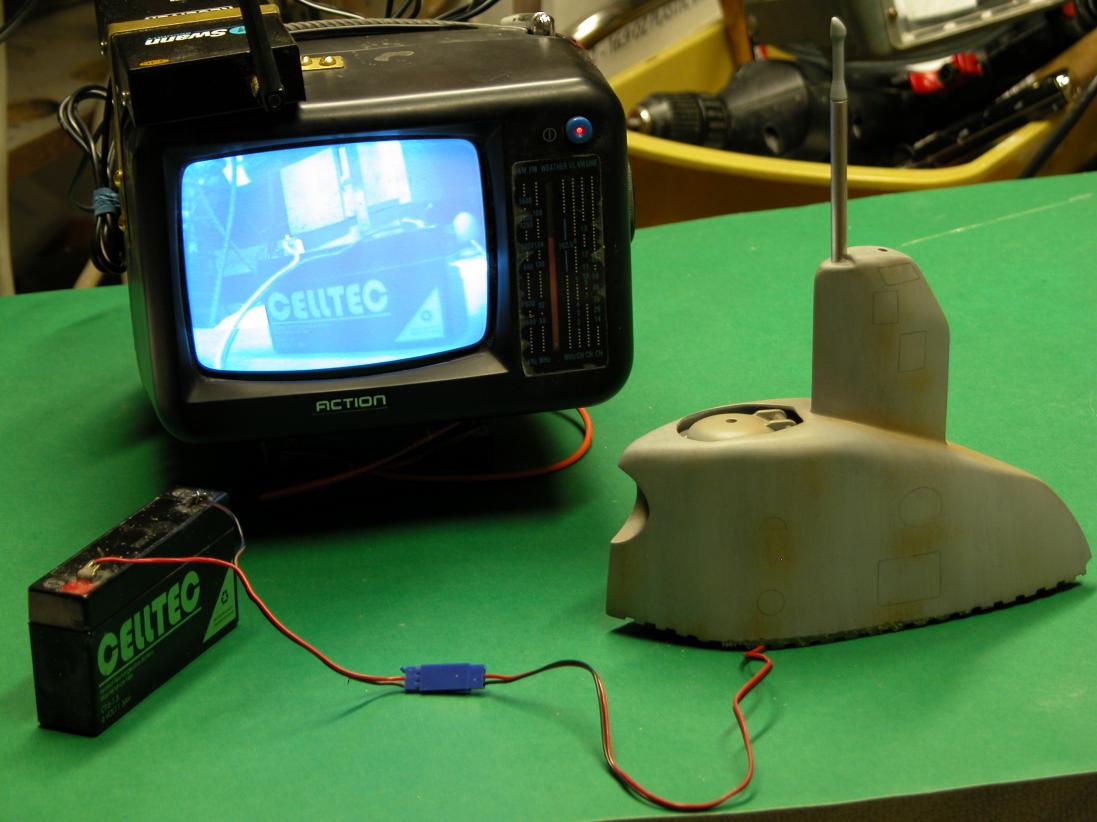

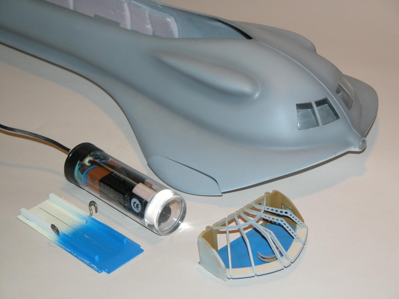

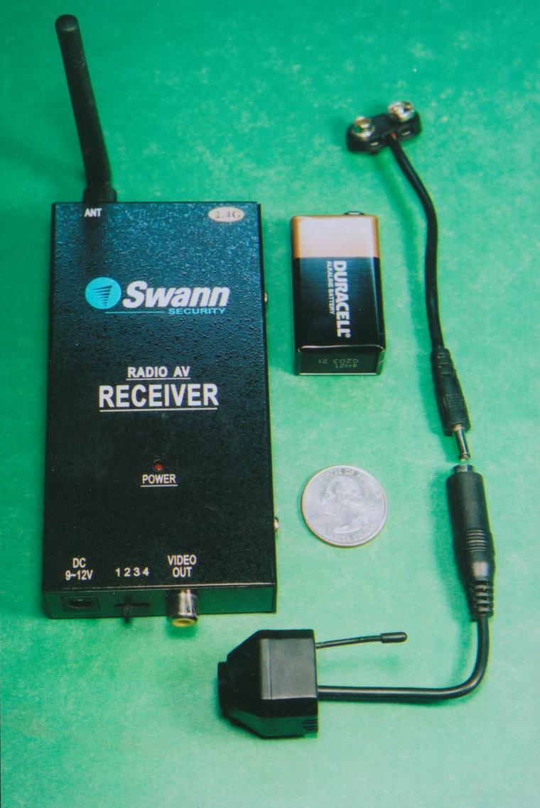

              Perhaps this is a silly question, but di any of you guys use an onboard live video cam with the subs or just the cams that record for later? What do you guys recommend?
                • 14013
                #262
ID:	90742Click image for larger version
ID:	90743Click image for larger version
ID:	90744Click image for larger version
ID:	90745Click image for larger version
ID:	90746Click image for larger version
ID:	90747Click image for larger version
ID:	90748Click image for larger version
ID:	90749Click image for larger version
ID:	90750Click image for larger version
ID:	90751Click image for larger version
ID:	90754Click image for larger version
ID:	90755Click image for larger version
                • matthewnimmo
                  • Dec 2011
                  • 271
                  #263
                  That is freaking sweet! So i was browsing the subdriver site but didnt find this camera system. Is this version discontinued?
                  • crazygary
                    • Sep 2012
                    • 610
                    #264
                    Hi, Matt!!
                    Check out Ebay!
                    Do a search for "wireless spy cameras", and be ready to have your mind blown!!
                    Some really cool stuff out there!
                    CG
