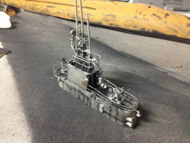

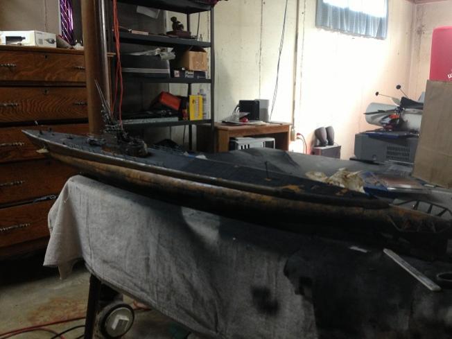

      More progress on the painting.

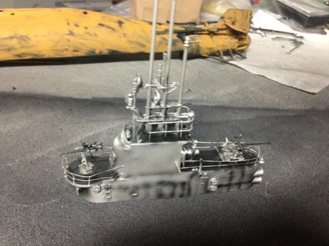

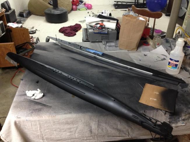

      1) Got all my base coats on (lot of flat black, silver, and steal)

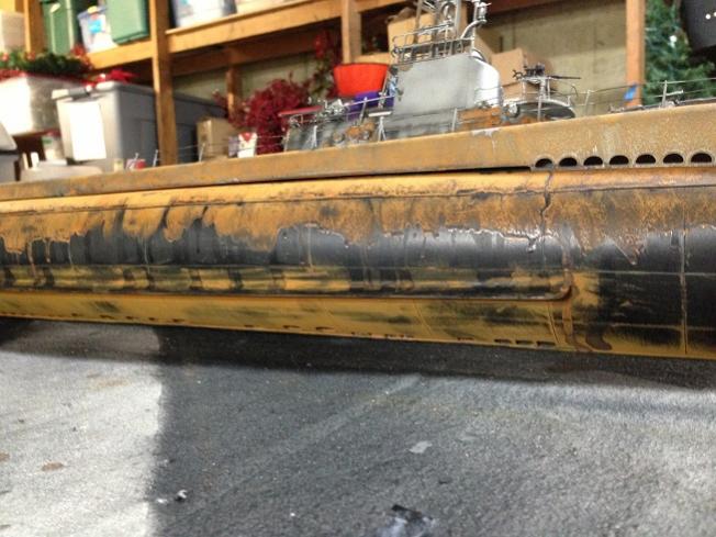

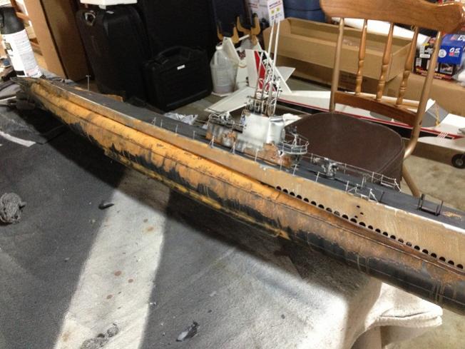

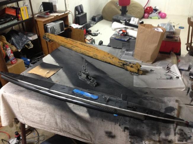

      2) Now, i know this looks a little extreme; but hang with me as it does get better:) I used my rust paint (which i activated via vinegar). Started with the entire bottom of the sub. The bottom will have a lot of rust for sure. When it finishes drying, I will go over all of it with steel wool to reduce the rust foot print.

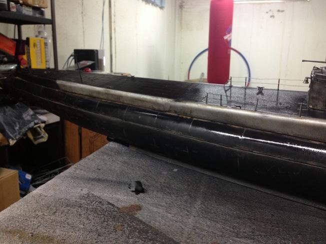

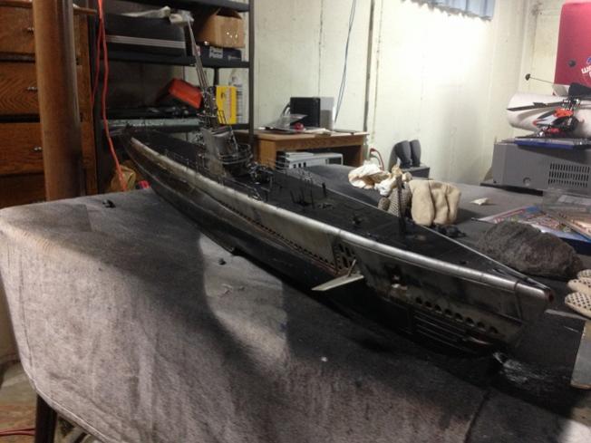

      3) Added darken'd areas to the sub due to stress/oils/etc over time. plus adds more depth to some areas that have nature bends/raises to.
ID:	90904Click image for larger version

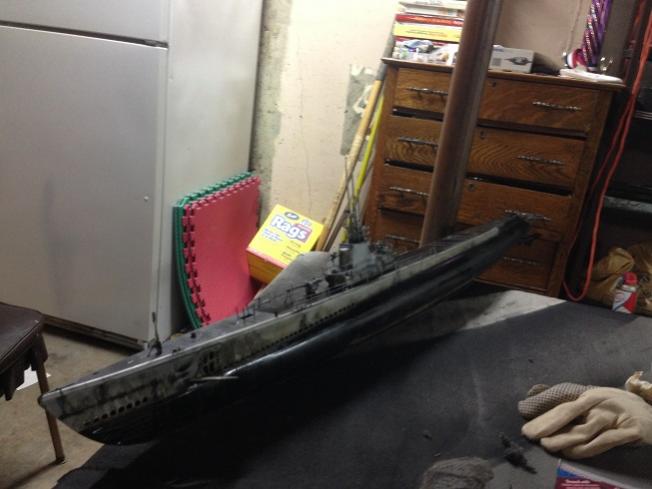

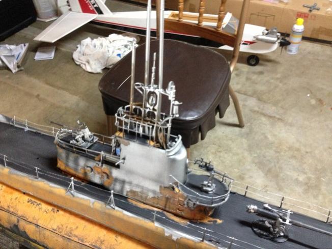

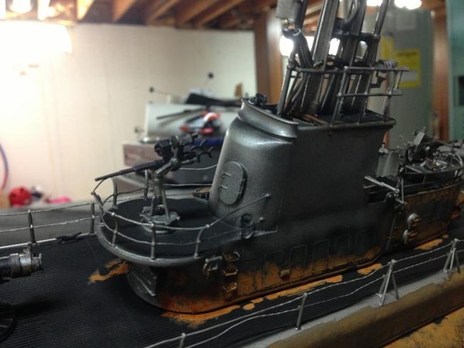

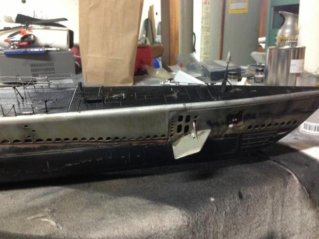

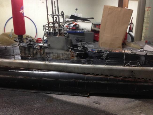

      4) Reattached the top of the hull to the bottom (i've evened out the rust on the bottom "which I'll show later when all done"). Now, what you all see is the first stages of rusting on the top portions. Yes, it will look worse in the beginning until i'm done with it. Also, you may notice some runs on the sides ... that's because before i applied the rust i went ahead and applied a lacquer wash on each side ...allowing it to run down the model (this created nice channels for my rust to follow and pit in the small areas with some nice dark colors).
ID:	90906Click image for larger version
ID:	90907Click image for larger version
ID:	90908Click image for larger version
ID:	90909Click image for larger version

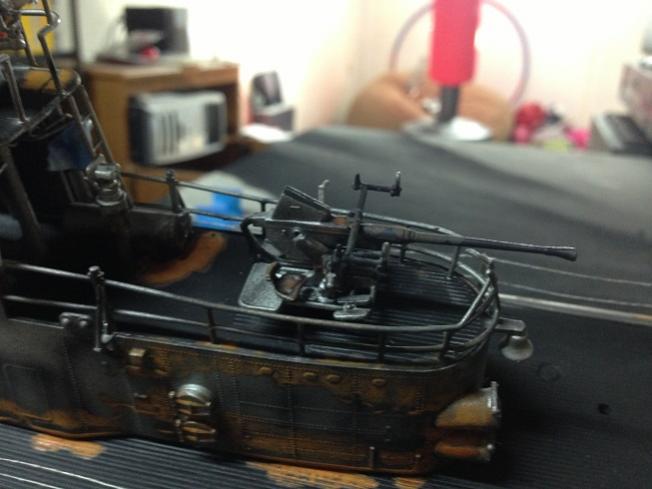

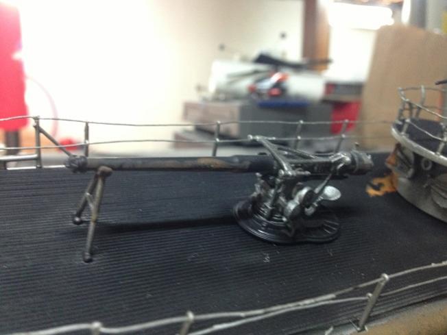

      5) Some details of the guns
ID:	90911Click image for larger version
ID:	90912Click image for larger version

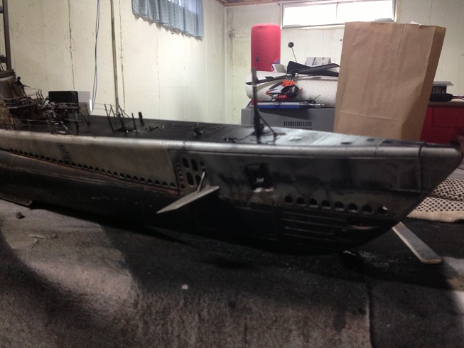

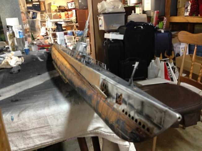

      6) Model has been reduced down via steel wool from rust and first coat of flat clear coat applied. Next step will be to go over and add other weathering smaller details with other colors. I plan on using some ground up pastels that i'll lightly paint on to specific areas for some greens, browns, etc.
ID:	90914Click image for larger version
ID:	90915Click image for larger version
ID:	90916Click image for larger version
ID:	90917Click image for larger version
ID:	90918Click image for larger version
      It's getting there!!
