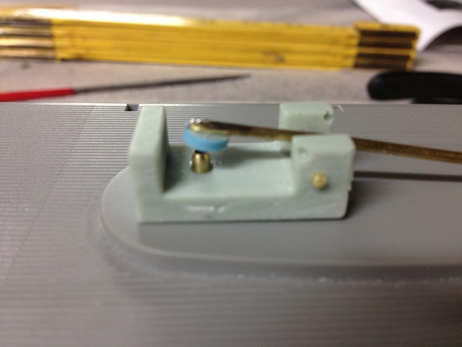

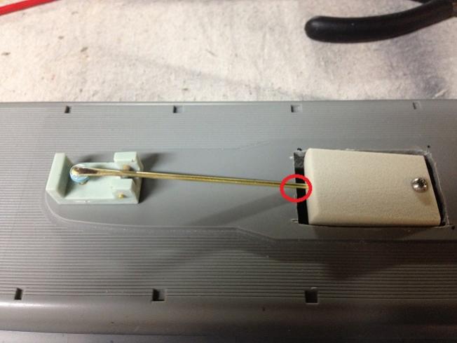

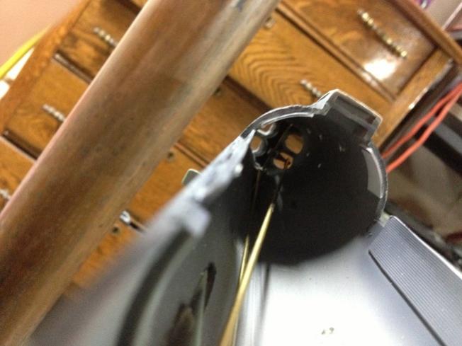

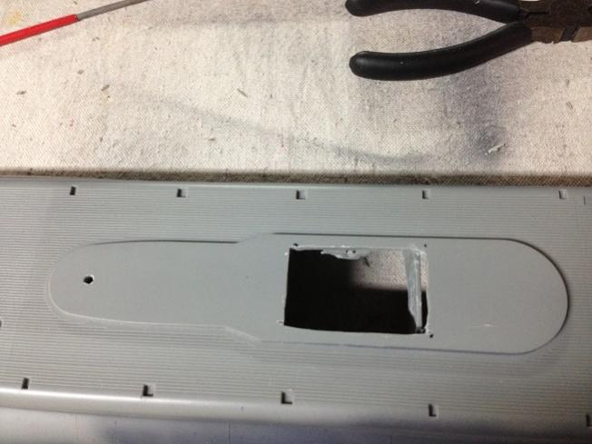

        So, i just took these now as i finished cutting the hole for the snorkel for the SAS system. I think i have enough clearance, just needed to shave a little off the face of the cradle and around the sides after the initial cut to make sure i had enough room for the float to move.
ID:	90129Click image for larger version
        As you can see the float is stopped by the side wall circled in read; but the next picture shows that the hole is open ... i think that should be good yes?
ID:	90127Click image for larger version

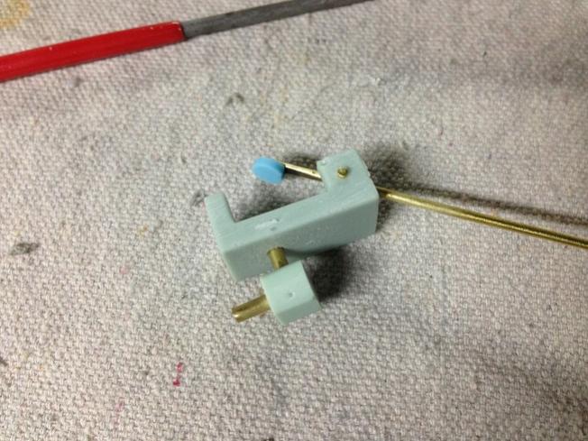

        Few questions
        1) Do i CA down the main resin piece to the upper hull? I'm assuming that i do and if i need to remove for whatever reason i can just take out the pin thats holding the float in place.
        2) This bottom piece that fits on the underside of the upper hull ... do i use RTV on the piece or just keep it as it is since its pretty snug hand fitted?

          The after edge of the hole you cut out is a good 'stop' for the float arm, as it appears that you have at least a 1/16" gap between the induction nipple and the rubber element with the snorkel head-valve in the 'open' condition. Looks good.
          Use RTV between the upper face of the 90-degree elbow, and the bottom of the hull. This will sandwich the head-valve to the upper hull, so there is no need to glue it to the deck. But, if you still want to glue it, use RTV so you can pry-things apart later as CA will require low-yield nuke's to break the bond should you want to service the head-valve sometime in the future.
          Good looking stuff. Keep at it.

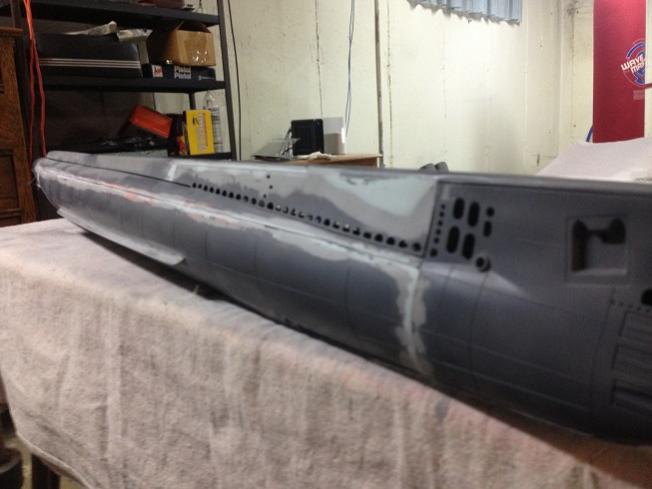

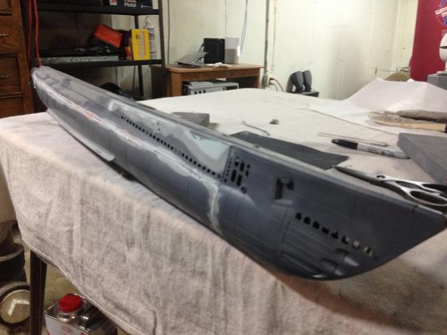

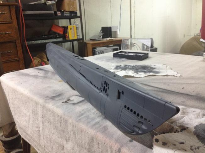

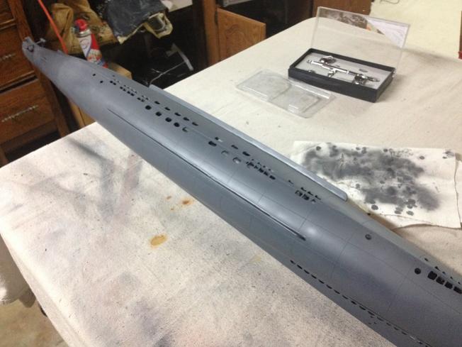

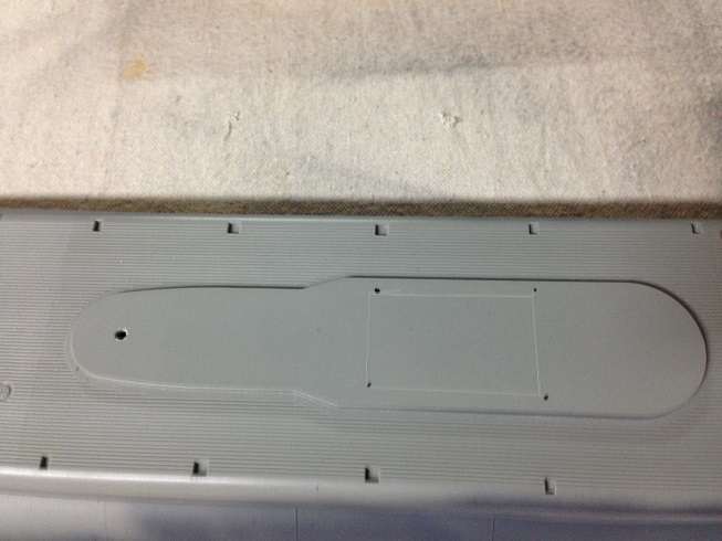

                So, i think i fixed a lot of my ****ty filler work.
                more sanding
ID:	90220Click image for larger version

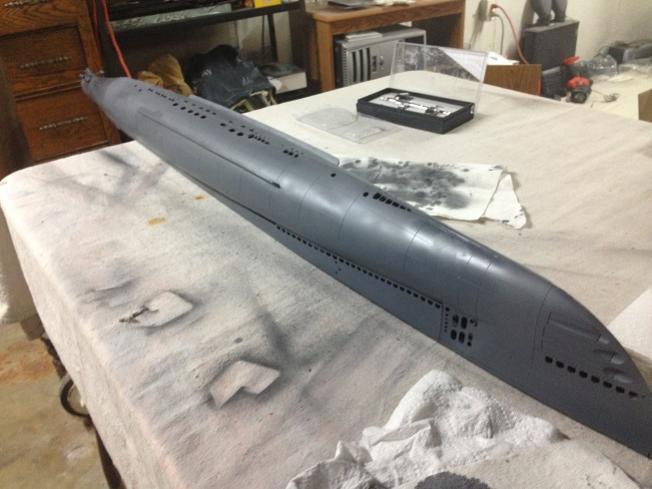

                Then re-primed
ID:	90224Click image for larger version
ID:	90225Click image for larger version
                It still not perfect (as i see still some ****ty filler work; but i keep telling myself i'm going to weather the crap out of it ... so i think it'll be ok)

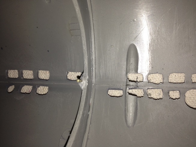

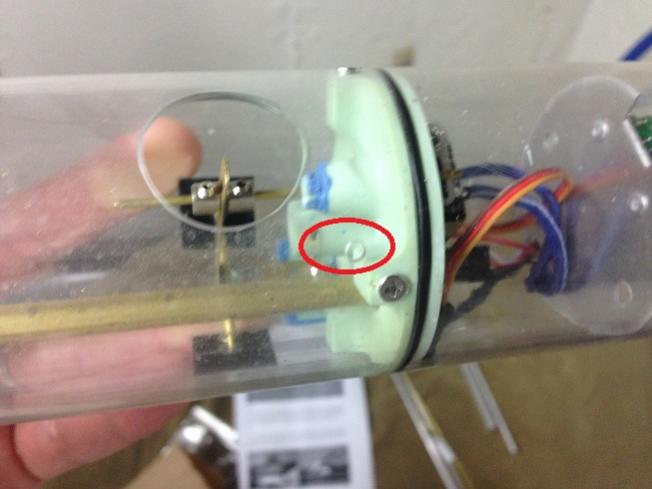

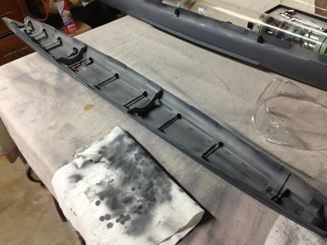

                Question thought, so the next step is going through all the control components and before doing that i was trying to decide were the indexing pin is going to be. According to the DVD set the indexing pin location on the WTC is right before one of the large holes on the bottom of the WTC closest forward. But, on the WTC i see there is only one potential hole for an indexing pin right after the large hole and not directly on the bottom ... instead it is slightly to the side. Is this my indexing pin location? See picture below.
                Thanks everyone,
                  • 13968
                  #143
                  No. That hole is to run an Allen-wrench through to adjust position of the blow-valve (if used). Indexing pin position is not critical -- just as long as its under the ballast tank.

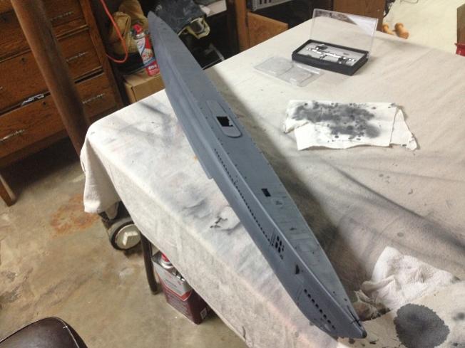

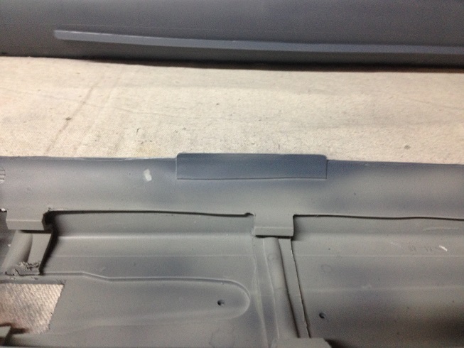

                            Progress!
                            I believe I'm done priming everything, including the indexing tabs
ID:	90292Click image for larger version

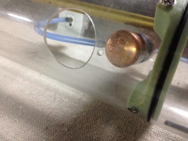

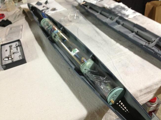

                            Got my indexing pin in. Also drilled my index pin hole within the WTC and of course test fitted everything. Seems to be fine and hopefully balanced enough
ID:	90294Click image for larger version
ID:	90295Click image for larger version

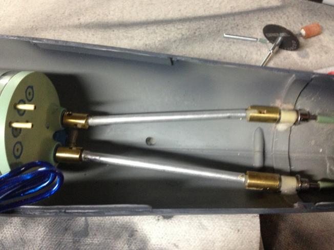

                            Lastly, built my dog bones for the drive shafts and test installed them. They seem to be fine. Got my prop shafts reinstalled along with washers (that are a lot larger in diameter than i thought they would be; but seem to be working fine ... but i guess i'll know more when i actually apply power to the motors and turn the shafts that way instead of free handed).

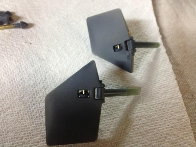

                            Edit: forgot that i secured the brass rods for my bow planes
                            Hoping to get the rudder and planes installed tomorrow (not quite sure on how long to make the brass shafts for those control pieces....figured i needed to get my WTC placed were i wanted and then do some guestimations from there.

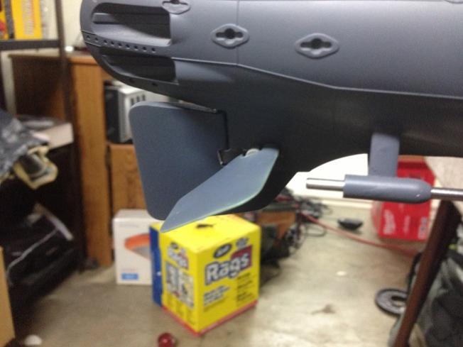

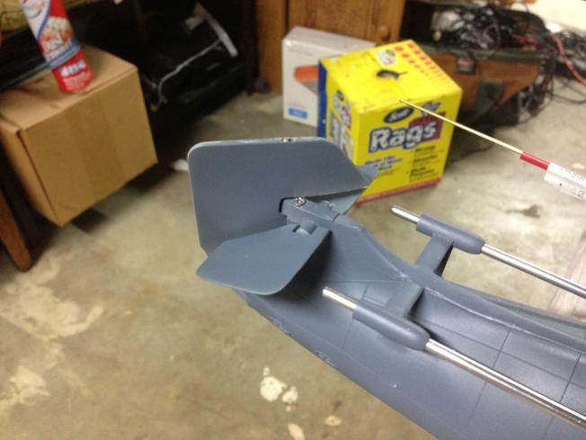

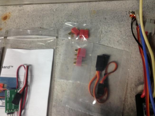

                                Ok, some progress made. I've got the rudder and the sterin planes in place! But, I have many questions about the electronics kit #1 that i purchased for the gato.
                                First, see the progress

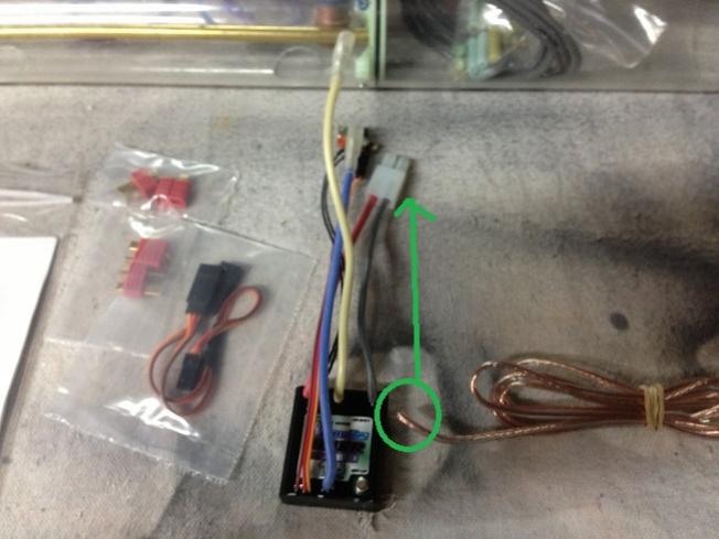

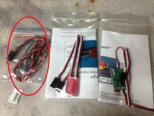

                                Now the questions.
                                1) What the hell is this for? If this is the BEC, do i need it if the speed controller has one built into it? And if i need it how does it fit in?

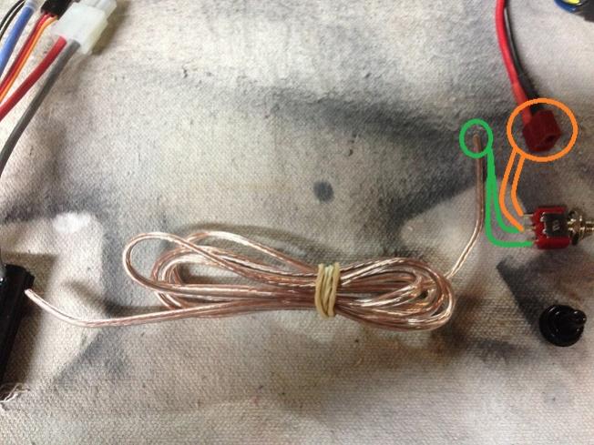

                                2) How do i handle the switch? I'm assuming that I make some connections like the ones in demo'd in the picture below using the supplied red connectors?
ID:	90368Click image for larger version
                                3) I'm assuming i use a Tamiya connector for the other end of the wire to connect to the speed controller?
                                4) I believe I understand the angle keeper (simply connect the sterin plane servo to it and then the angle keeper to the receiver), but what about the lipo guard...how does that come into play? And then the Y connector, were should I use that?
                                *Lastly* 5) I want to add lights like Trout did with his Gato, what other arrangements do i need to buy and connect up to the electronics ... and were?
                                Thanks everyone, being going over this for a while before i do too much soddering
