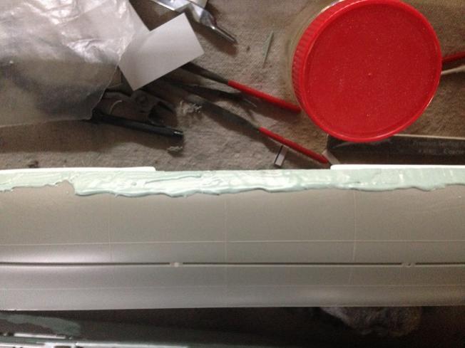

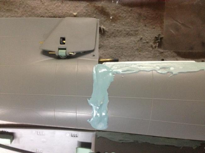

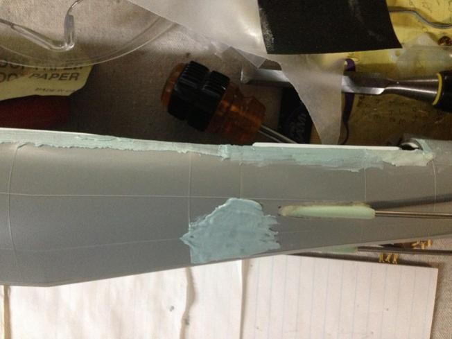

          Still in the filler and sanding stages. I kind of liked what Tom had done with his build (applying some blue filler just over his cut line on the hull and sanding/shaping that down). I'm still new with the fillers...so i might have applied a little too much in some areas which means my sanding/filling skills will only get better.

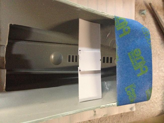

          Also, you will note the white piece of plastic i've used on the back end of the model (used for stability of that structure). The problem is that the upper hull is slightly bowed out on that side after the seperation of the two parts ... so i reduced my original strip and glued in the middle piece to secure the reduction.

          I only did one side of the model....this way the next day I can grind/sand everything down and see how this approach worked .... when i find out my problems i will make sure i don't repeat them on the other side (so i can leave room for completely new problems later one).

            You use masking tape to prevent paint over-spray. Do the same when you gop down the filler or putty: Apply masking tape to adjacent areas of the work you don't want the goo to mess up; lay down the goo ... and for Christ's Sake!, use a damned putty-knife for better control; and immediately pull away the masking tape. Less clean-up later and/or obliteration of surface detail.

                          ill post up some pics tomorrow for sure of my progress. Perhaps im just being overly anal about my cutline in trying to make it perfect. So, no matter what i do i always end up with some jagged lines after the filler. They are not drastic but enough to annoy me if i look up close enough. Id like to get the entire cut even, smooth, and nearly invisible after the model is together but that is freaking tough

                            On one side at a time, either the upper or lower hull, don't matter, sand the edge perfectly flat with a sanding block; lay a strip of wax paper over that edge; slather on some filler to the edge of the other half-hull; mash the assembly together and wait for the goo to cure. Pull apart ... wa-la! Perfectly straight edges with a clearance of a c-hair! Actually, the gap is equal to the thickness of the wax paper (which is removed after the operation). Don't forget to apply thin CA to any fresh filler work -- it prevents chipping.
