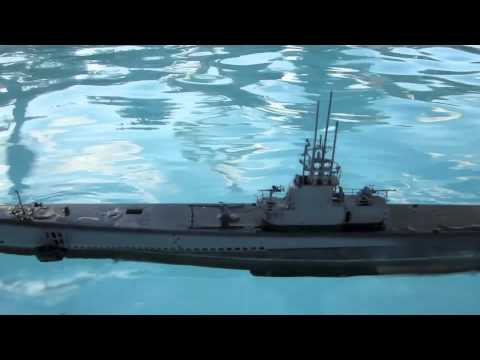

    I am thinking you need more lead and foam in it. That will reduce the tip you see, look at this video
    of the Gato on the rise at about 1:53 you will see a slight tip to port. It used to be a lot more pronounced, but adding more weight and foam reduced it.

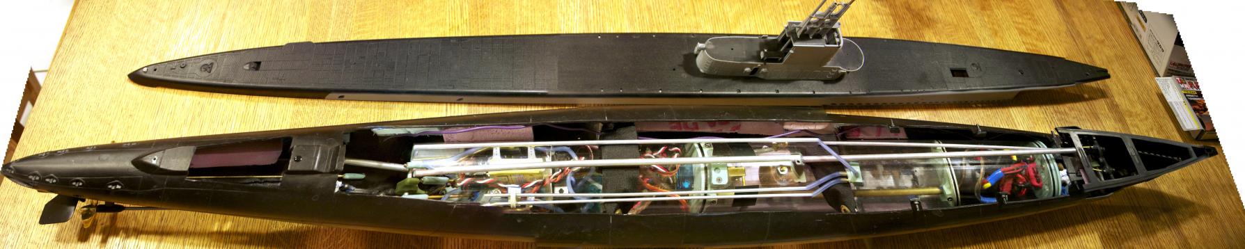

    Here is the inside of the Gato this is before foam, you can see there is a lot of weight.
    With most of the foam in.
