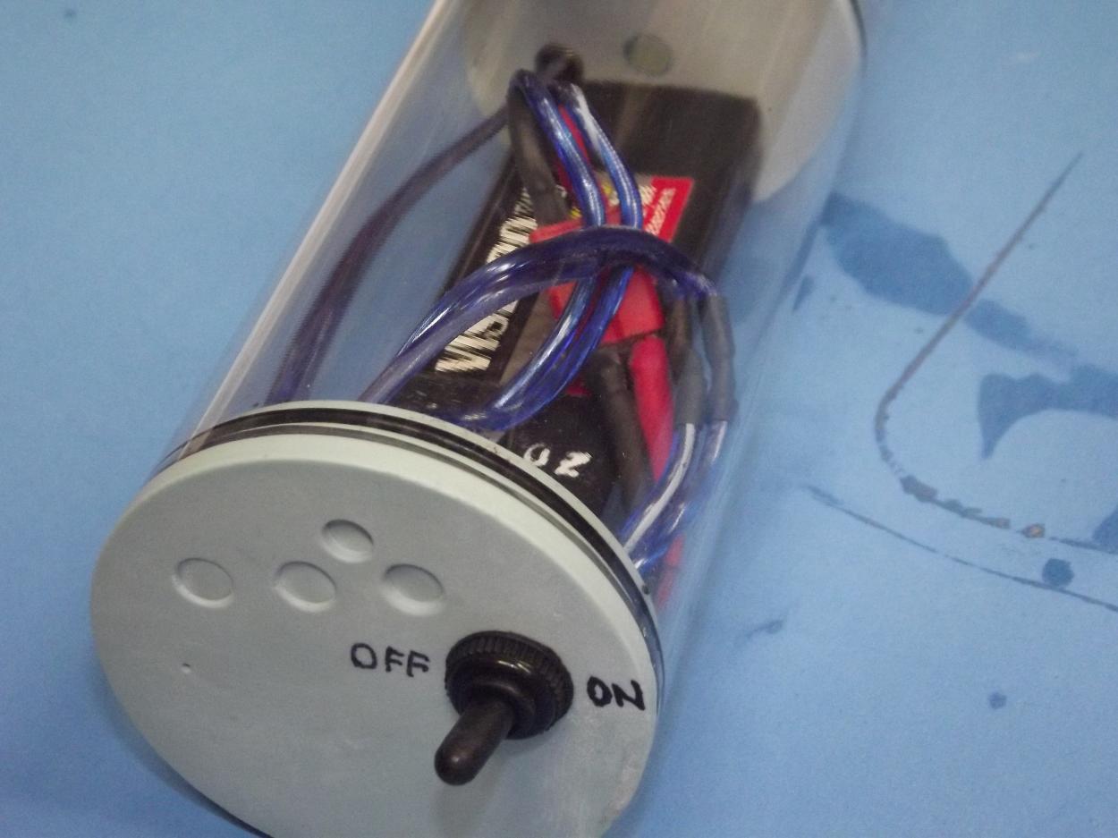

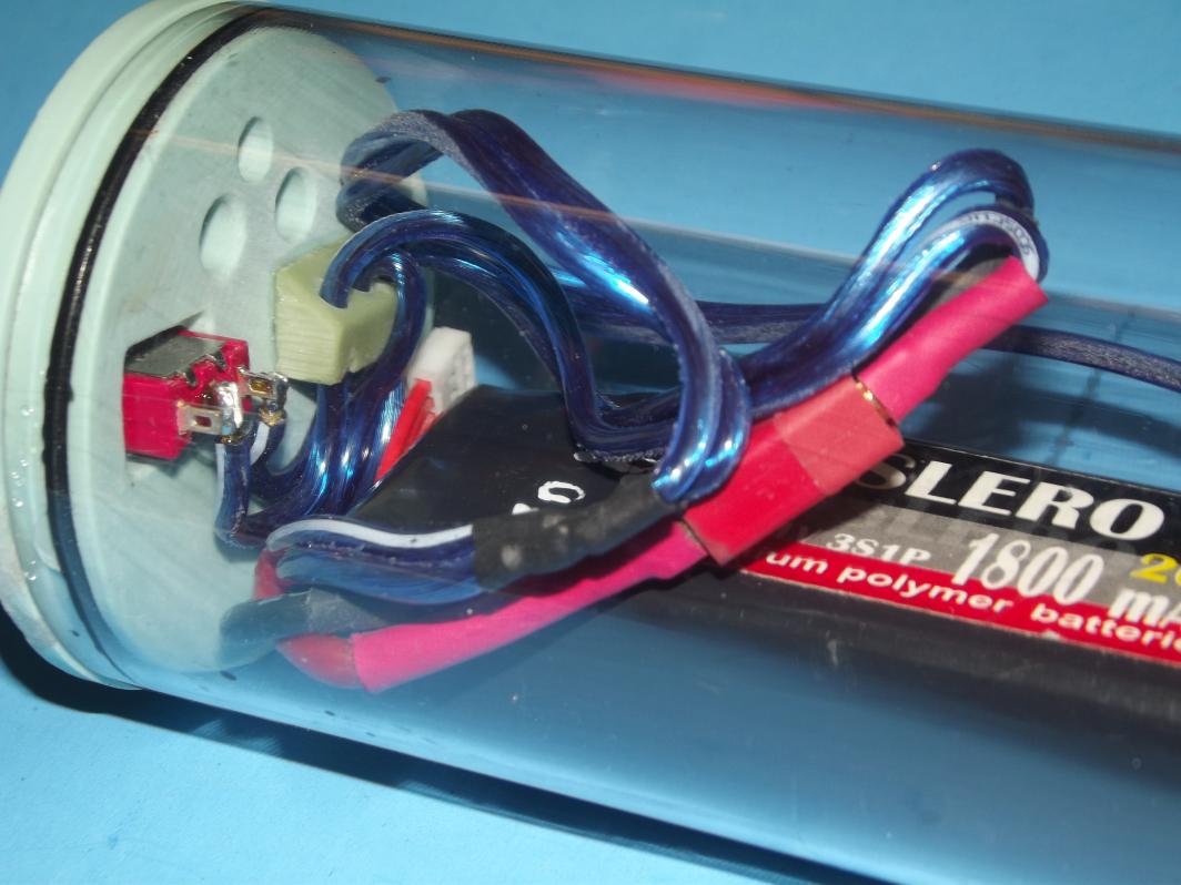

          Do it like this:
ID:	90500Click image for larger version
          (still looking for better photos, Matt).

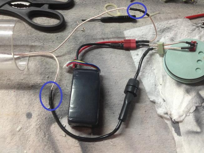

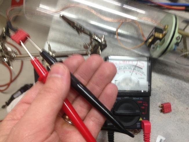

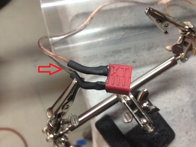

                #202

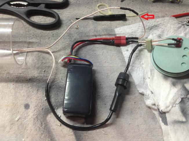

                Ok guys, here are some pictures to describe everything just to be super clear before testing any further.
                1) Click image for larger version
ID:	90502 The red arrow as you can see is taking the batteries red line down through the main line through the WTC (the main line section used is the side with the black stripe)
                2) Click image for larger version
ID:	90503 This is the same line on the other side of the WTC (notice the black stripe on the wire ... so its still the red lead from the battery).
                3) Click image for larger version

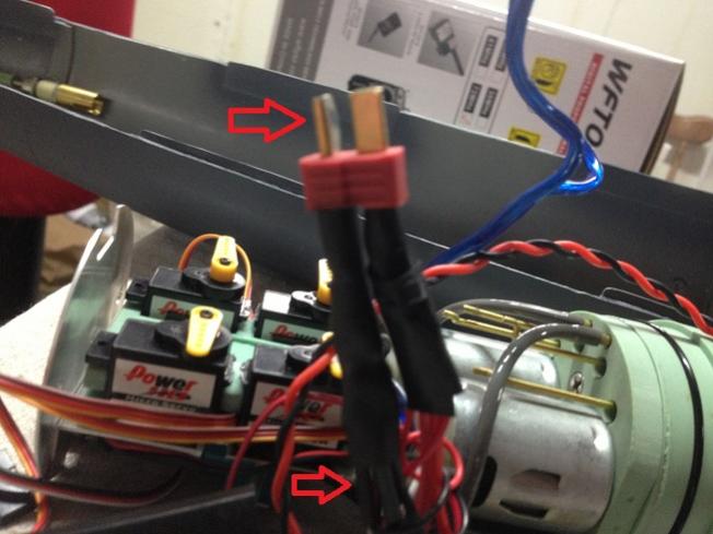

ID:	90504 Can you guys see my problem now? I'm pretture sure thaClick image for larger version
ID:	90505t i need to flip the wiring from picture number one; but I've been seeing positives and negatives too long today that i just need a fresh pair of eyes. See the arrows are pointing to the Black leads to the rest of my devices (ESC, LIPO, etc).

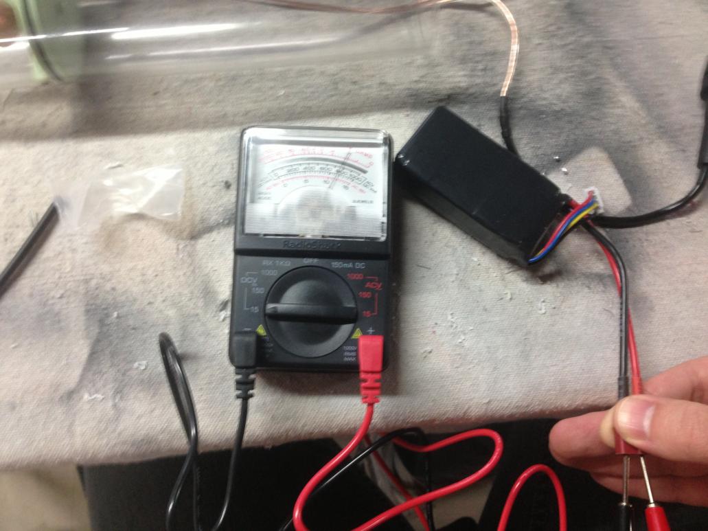

                4) Click image for larger version
ID:	90506 Volt reading directly from the battery. Red needle to red lead on battery and black needle to black lead on battery. 11.1v
                5) Click image for larger version
ID:	90507 Volt reading from the end of the wire that goes through the WTC after the switch is turned on. I have to put the red needle to what would be the BLACK connection to the rest of my sub components, and the black needle to the red connection:(
                Plausible conclusion
ID:	90508 If i'm correct that i've F'd up the polarity ... is it as simple as switch those two wires around? I'm thinking yes?
                Thanks everyone!
                  • 14013
                  #203
                  You got the male Dean's plug at the after dry space end ass-backwards. Swap the wires to the poles on the plug and you're good.

                      #205
                      As you work on it, just remember the "t" of the deans plug is positive.

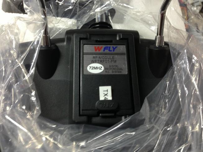

                                #210
                                Good news, I've got my male red dean connector switch on the aft side ...
                                But
                                I decided to take a look at my radio and receiver like you mentioned David and it is 72mhz on the back of the transmitter and so are the crystals:( Who do i contact from sub-driver.com to send me the right component and crystals?
                                See pic below
                                I can give you guys pics of the crystals too if needed; but as of right now i have a 72mhz trx/rx not a 75mhz.
