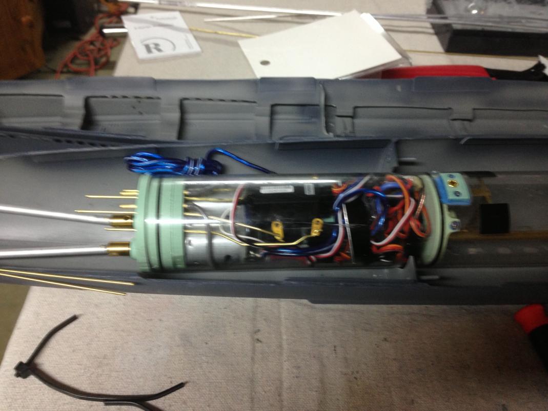

                #232
                So, little update (ill try to share pictures tomorrow). I had to trim down my servo horns so that they would fit in the wtc. I actually have the wtc together with all the wires scrunched together (makes me nervous that the are so squished). One thing i noticed was the wires are so squished that bottom part of the resin end doesn't quit mesh flat with the cylinder. Granted the rubber ring is well inside the cylinder. Will this be a problem or do i need to keep working it until it meshes evenly?
                Granted, i say all this knowing well that if David and Mike send me a 75mhz component ill have to pull that thing right back out anyhow. Good news is after everything is shoved in tight it all still works!

                  #233
                  All squished.

                        Lol, so i have nothing to worry about with that small gap (about 1/16 ") at the bottom end of the wtc and with the wires being squished? Guess im just trying to play it safe since its going in water and this being my first sub
                        thanks everyone,
                          #237
                          If you are worried (and I get that - it is all new) why not try to bundle some of the wires with zip ties? It is crowded in the Gato sub-driver, but I think you can regain that little bit back.

                            I am alarmed to see the aluminum device bulkhead bent like it is -- that means your servo pushrods are now shifted in their seals from how you set them when the motor bulkhead and equipment tray and bulkhead were outside the cylinder and unstressed.
                            Take that receiver out of its case and put it in heat-shrink, that will keep the receiver from hitting the top of the cylinder, which is likely a contributing factor as to the aluminum bulkhead displacement.
                            Fix it so things don't flex out of shape when you cram the motor-bulkhead into the cylinder.
                            And, once everything is re-arranged and fitting without binding, do your leak check. That will tell the tale.
