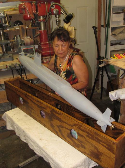

          Sexy sub! Handy size!
            • 14012
            #2885
            The ALFA? Yes, if you augment the rudder to tighten up the turn. Here's mine at Rocky Mount, NC about ten years ago.

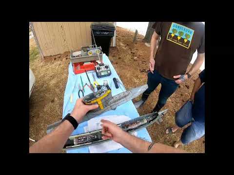

                  went blank at 2:20
                    • 14012
                    #2889
                    Originally posted by Ken_NJ
                    went blank at 2:20
                    Nuts!........
