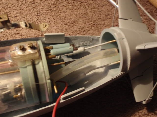

    I sneaked into the shop and quickly shot some pictures before the wife realised i was there, yeah still faster than my shadow.
    First picture to show the servo's will fit inside, i just stuffed the cables inside, still have to change that.
    Added the watertight switch and placed the ADF on top of the battery, next was to see if the tubes will fit.
    Shoving the SD back untill i've got me just enough room, if i cut the tube just before the lockingball like David suggested i'm saved.
    The dryfitt of both tubes revealed a problem, the switch won't allow me to join both tubes together, so i have to remove it, there is still a provision at the rear endcap with a unused rod, want to place a other type of switch controlled by that rod, to create more room in the front i'll also place the chargingpoint at the rearpart.
    I have to adjust all rear rods, and the shorten the propellorshaft to make this fit, all in all i shoved the SD 1,5 cm backwards, you can also see the L bended rod which now is not in use, that's the one i want to use for the switch.
    It will take some days to make all the changes, most work will be the extra wiring for controlling the front servo's and connecting them, if i'm lucky i only have to add one wire, want to do a little cheating trick to make it work.
    Greetings Manfred.

          My intension is to run each servo on a separate channel, how?, i'll try to explain, i've got me one cable (3 wires) unused from the ADF, it's the input failsave connection cable, if you take that cable and add one wire more it's possible to steer them independed.
          You can use the positive and negative together to both servo's, that's 2 wires, add both puls wires for both channels to the sum and you've got 4, so i only need to get me one more wire through the copper connection tube, it will be tricky but can be done.
          Motivate me with it can't be done gives me a extra drive, i wish it was possible with all the things in live, but you've got to know your limitations, on the other hand if it can be done i'll take a shot at it, it gives you a unique experience if you succeed.

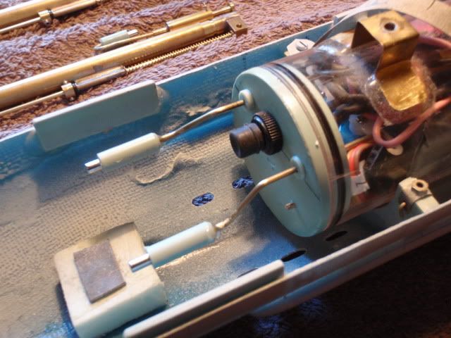

              First i rewired the SD, connected the servo's, ripped out the SAS, and replaced it by snort, i did a test with the safetyfloat valve inside the ballasttank, but the result was poor, couldn't get her up to the waterline, if i added more foam she wouldn't sink, all due to the added weight of the launchers, so i made the sacrifice to remove the SAS.
              Replaced some connectionpoints on the SD, made a new inlet for the blower, replaced the connection for my safetybouy, and replaced the on/off switch and chargingplug, pictures.
              Rewired the servo's, as you can see i only need 4 wires to get them running, i like the idea of running them seperate.
              Replaced the switch and chargingplug to the rearpart and placed them on the frame, by using the spare rod i can turn the boat on/off simple by removing the safetybouy hatch, this way you don't have to unscrew the model each time.
              Replaced the front brackett for fastening the front upperpart, as you can see i allready removed the fillingtubes at the back of the breechblocks, have to replace them to the outboard sides, a job for this week.
              Used some spare parts from the Kilo SD for making this, placed the inlet more to the front, and made a new entry into the ballasttank.
              Replaced the connectionpoint for the safetybouy and modified all rods including the propulsionshaft.

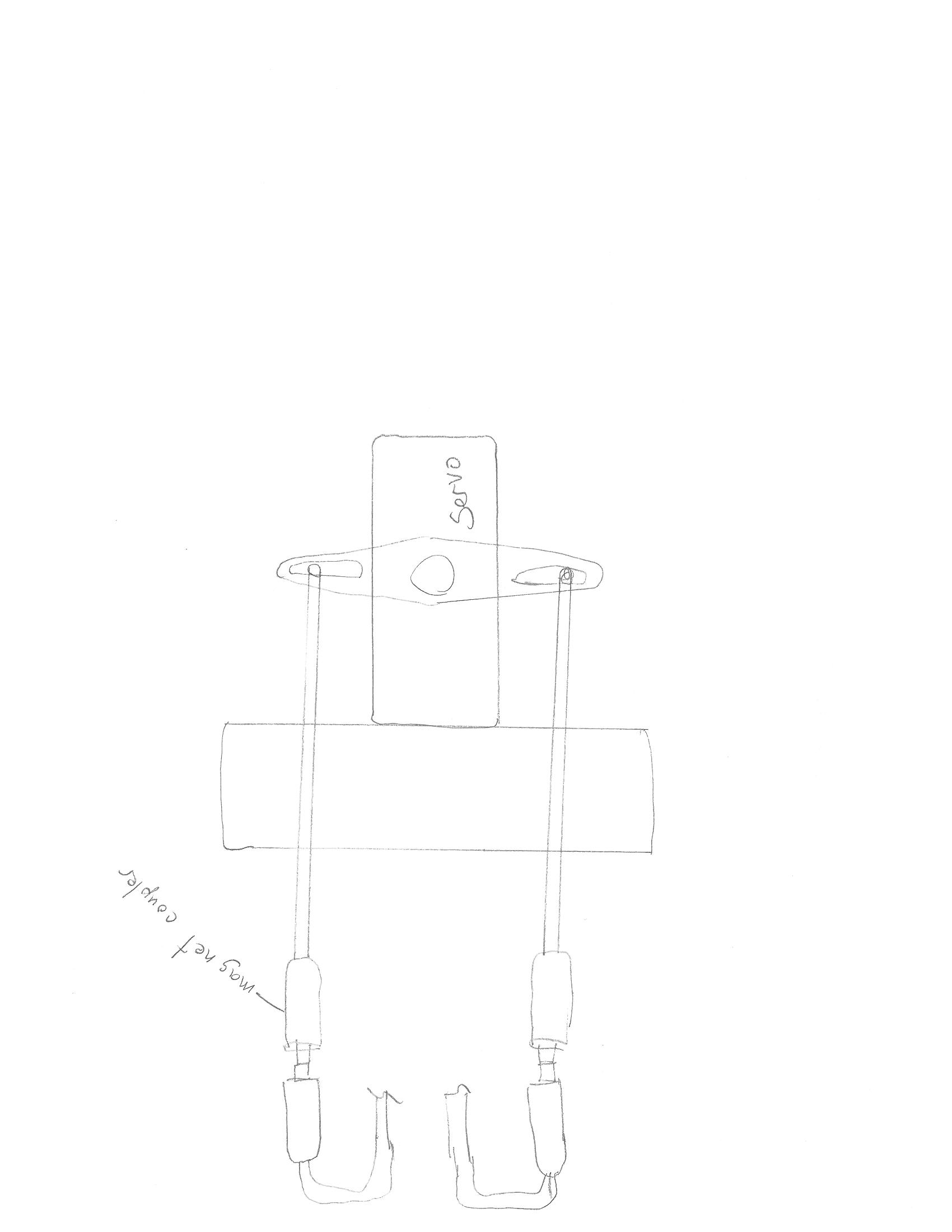

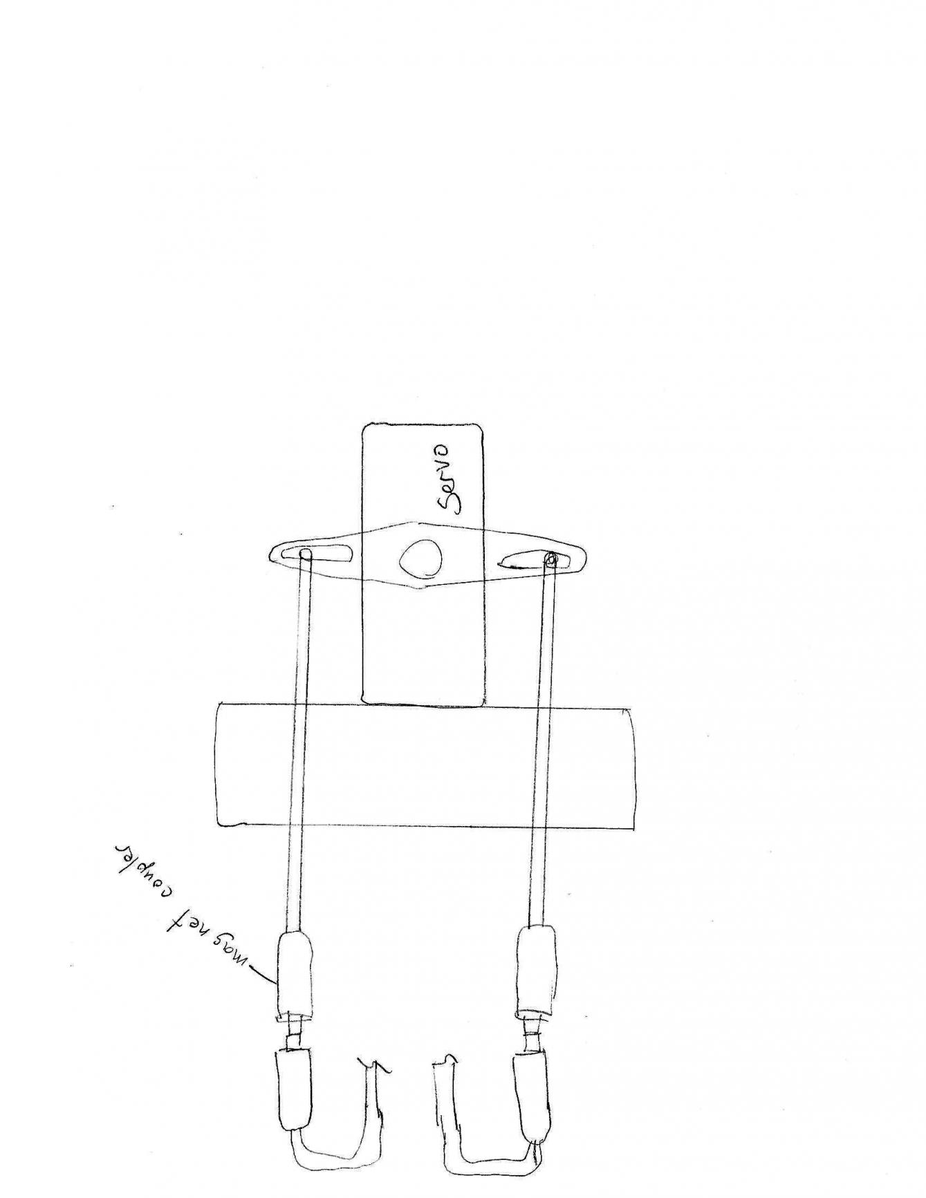

                Great stuff.
                Attached a sketch that might allow you to remove one servo to operate both
                torpedos. It might save a little weight and if you turned the servo sideways
                (not like the sketch) give more room up front. It depends which direction
                the pushrods and connectors need to move to activate the firing of the
                torpedos. One direction pushes the bar toward the endcap and releases the
                magnet coupler on the other side.

                  Thanks Scott,
                  If the weight issue stays a problem the provided drawing by you is the next step, due to the use of the magnetic couplers the direction doesn't matter, if one will push the other will get itself free.

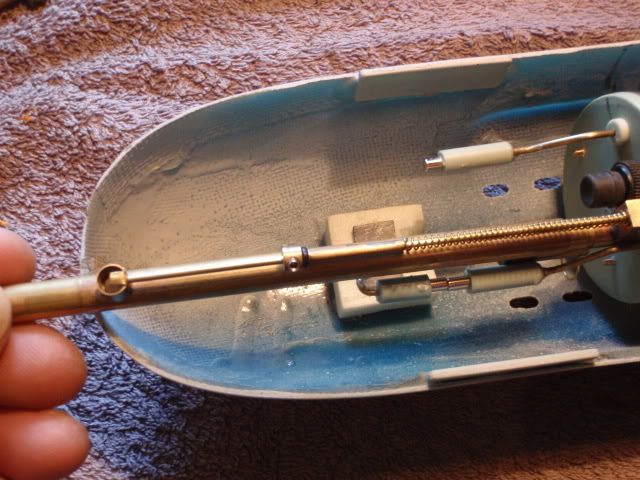

                          Clipped the claws of the 212 just before the lockingballs, it's a tight fit.
                          Replaced the fillingtubes to the outside of the breechblocks and plugged the old connection with solder.
                          Despite the torps are scale 1:72, it's looking good, now i've got to get me some gas to blow them out.
