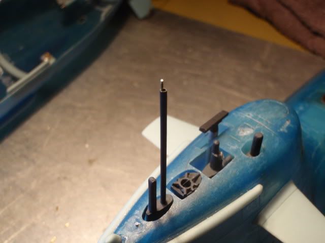

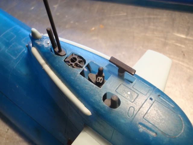

    Well, i'm fiddling around with the lead and the foam, and decided to finish up the peroscope part, i've seen some details on the real live pictures so i took a shot at it, see for yourself.
    I found out on some pics there is a kind of structure on top of the snorkeldevice, carefully hollowed it out, and made that item in copper, i even could reproduce the seperation inside the tube, tricky but possible.
    Used some thin aluminum tube rings and squeezed them into oval shapes, just to reproduce the lenses that are located at the peroscope.
    The front radio mast i've replaced by a thin copper tube, why?, well to be frankly, i've broken the earlier example due to being not carefull, glueing it back would leave a weak spot, so i took it off and made the copper example.
    Other advantage is, i've placed a antenna inside, which you can extend or retract by hand.

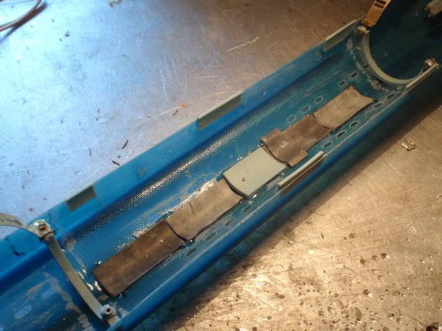

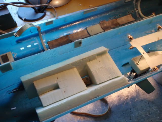

                #172

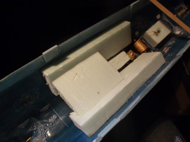

                Added some lead to the keel, and placed some more foam into the upperpart, it seems that the rocking is almost gone, this evening i want to shoot some primer on the hull, she will at least look better at the coming sub meeting.
                First i added the lead, used the thin type which i could form to the hull without obstructing the SD, at this point she was exactly on the waterline with the present foam.
                I needed to add some extra blocks of foam in the front and made the slit in front because the tube of the safetyvalve needed some room.
                Rearpart same story, compared to the front i needed some more.

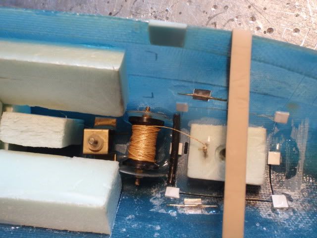

                This is the winch i made, length of the line about 6 meters, the material is a strange kind of plastick that will float by itself, only CA glue can be used all others won't stick.

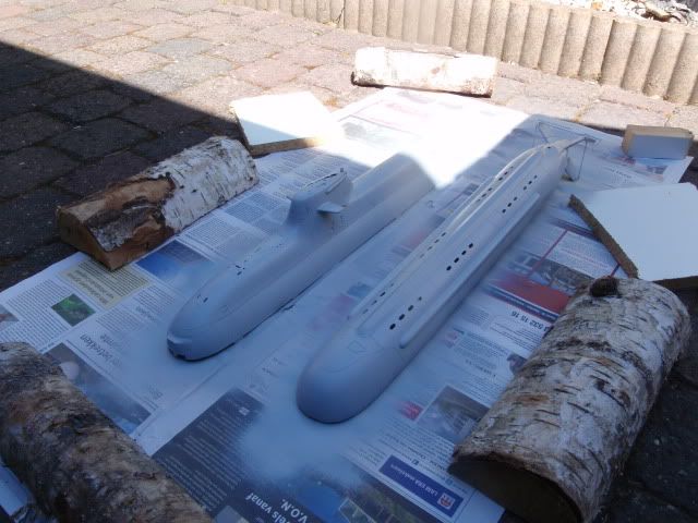

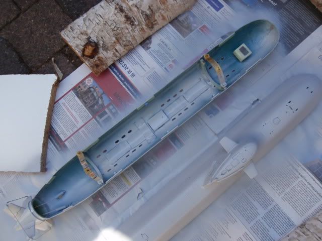

                  #173

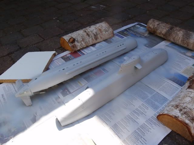

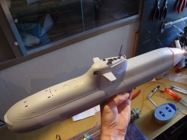

                  Yesterday i've shot some primer on the hull, i'm amazed how many details there are on the hull, wasn't possible to see them all without some paint.
                  Did the paintjob late in the afternoon because of the tempartures, bloody hot during the daytime over here.
                  To give some protection to the lead i also shot some primer on the inside.
                  Just to show how many details there are present on this hull, due to the grey primer they all show up, a nice surprice.
                  Greetings Manfred.

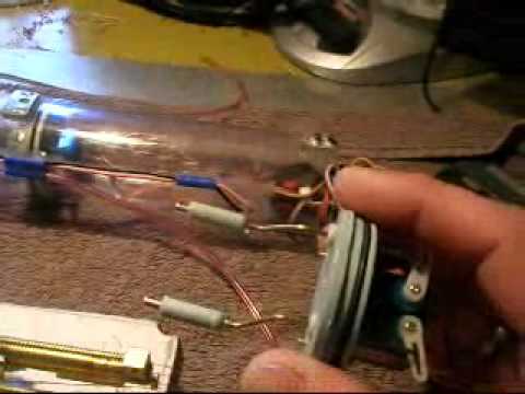

                      #175
                      Now the submeet is done and succesfull i can focus myself back onto the launchers, let's give this little critter some claws.
                      From a previous dryfitt i know that the two servo's needed for the launchers could be fitted just before the batteries, knowing that i started with converting the endplug of the Kilo SD for my needs, pictures.
                      First i made a brackett to keep the servo's at their place, and drilled the holes for fitting the watertight connections that David had send me.
                      For now they are just pressed in, later on i will glue them with RTV to get it watertight.
                      I placed the servo´s in such way that a switch can be placed, if not, nothing is lost so i can switch to plan B.
                      Frontview of the endcap, from this point i allready knew that i had to bent the rods into the desired shape to meet the launchers.
                      I took the liberty of duplicating the lever used to control the vent valve, when you have linear motion with such short rods it´s the best way to go, they can move freely now.
                      Took the breechblock apart, reworked it on the lathe, and soldered a rod onto the release mechanism.
                      By pushing against the rod you can release the breechblock, this was the first step for adapting it to my release mechanism.
                      By using a levermechanism and magnetic couplers i made the first attempt to get it working, the magnetic couplers work fine, the levermechanism did work activated manually, however doing the testrun using the servo´s it´s giving some frictionproblems.
                      Right now i´m changing the system to something that will work better without to much force, this kind of things happens when designing a system, next week i´ll give it a go with the plan B system.
                      Greetings Manfred.
