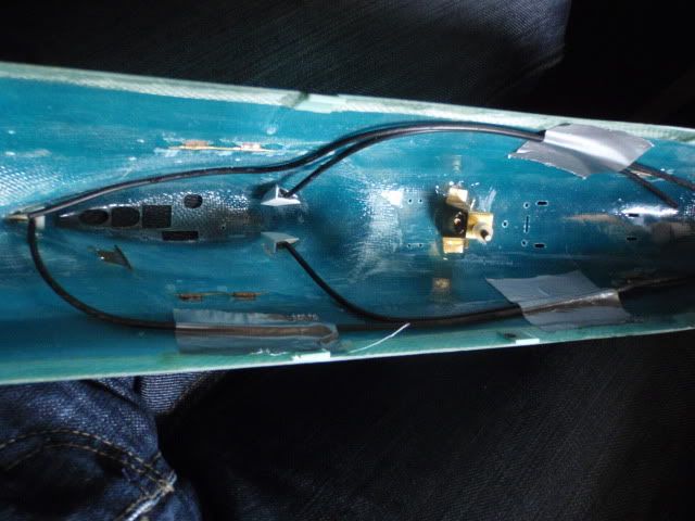

          Also played around with the rear upper light on the conningtower, decided to replace the aluminum one by a small copper tube, which allows me to insert the optic fibre.
          By making the optic fibre pointed at the end you get this as the result.
          I always do multiple things at one time, while working on the WTC i can glue the optic fibres inside the upperpart, while this part is drying i can work on other things, first stage is tacking it with CA, after that it will we secured with 2K glue.

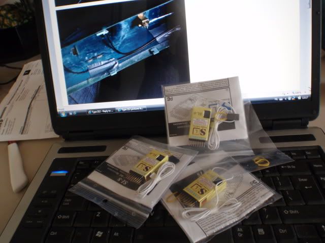

            Guess what mister postman brought today, my ordered receivers, i tried to fit it inside the tube, arrrghh, i need room and lots of it, it didn't fit the way i wanted it.
            I ordered three receivers a few weeks ago, one will be placed inside the 212, the other inside the XVIIb, and the third one for my secret project.
            The connections are original horizontal, i managed to rebuild it to vertical, this way this sturdy little receiver will fit inside the tube the way i want it.
            Greetings Manfred.

              Are those operating on legal frequencies in the Netherlands? The Sombra Labs site only advertises them in 72, 75 and 50mhz.

                  I don't have a clue, i know that they use 27 mhz, 30 mhz, 35 mhz and 40 mhz, 35 mhz is used only for airplanes and other flying stuff, using the 27,30,40 means you have to run the gauntlet, everybody is allowed on that frequency, so the chance of failure is higher, do i care about the 75 mhz?, to be honest no.
                  I only know that not many people will use it, the range of the receiver will be to small to give any problems to other users, unless your are in the direct area.
