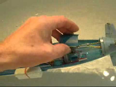

        This weekend i did some testing regarding the SAS and the liftmechanism, well, the SAS is a winner, but the liftmechanism a bummer, when attached to the SD the boat rocks over to one side, i was able to compensate it with foam, but diving the SD gives me the next problem, she won't go under with the added foam.
        This kind of testing gives you the impression how the model will act for real, in case of the liftmechanism i have to go to plan B, that by the way, was my initial thought, if only the model was slightly bigger it would work.
        Also testing proved to me me i have to tinker the float and add some more attention to the safety bouy, had forgotten to do the dry check before plunging into the bath, another lesson learnt, check all freaking things before you enter the water!!!!!!
        I let you guys enjoy my failure on the safety bouy, a bummer, and yeah, i still put it on youtube worldwide, my ego down the drain, i think i start knitting.

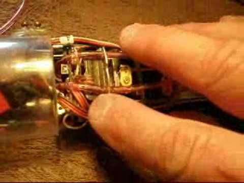

                  With my test i was eager to get her into the water to test the SAS, i knew i was going to bumb into the floatproblem, first i wanted to know if the SAS would work, because you use a much smaller SD than it's bigger bothers, so it was critical to see if the volume inside the SD would do the job.
                  As i know now, it's working, now it's time to start tinkering to get me a smooth run.

                    It's going slow with plan B, so to entertain you guys i've made a vid to show how i succeeded to stuff everything inside the SD, it's cramped, but it's working.
                    greetings Manfred.

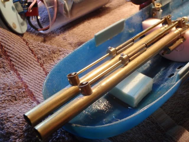

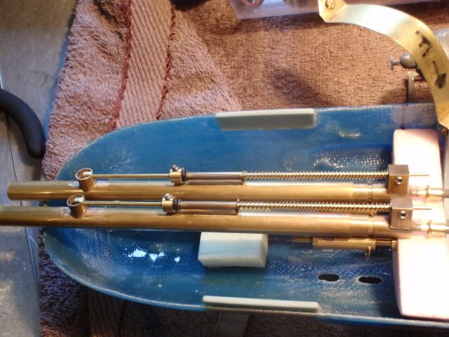

                            And today mister postman arrived, thanks for all the stuff, tried the launchers in the 212, with some adjustments it's a tight fit, don't want to mutulate your nice designed tubes.
                            As you can see it is possible to fit them in, adding the torpedohatches will be tricky, i wonder if it's worth the effort of making them, have to see about that.
                            I will re design the spare bulkhead of the kilo SD to get a idea how i have to fit everything together, if i can make this work i'll join it later with some modification on the SD to the type 212.
                            Greetings Manfred.

                              You can cut the forward end of the tubes back to the stop-bolt housings. And you can cut off the breech-block nipple, blank it off, and put a new one on the side of the breech-block -- that to give you clearance to the fowarward end of your SubDriver.
                              Oh ... COME ON!? You're not thinking of a set of practical shutter doors are you!?.............
